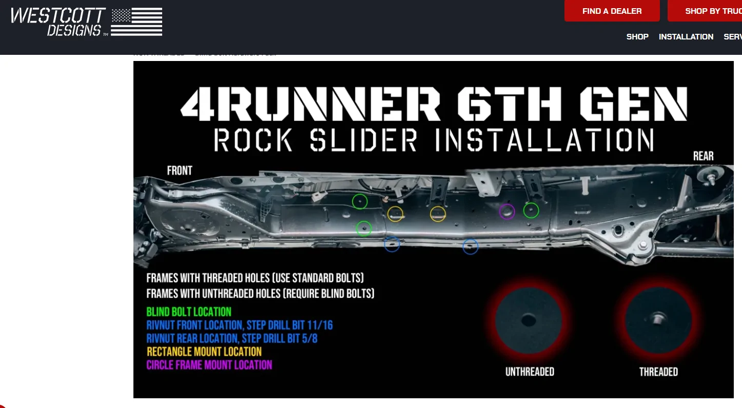

Wait sliders that mount to the same spot as the running boards? Don't the running boards mout to the body and the slider should mount to the frame. Unless you are replacing the trailhunter sliders then yes it would be same.
The running boards attach to the body, the Westcott sliders attach to the frame.
2025 2026 4runner 6th gen Running board options 1784660859299-rc
