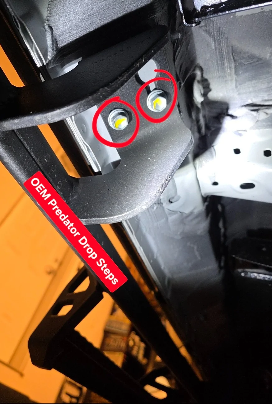

Hi, do you know if they fit direct or need to be threaded ? I don't think my Pro came with threaded mounts
Running boards do not bolt on frame like "rock sliders". They mount on the underbody. ALL trims have 6 threaded holes/per side for that due to Port Install Option like the Predator Steps, OEM board or TRD steps.
The matter of "threaded/no threads" debacle does not applies here.
See example below of 2 factory bolts under the body for my OEM Predator Steps (already removed & sold).
