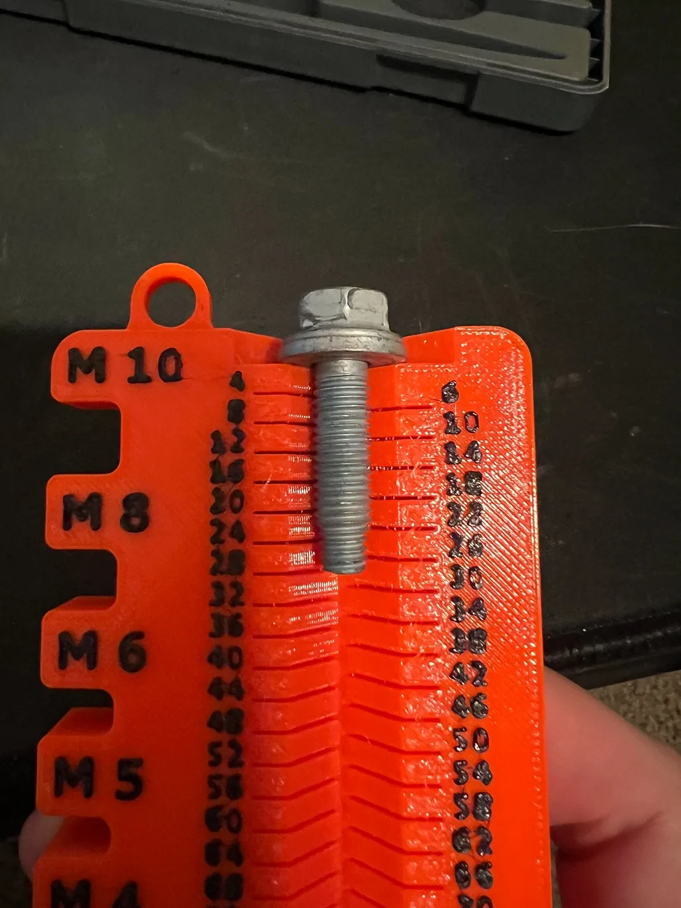

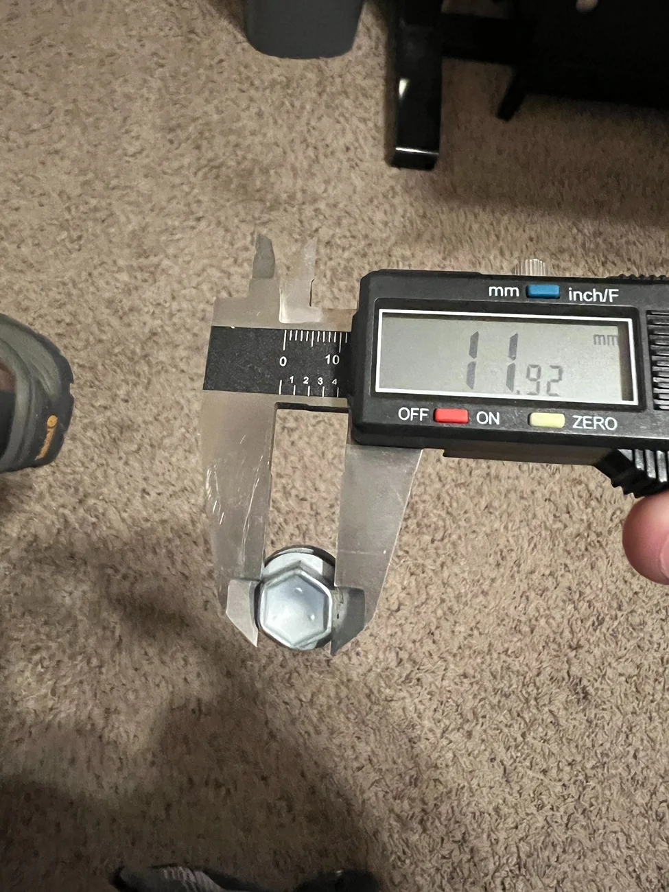

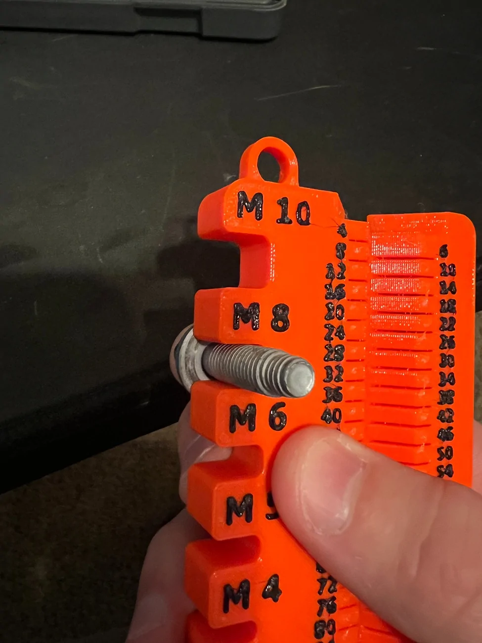

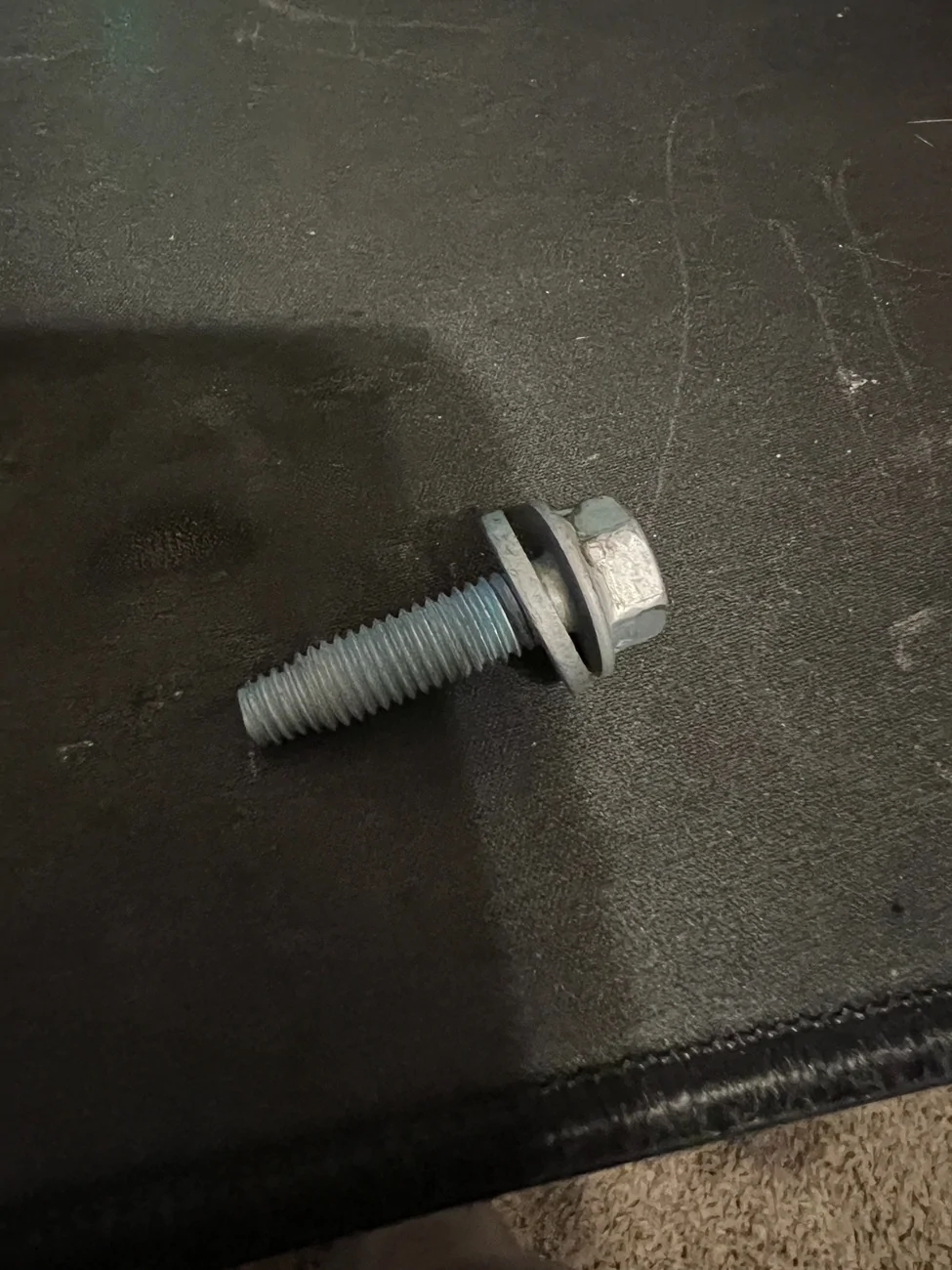

I looked at mine and took a bolt off.
There are six bolts per side, two per bracket. 12mm hex head flange bolt. There are two dots on the head and the bolt has a captive washer, with a tapered end on the bolt.
I think you need 12x M8x30mm bolts with washers.

Thanks !! This is exactly what i needed, ill get some from hardware store, I really appreciate your help!!
