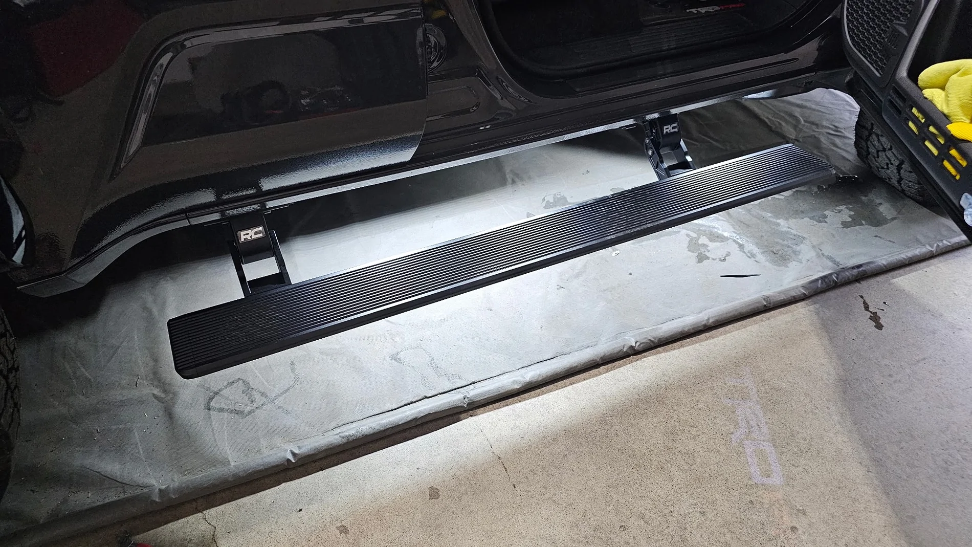

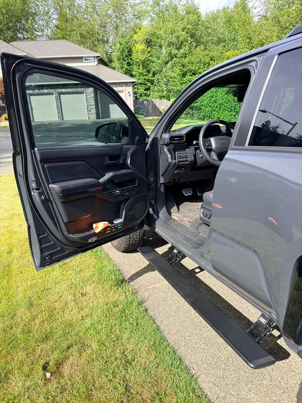

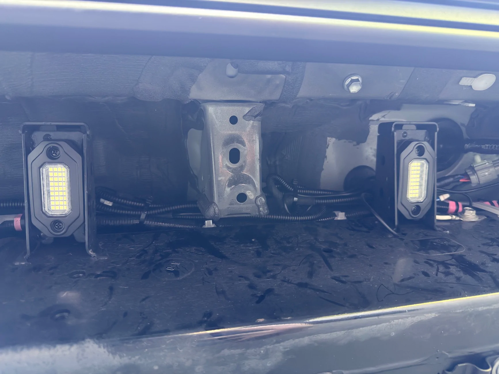

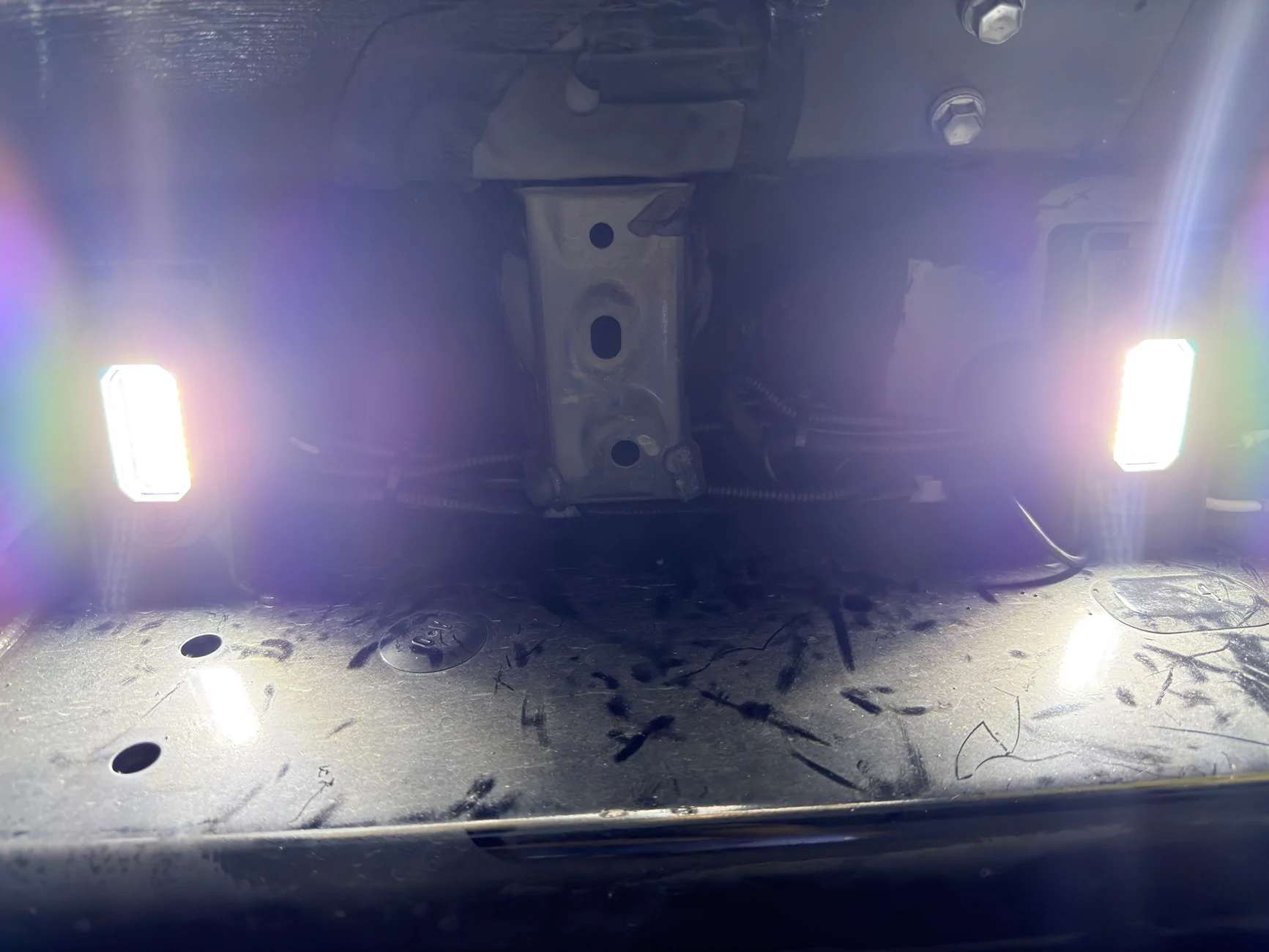

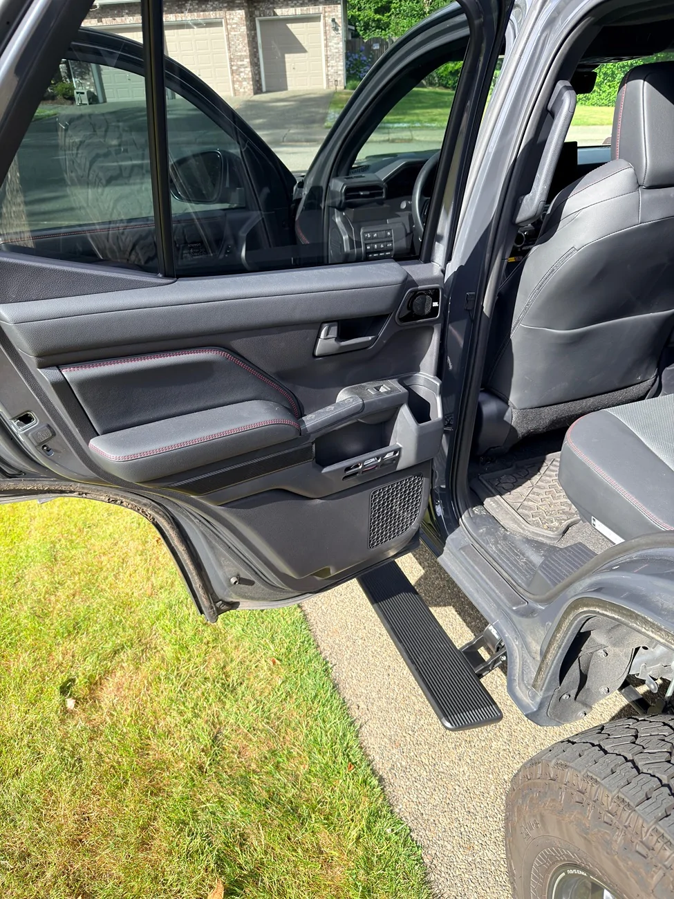

Rough country power running boards installed today. Works great! Used Amazon rock lights in place of the lights rough country provides. Way brighter, aluminum, water proof, and fits in the OEM brackets nicely.
