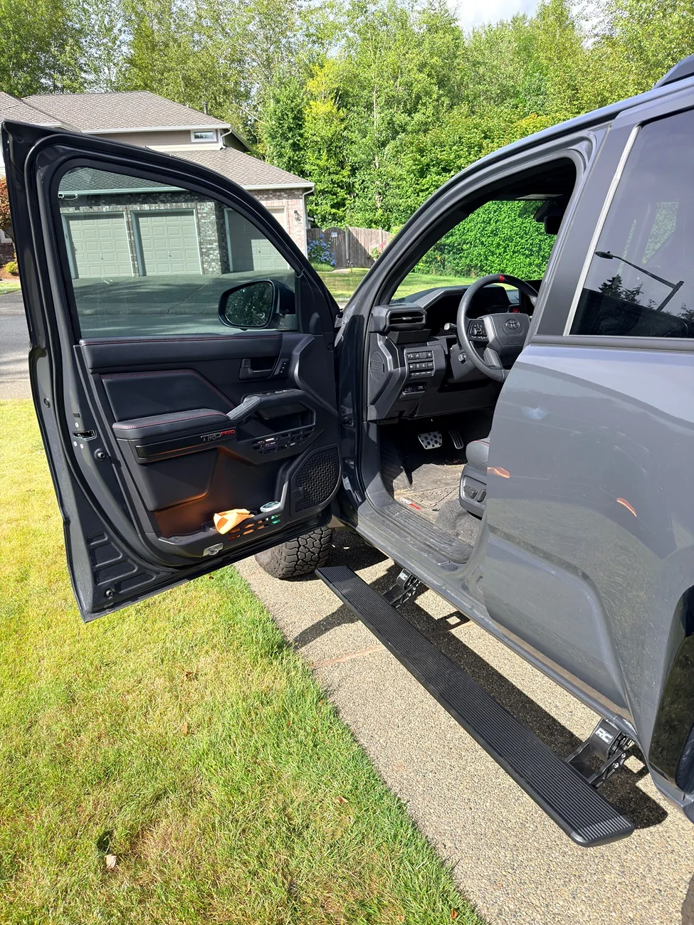

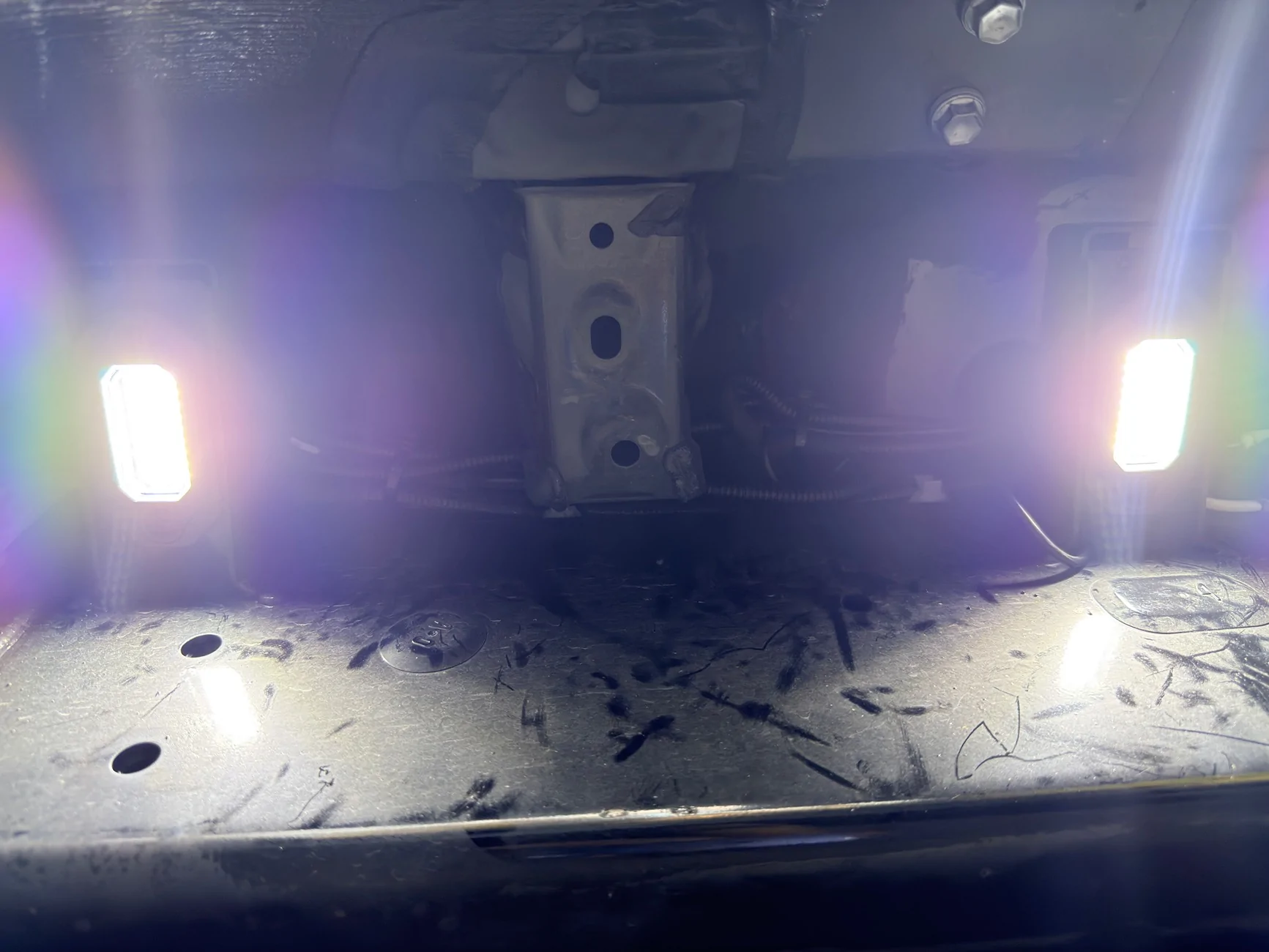

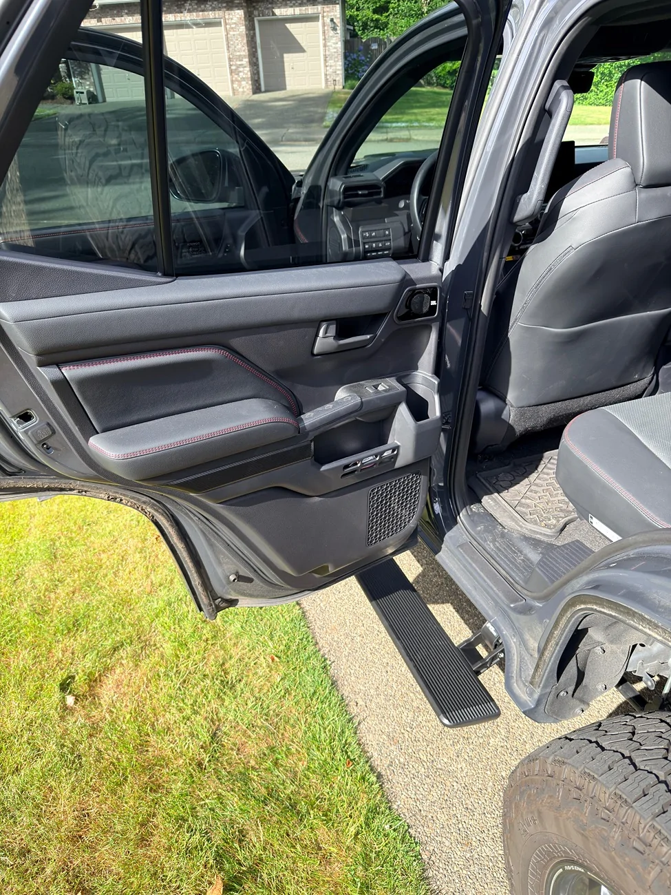

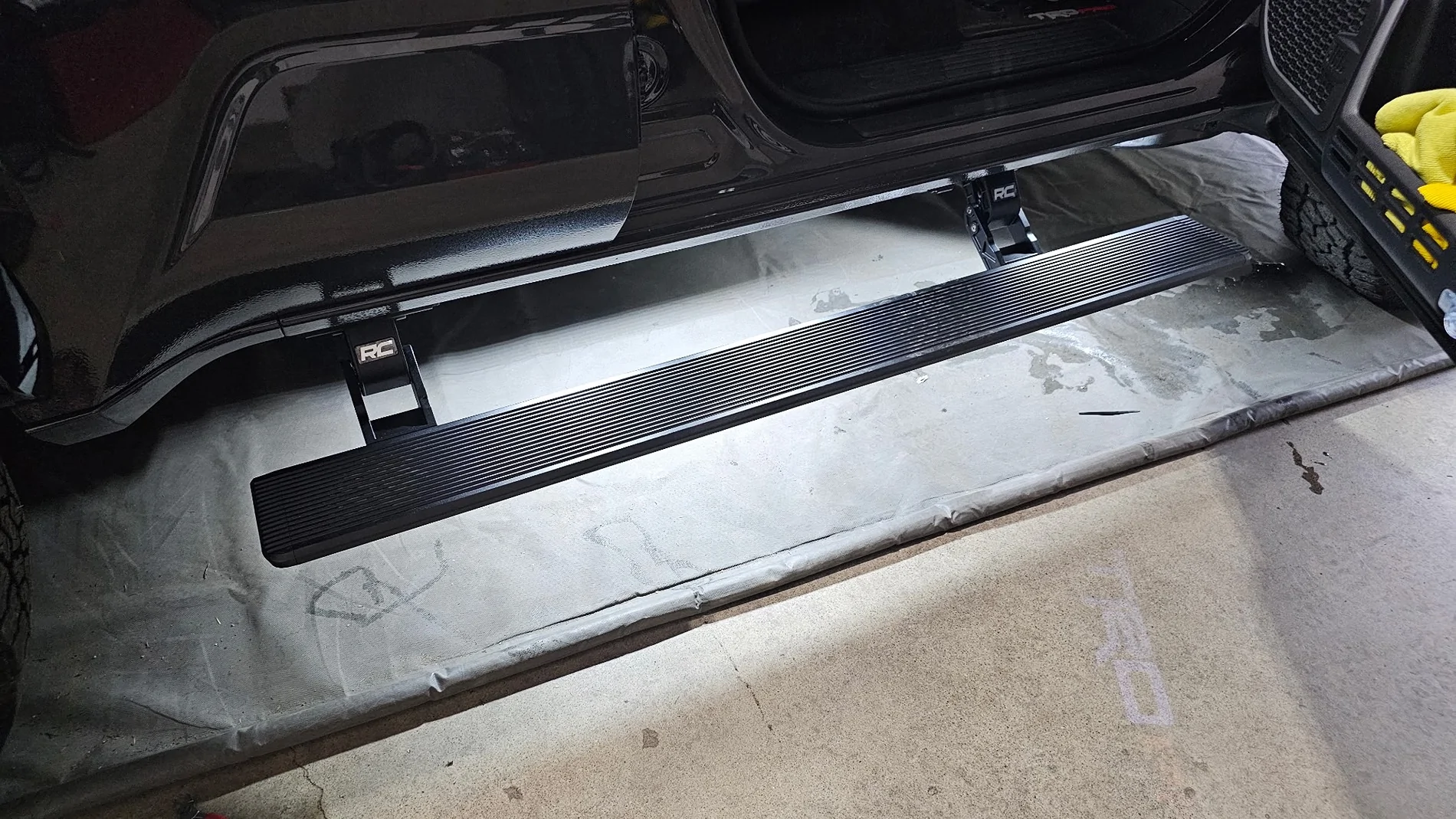

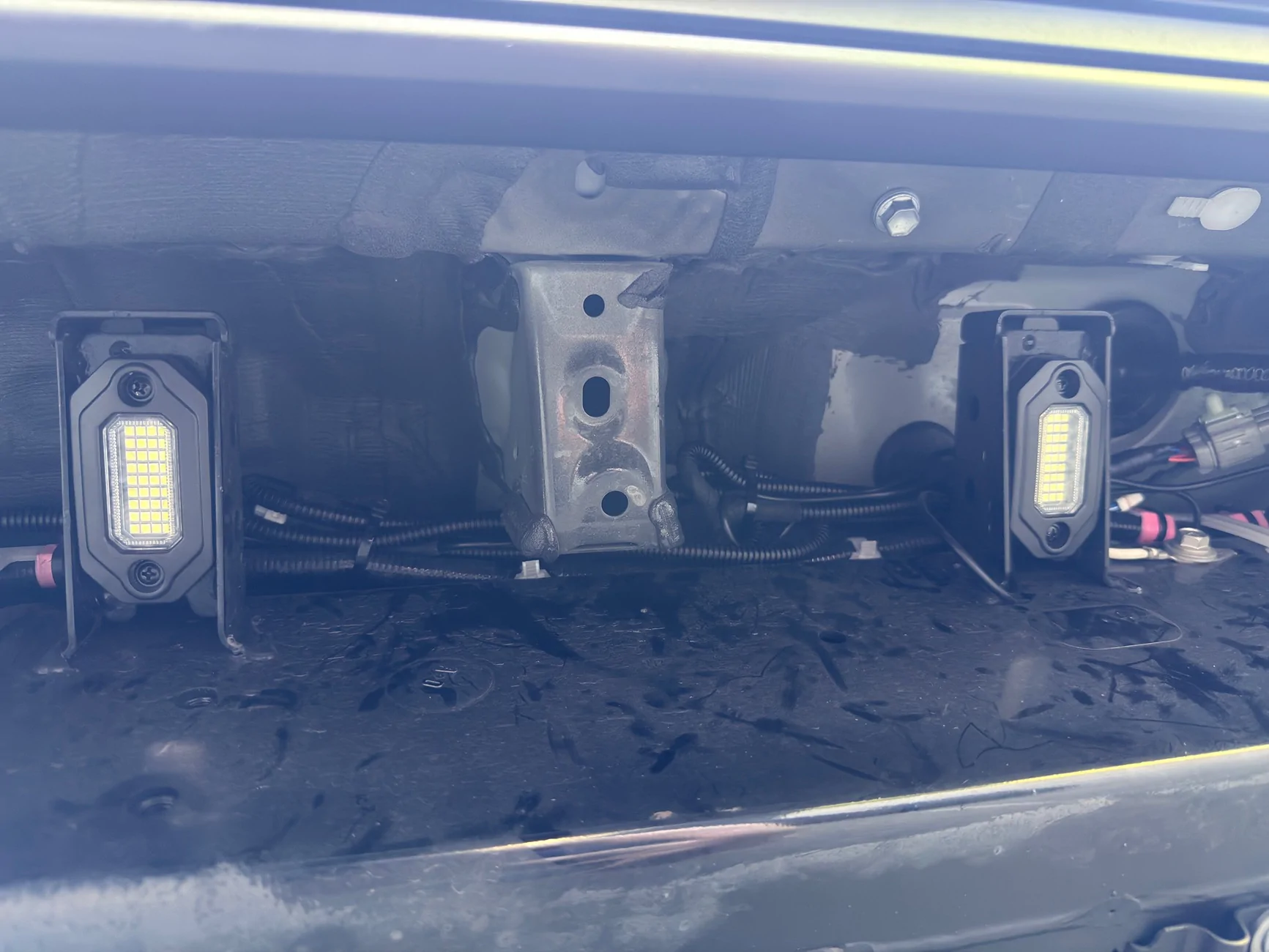

Had the rough country power running boards installed today. Works great. Installer said installation was not easy. Other applications would access the OBDII port for activation… unfortunately for our application it uses four door mounted magnet sensors to deploy and retract the boards. The last thing of note, the gap between the boards and the body is greater for the rear when compared with the front. Can probably fix this with shims at some point in the future but for now this will do. Also elected to mount some rock lights in place of the lights that come with the boards. They fit perfectly within the OEM brackets and are way brighter than the lights RC provides.
