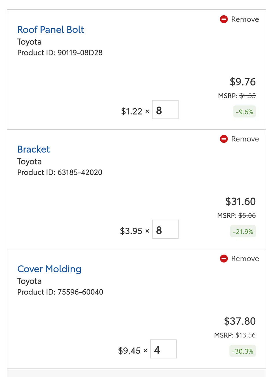

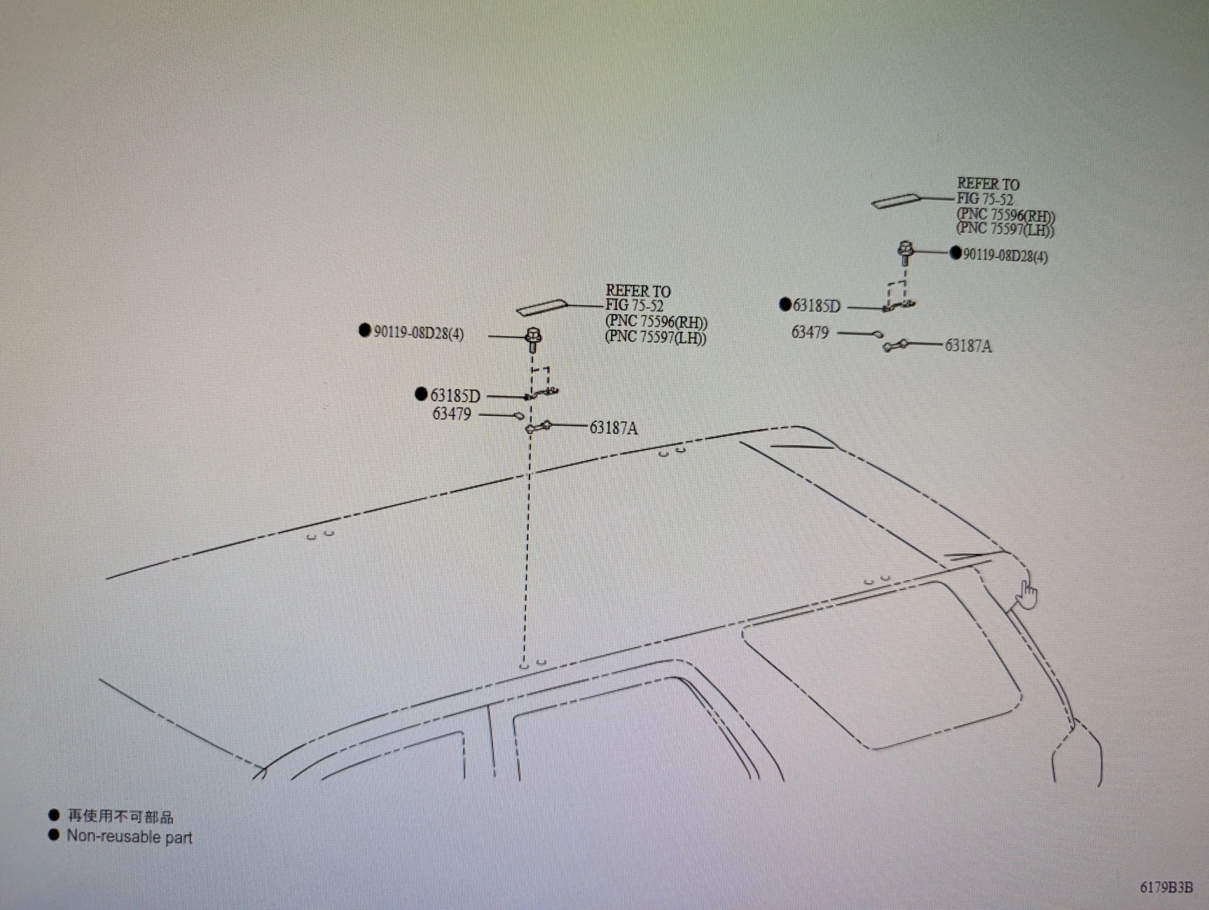

Update! Found Toyota's print this morning for the rackless Japanese models... Part numbers I ordered are correct. Looks like there are left and right covers should be different but the US market cannot get the 73397 cover. You will have to use 4 of the 75596's. I'll compile a list here soon with everything you need for the delete...
2025 4runner 6th gen Roof Rack Delete Parts? PXL_20250924_110129026

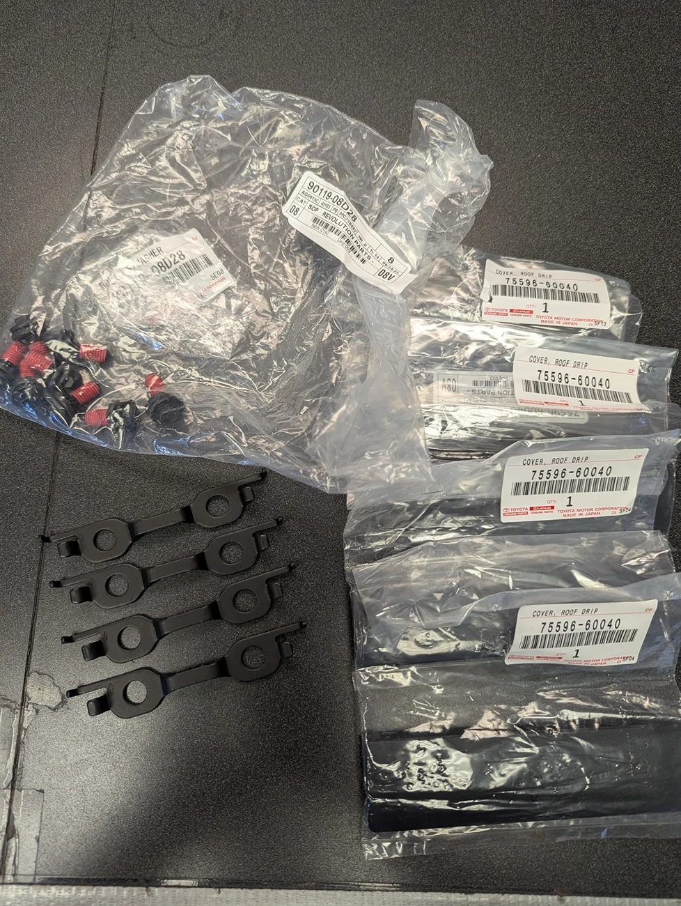

Parts arrived today, taking the 4runner in for the brake squeal issue tomorrow and a leaky TPMS sensor. Hopefully get this rack removed and the delete installed this weekend as well as a heritage grill swap!
2025 4runner 6th gen Roof Rack Delete Parts? PXL_20250926_181140628

Thanks for the parts info, can't wait for pics. Are you going to use some kind of sealant when you do your installation?
SR5CampLife
Eric
Sep 20, 2025
Elkton
2025 SR5 4Runner
Not sure yet, the brackets have a seal on the bottom of them and the bolts seem to have rubber washers and loctite already on the bolts.
