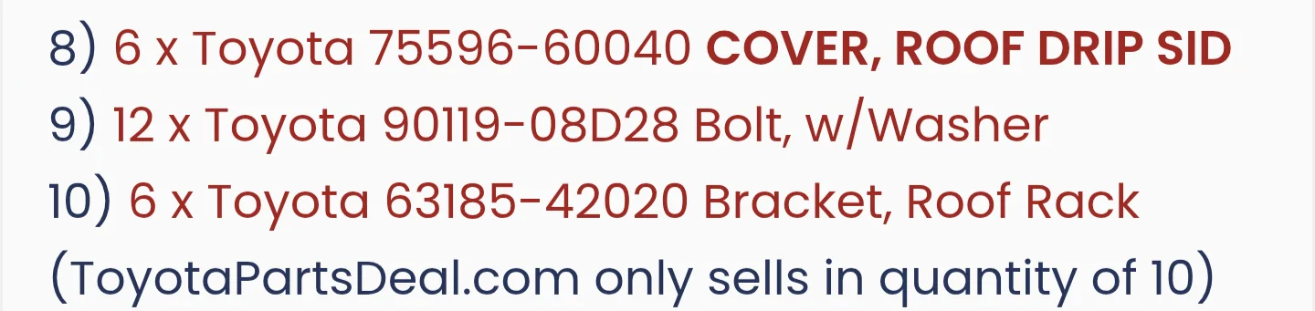

I've been compiling a list of parts. Aside from the third mount on the 2025, it seems like the parts are the same for the land cruiser. I'm going to bite the bullet and order these this week and report back...
2025 4runner 6th gen Roof Rack Delete Parts? Screenshot_20250920-144420

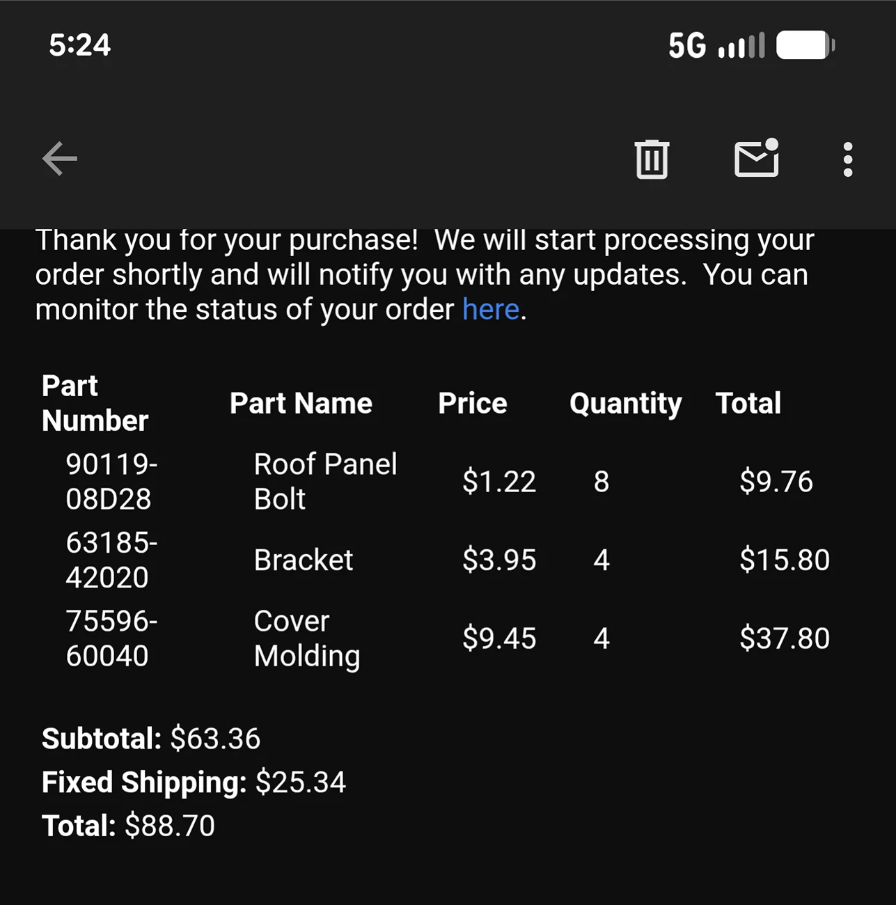

Placed the order today, should see this hopefully by the weekend. I'll post pictures after to see if it works....
2025 4runner 6th gen Roof Rack Delete Parts? Screenshot_20250923-172450
