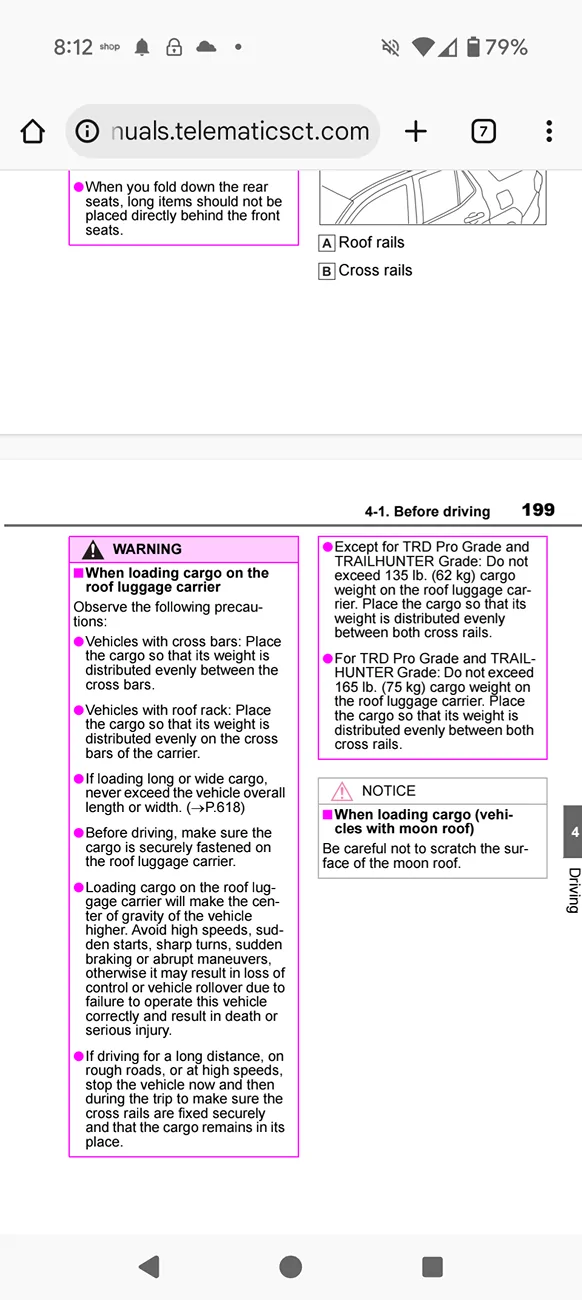

nubsors
Aug 30, 2025
My take is that's the limit on the stock rails and crossbars which are pretty weak. I have a Sherpa on my 2021 and it definitely can handle more than that. The bolts and mounting on the 4Runner are pretty stout built.
This is accurate. The owners manual for the Trailhunter clearly distinguishes between the standard roof rack and the ARB rack that comes with the Trailhunter trim.
