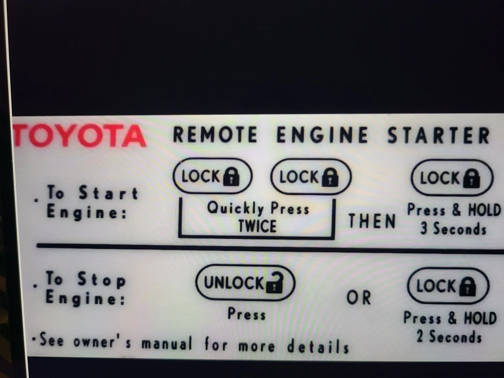

It seems to be really independent on the timing of the first two key fob presses here, definitely a little tricky to get the timing right. I also have to hold the last press for 7-10 seconds and not three seconds like the manual says.

I use the Toyota app to remote start the 4Runner. I tried using my FOB the way describe in that photo (double click lock, then hold lock) and it doesn’t work like I don’t have remote start via FOB. What am I doing wrong?

After seeing the demo on youtube I gave it a try.
Nothing five or six times standing beside the thing.
My Daughter grabbed the fob and mashed the unlock button a bunch of times then went through the sequence.
Works fine now.
I had to go through the unlock mashing one other time but in the last month or so it has behaved.
