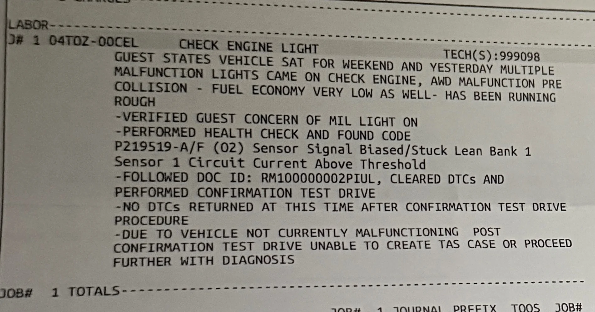

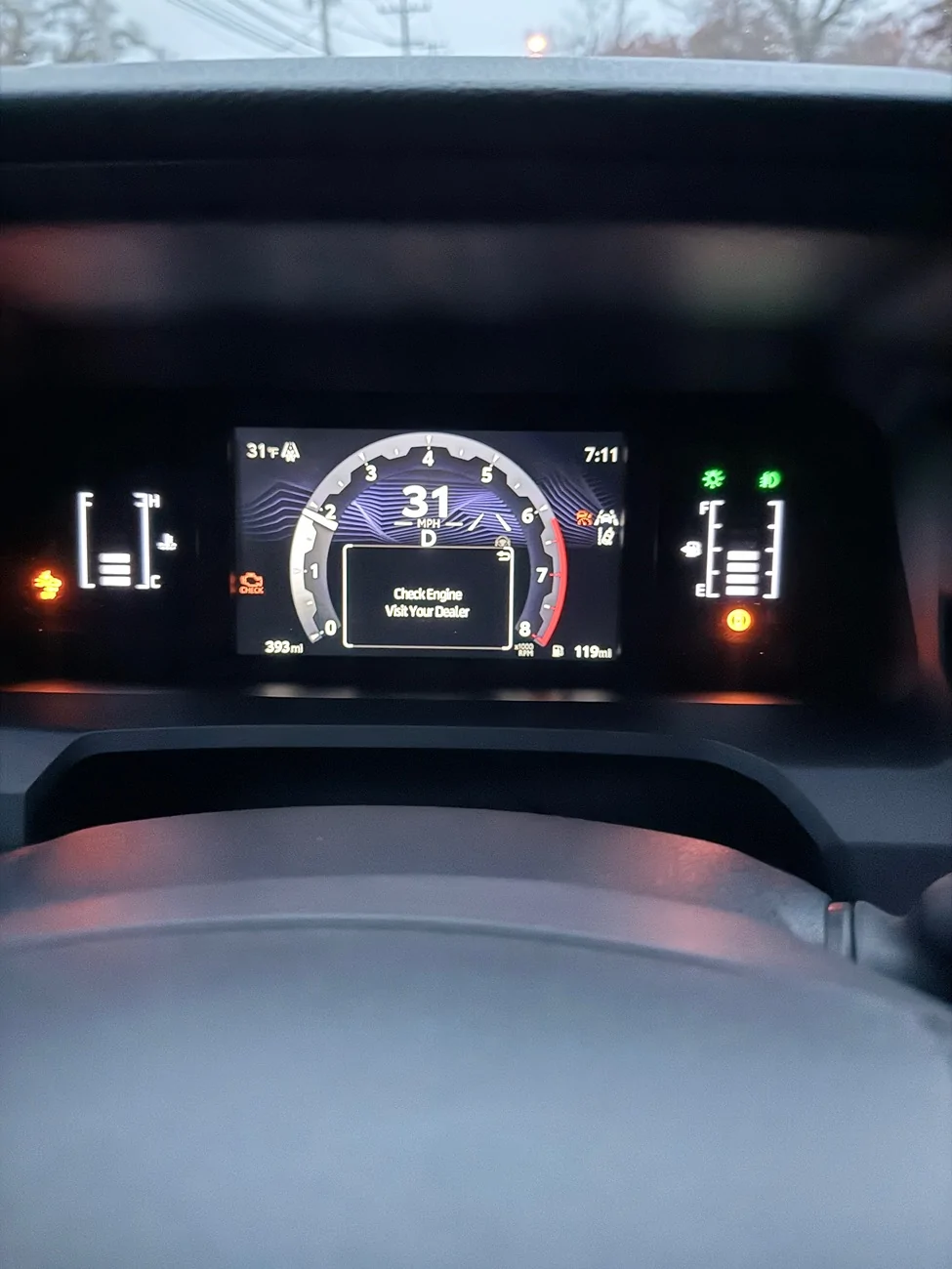

Chiming in here to say I have the same issue. 1400 miles on a 2025. Codes on a regular scanner are P2195 and P00D5. Part on backorder until at least 12/15 as of today.
Clearly a big and common issue, hopefully not the start of rough waters but I'm not convinced.

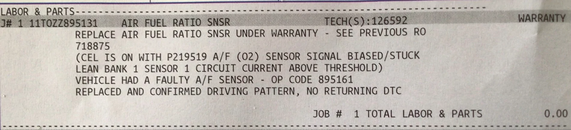

Hopefully final update:
After being called yesterday and told that arrival estimate is Dec 21st, dealer calls back today and says my part is here and ready for service. Ended up waiting about 10 days in total. Hopefully the end of this.
