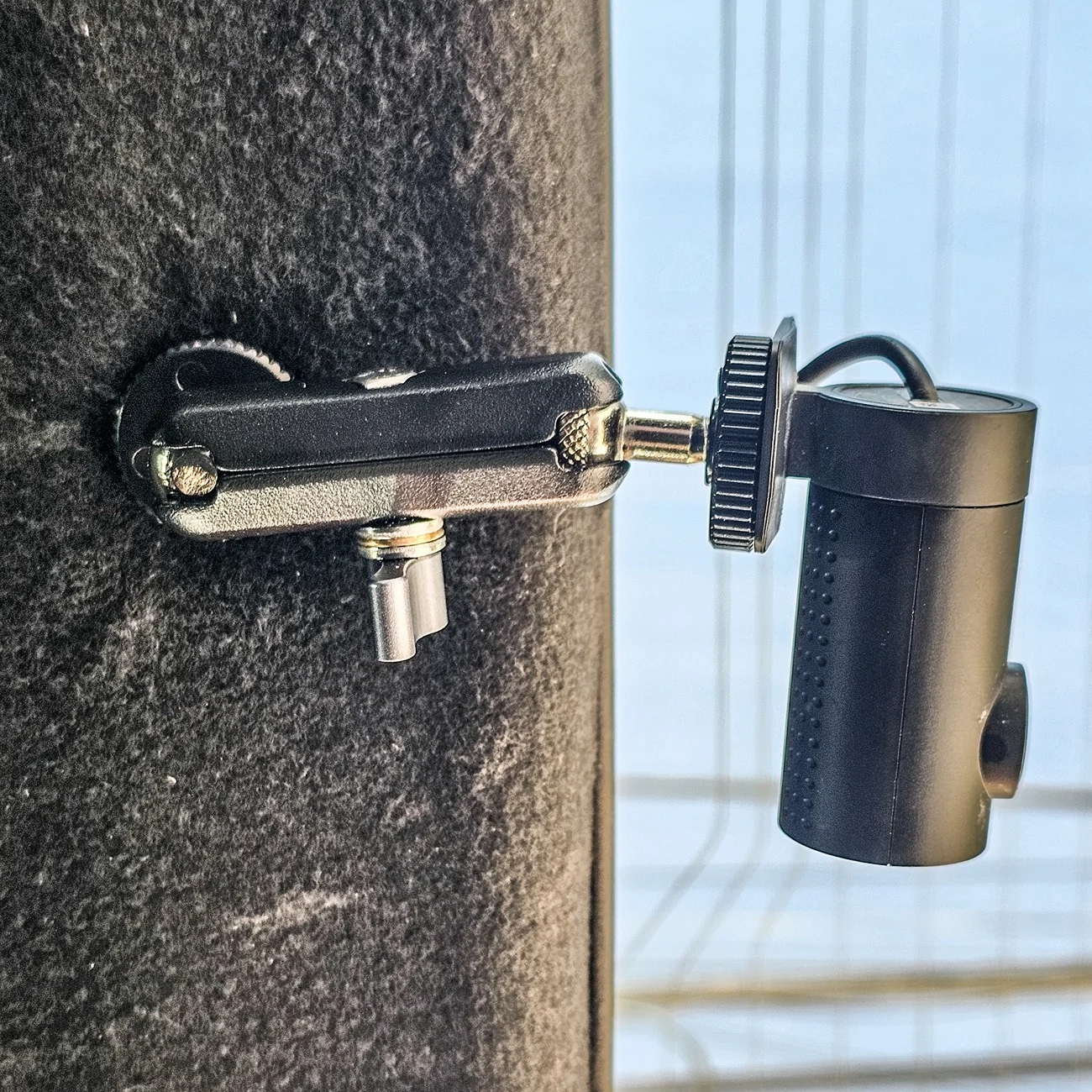

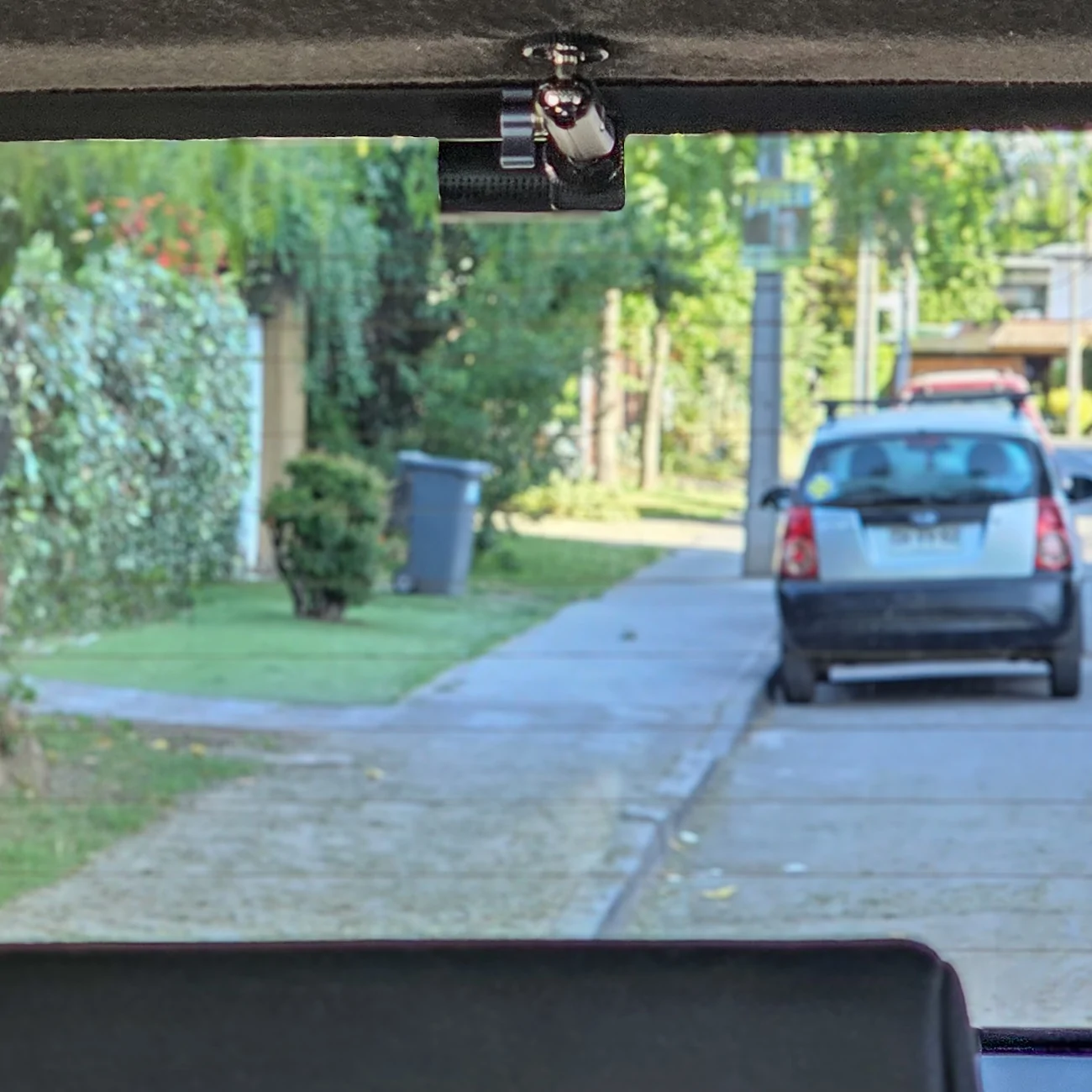

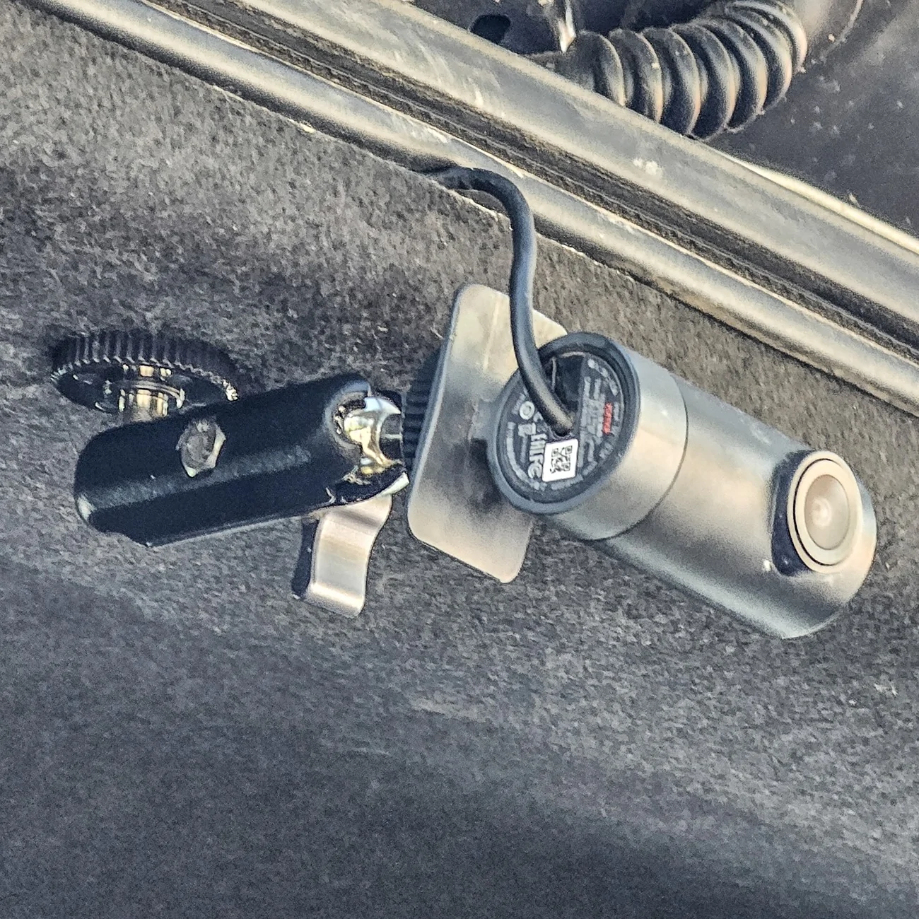

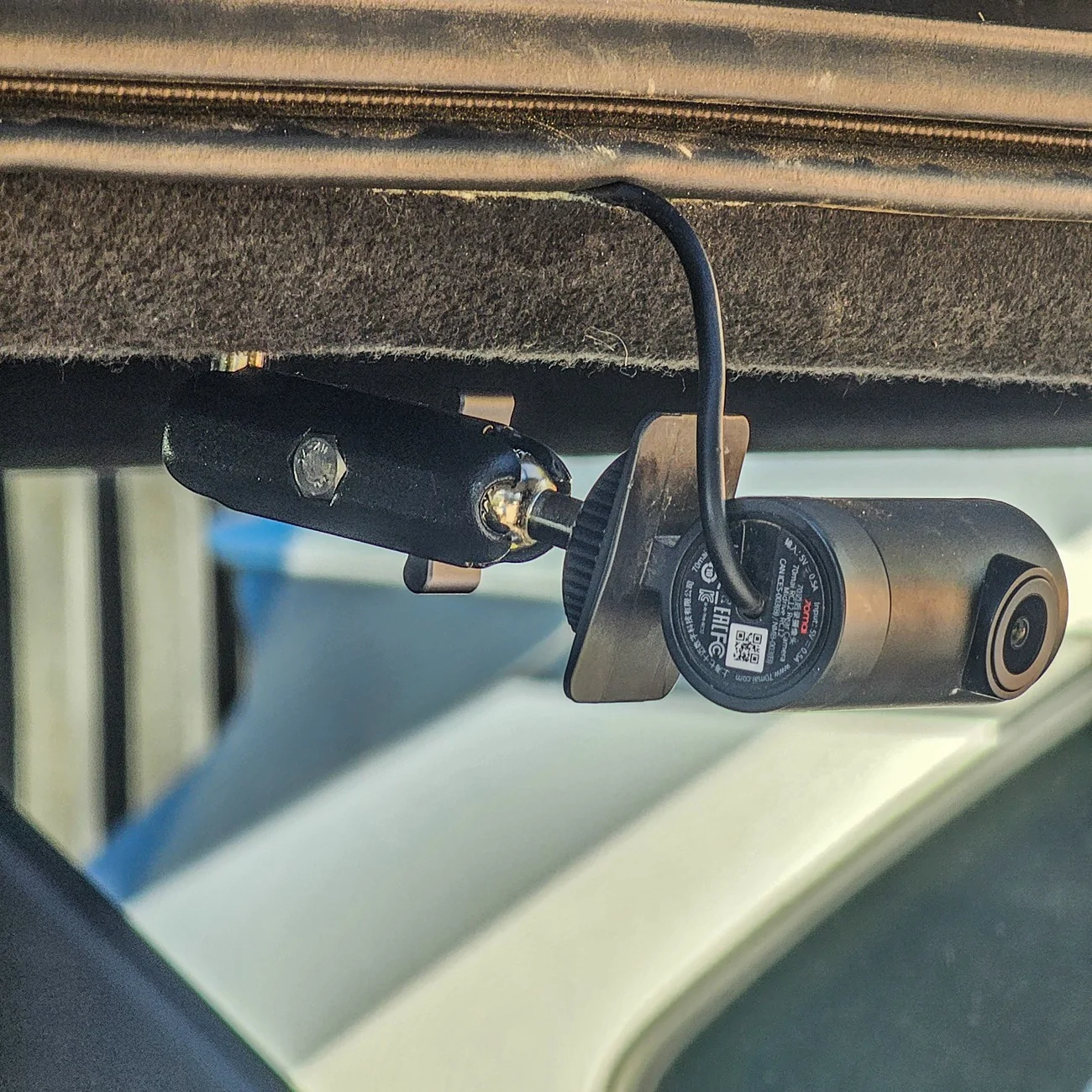

I thought I'd share my back dash cam setup. I'm using a 70mai front and back dashcam.
I'm using a dual ball arm mount that I purchased long time ago for my Insta 360.
I had to drill a small hole in the plate of the dash cam. The other end matched perfectly.
