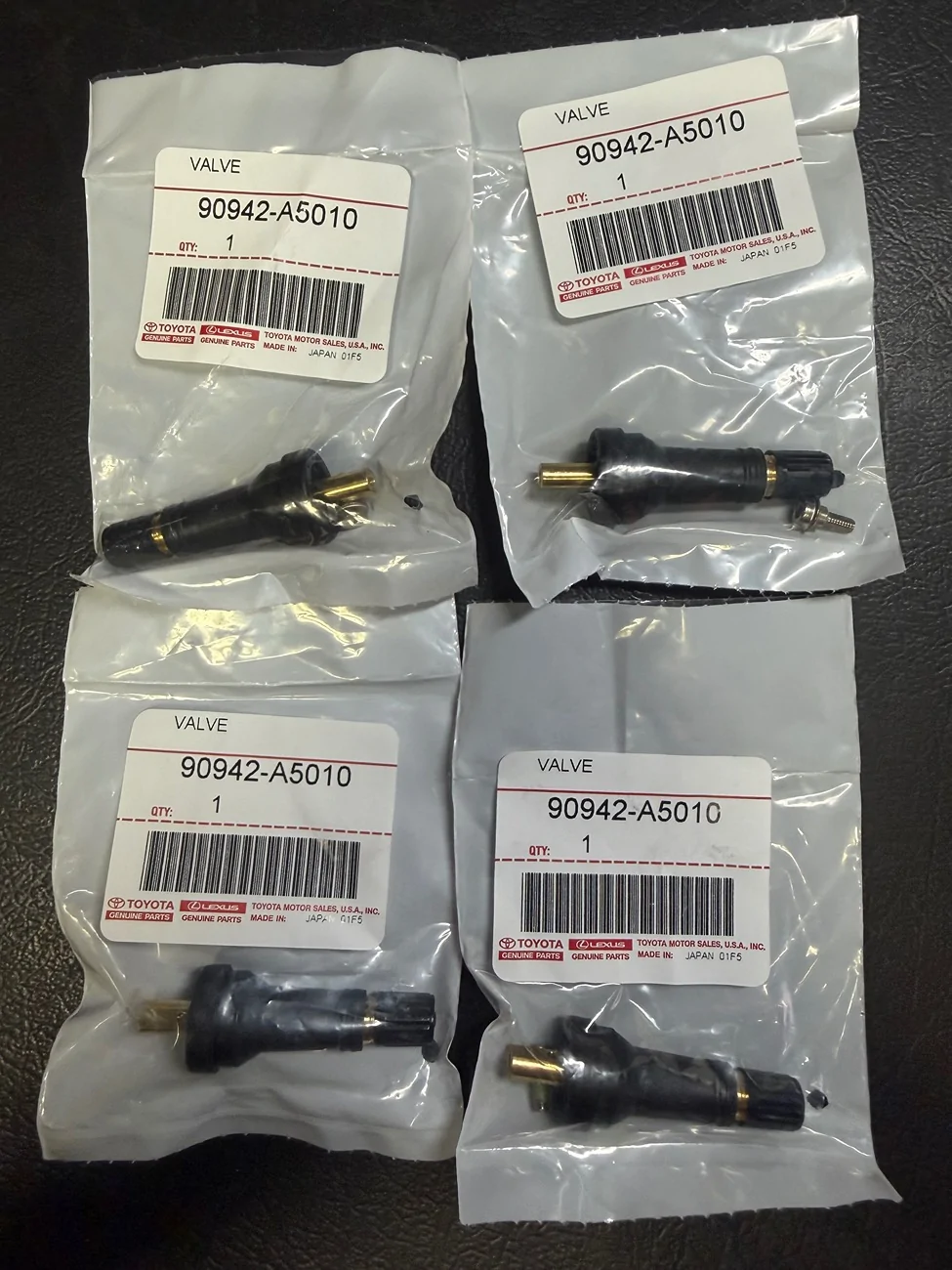

Just posting here the TRD Pro wheels part numbers and what you need to install. You would need valve stem kits and center caps since wheels do not come with them.
The Tacoma valve stems are different part numbers but are same when visually looking at them. They work and are way cheaper than the 4runner part numbers.
Center caps from various wheels can fit depending on the look that you want. Most are also cheaper than the TRD Pro ones.
PT998-89210-F2 IS TRD Pro Caps
PT998-35240-F2 is caps from TRD off road
90942-A5010 is valve stem kits. NO SENSORS.

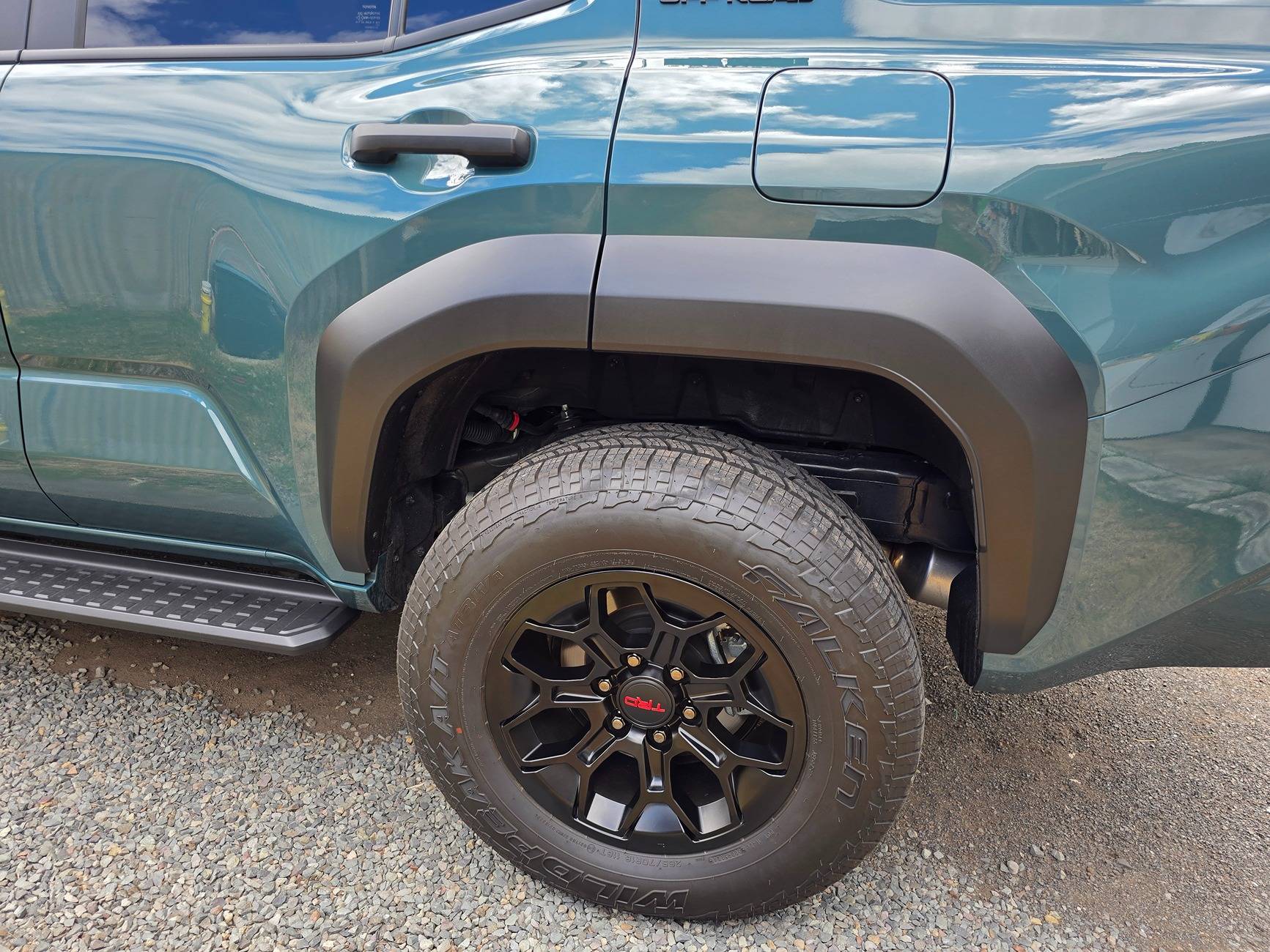

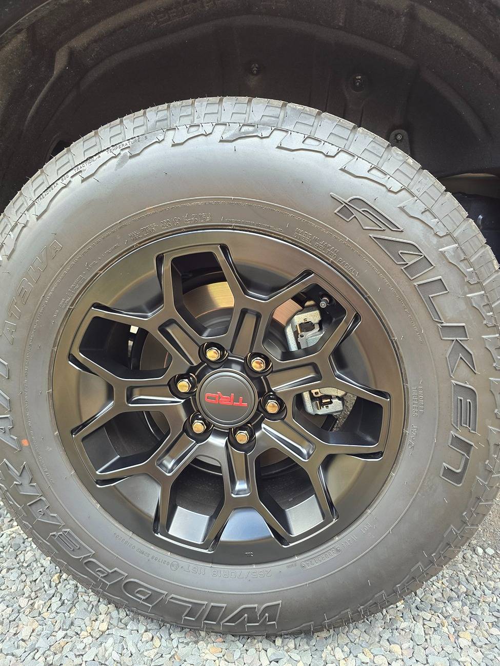

Any chance you have some pics up close of those center caps on those wheels? I want to swap out the red circle pro ones but not sure which to choose. Thanks!

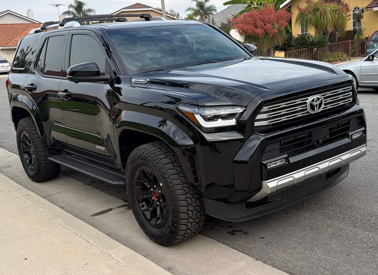

bought a set of trd pro wheels w Falken wildpeak at3's for 1800 (facebook marketplace) , took my factory Limited 20" rims for 600 so paid 1200. fit perfectly no issues or mods , same sensors same everything else
for the record I thought i was experiencing some issues w turning radius but my *** self had it at H4L. H4F works fine
2025 2026 4runner 6th gen Part numbers for TRD PRO wheels, valve stem kit, center caps. Various center caps fit depending on the look you want. Image 2025-11-20 at 6.23.42 PM

Question for those that changed to trd pro wheels. Can you reuse the tpms from your 18" wheels from Trd off-road wheels? And purchase new valve stems you linked above (without tpms).

Yes you can reuse the tpms sensors. Just need new stem kits cause once installed the stem is hard to remove without damaging it

Can y'all confirm that these are the black stems? (same ones from the thread so I assume yes) 90942-A5010
Or, has anyone ever had any luck with bootleg TPMS sensors? lol
https://www.ebay.com/itm/257302523340
Yes, that’s the correct p/n for the stem. I purchased a set when I did a wheel swap for the TRD Pro rims.
