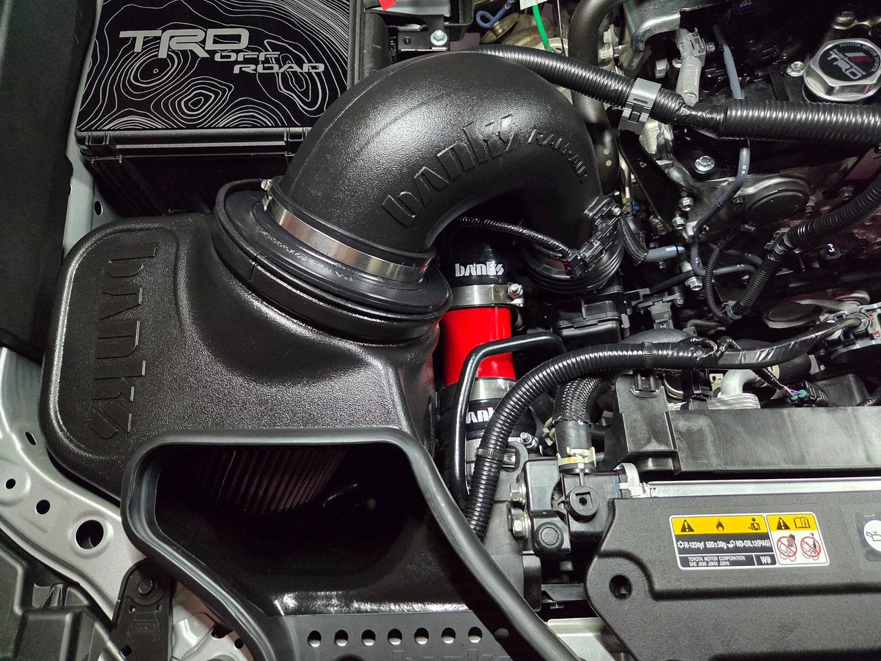

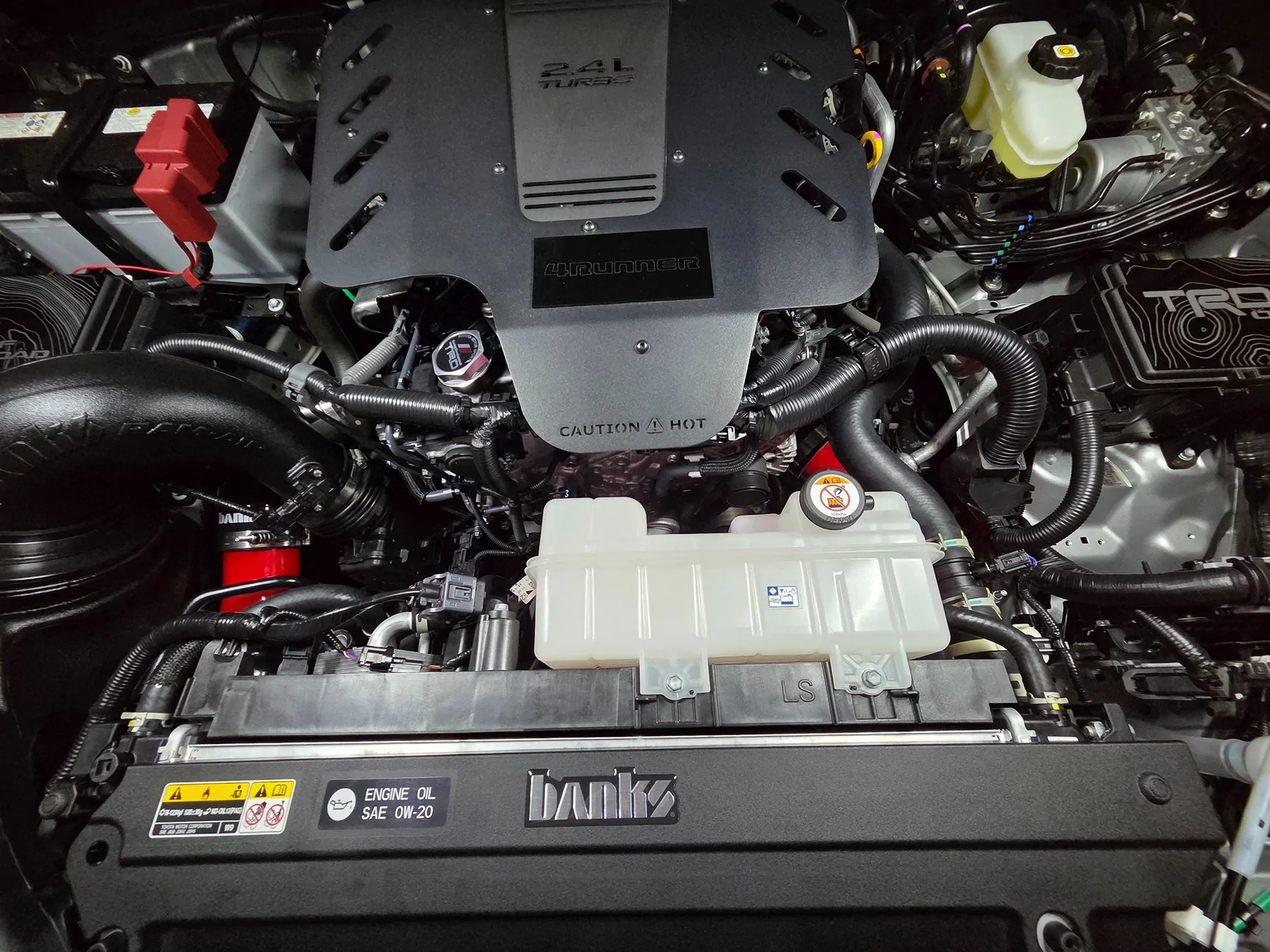

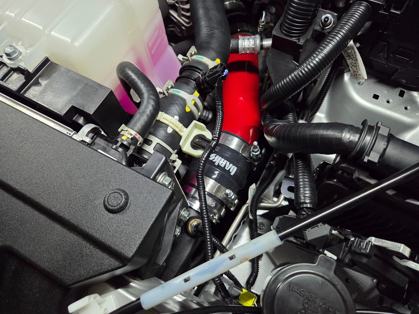

Got it from victory 4x4, I do like it compared to all the hose and wires when you initially open the hood.
I added the Victory 4X4 engine cover and recommend it over plastic covers I've been seeing. Also went with Banks Ram-Air intake and boost tubes.
I feel there are limits to how far we should go with bumping horsepower. Scrappopatamus makes valid arguments about this. The 2.4 has plenty of power stock. Going too far could reduce engine longevity and reliability. I haven't done a tune and doubt i will. My EUC seems to have learned from the substantial airflow increase and adjusted fuel trim. I use a Carista ODB scanner to monitor and all looks good no faults or warnings. The Banks setup definitely improved throttle response and bumped horsepower. Great turbo sounds too especially with the snorkel connection cover removed. That's as far as I plan to go save maybe an intercooler upgrade at some point. To each their own though just my two cents.
