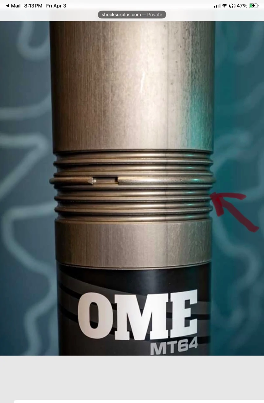

Can you tell me if you clipped yours where the clip is in the picture, or one down from that where the arrow is
That is set at 2.5" one down will get you at 2.25". 2.5" should sit almost level with the Dobinson's I used so either one depending on your taste... Hope that helps

can you adjust the lift height yourself without removing anything?
I am on stock UCA's this is kind of a one and done as you have to pull them apart to adjust them... The lowest these will go is 1.75" and they would probably be a rough ride as they would be right on the external bump stops...

Can you tell me why it would ride rough, and what will be right on the external bump stop. The reason I'm asking is my plan is to set them on the second notch from the bottom.
Maybe I drive crazy but even at 2.25" I feel that it contacts the front bump stops a bit early. Honestly If I had set them at 2.5" they would be about perfect in my opinion I just think 2.00" would really ride the bump stops...

Thanks for posting this, I am probably going to do the same lift as you with the Dobinsons springs as well, but I wanted to clarify one thing on the geometry:
Wouldn't a higher circlip setting (e.g., 2.5", nearer the top of the shock) cause more preload to the spring and create a rougher ride? You get a taller ride height because the spring is compressed tighter against the perch at rest. While lifting it higher gives the frame more physical clearance away from the bump stops, you sacrifice downward droop travel, and the preloaded spring requires a lot more initial force to move.
Not sure how crazy you mean when you say you drive crazy ;), but are you sure you're actually bottoming out against the physical rubber bump stop and not just feeling that harshness from increased spring preload and compression damping over sharp hits?
It's 100% hitting the bump stops :) !! I can see it on the shock shafts as they are totally clean after a spirited run... lol If i did this again I would still have set them 1 notch higher. I don't think 1/4" preload would be that much difference in ride quality if any considering where these shocks are designed to ride as in height...
