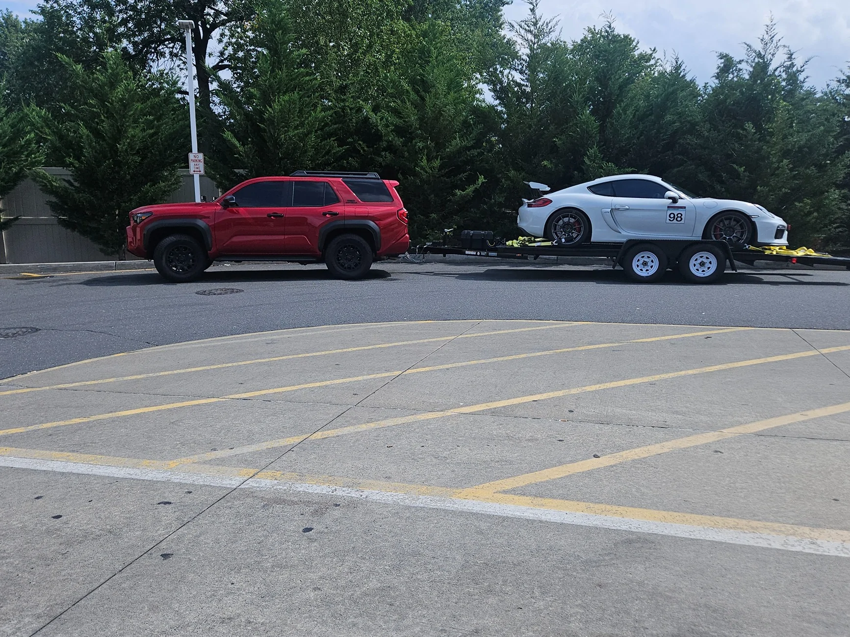

Has anyone tried any higher biting brake pads? It tows well and brakes well but I would like a little more grab im the truck with or without a trailer. Under hard braking it does feel a bit lacking.

As for towing the trailer is 1550lb and the car is about 2900lb. Honestly pulling the empty trailer felt the same as it with a car on it haha, it has the power to pull it, it never sees over 3k rpm or hunts for gears. Going up hill into the pocono mountains I was basiclly in boost the whole time until it levels out but it would stay around 2-2500k. Tempatures never moved, water,oil, trans all stayed dead center. Maybe a little more grunt would be nice for quick starts from a dead stop on an uphill but it gets going the same as regular traffic speed does

it does stop as designed with dual axle trailer brakes and gain properly set, currently at 7.0. But I like to have reserved braking capacity incase of too much heat say down hilll, or in an emergency braking situation. The truck lacks bite with or without a trailer.

Mine stops very well. Something is wrong if four piston calipers is not stopping you

What brand pads do you have on the Porsche?
The front end of the 4R is sitting high, do you have a DW hitch?

A DW hitch? not sure what that is but i just have a regular 2inch drop hitch but switching to a 3inch as per the math but yea i loaded a little too tongue heavy on that trip. On the return trip i moved the car forward about 4 or 5 inches and it leveled out better. The GT4 is on pagid yellows the RSL i think its called.

Weight distributing (WD) sorry :)
