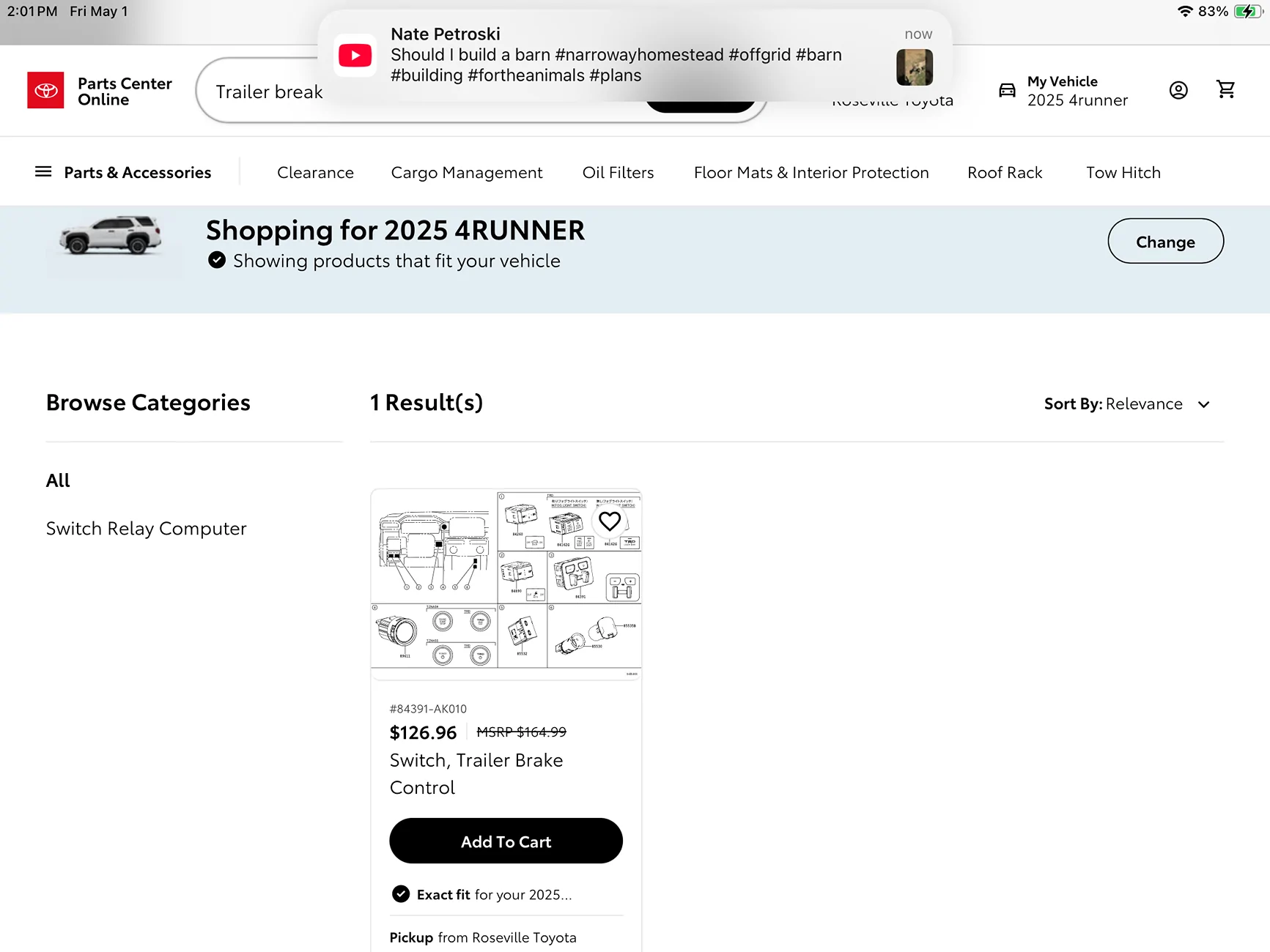

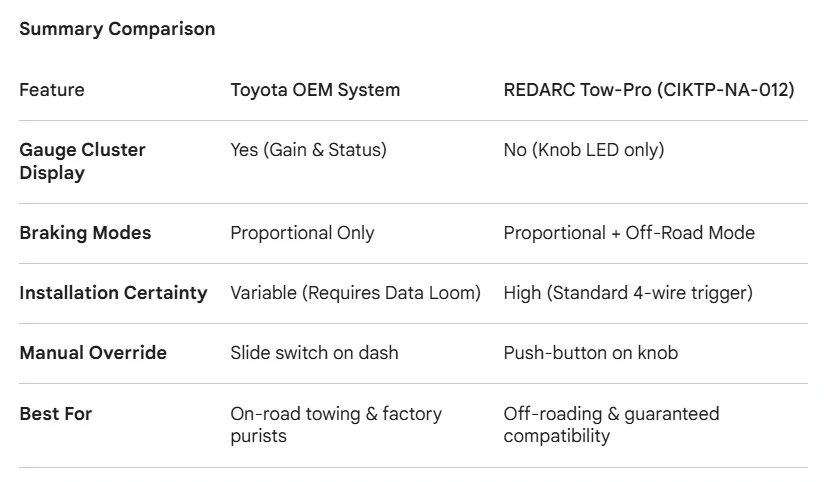

I just ordered the CIKTP-NA-012 kit today direct from REDARC. I got this part number directly from REDARC tech support, but when I enter on etrailers website, it says it doesn't fit my 4Runner.
If you sign up for REDARC news letter you get a 10% off code to use.
Once I get the unit I'll be getting with a friend to get it installed. I haven't removed the bottom left of the dashboard, I hope it isn't too complicated to get it apart.

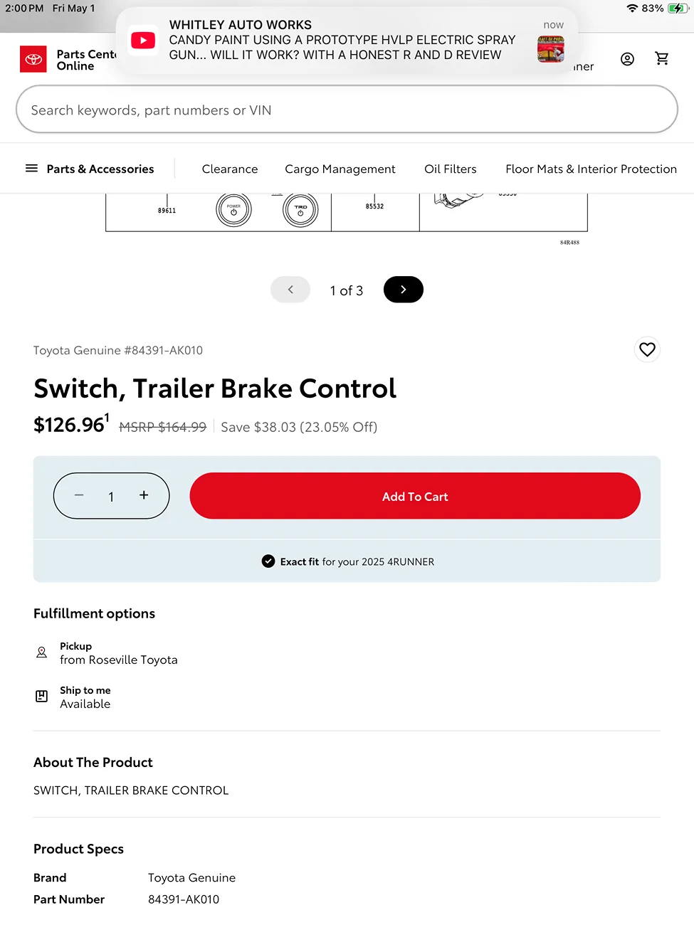

Thanks! I will check out that Redarc part number. I know there was one on eTrailer that indicated was not compatible with my 2026. I just wrestled with the dashboard yesterday. If you remove the bottom switch panel - I used a credit card and a computer pry tool to snap off - you can access the wire bundle. See all my questions and attempts at this thread. :)

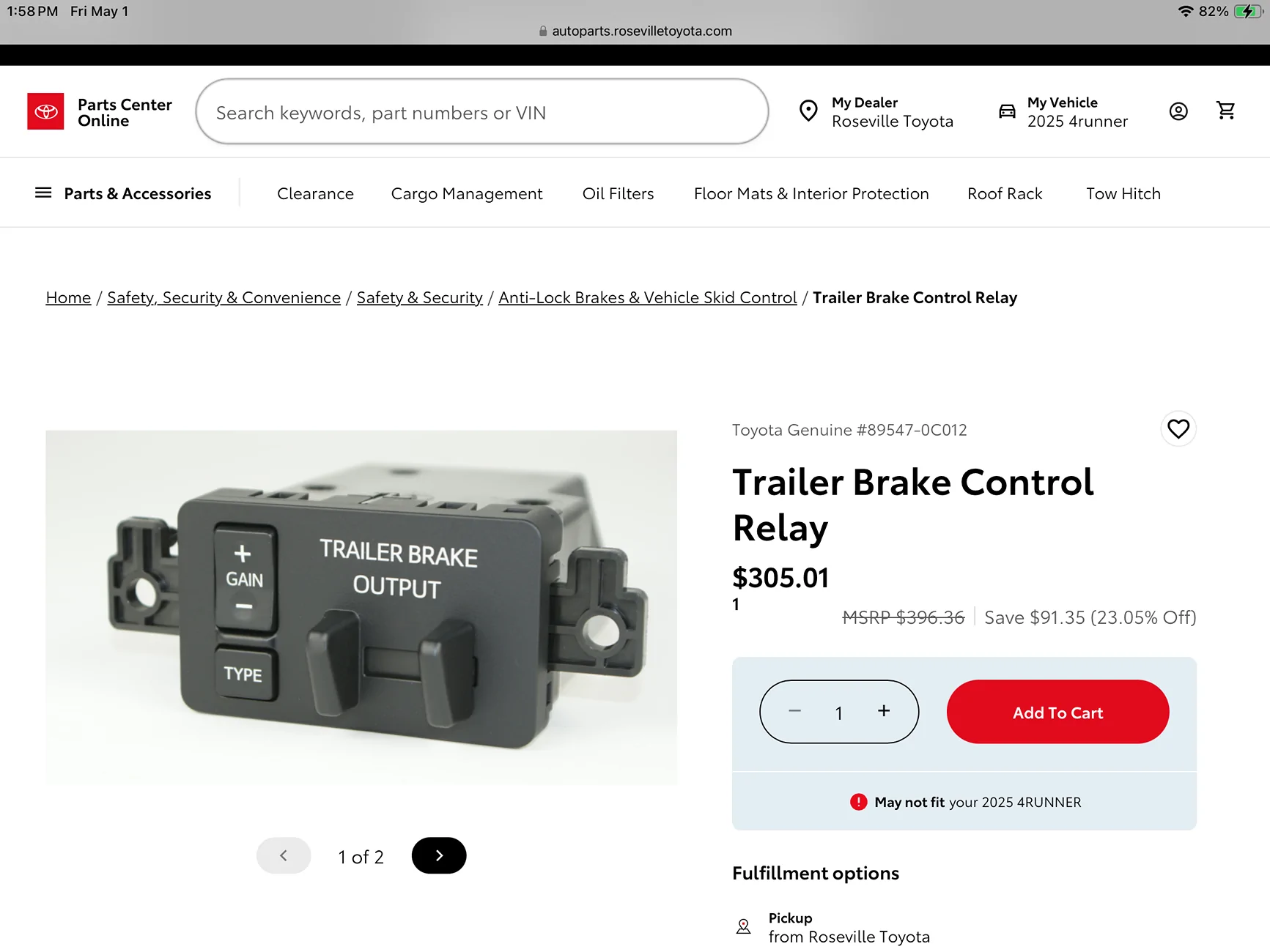

I found this post from another member here
Toyota responded as follows on our request for confirmation:
"The TRD Off Road Premium was originally evaluated with an integrated trailer brake controller. During development, we determined that delivering this feature required additional sensors, electronic modules, and calibration work beyond what most customers in this segment typically need. Removing the factory controller from this grade allowed us to maintain the TRD Off Road Premium at a price point that aligns with the expectations of the majority of our buyers.
Every 2025 and 2026 4Runner is equipped with a factory Toyota trailer brake controller connection point. This integrated plug enables seamless installation of any aftermarket controller without cutting or modifying the vehicle’s wiring. The vehicle is fully pre wired for a wide range of brake controller solutions, and towing capability remains identical to that of the TRD Pro and Trailhunter models.
A factory installed braking system is not possible at this time, as it would require reprogramming of the vehicle’s core control modules, installation of additional sensors, and extensive integration with the truck’s onboard electronics."
I would much prefer to pay $400 for the factory Tow Tech option which includes the controller and digital mirror and they can keep the garbage options like “screen protector, door scuff guards, door edge guards” etc.
