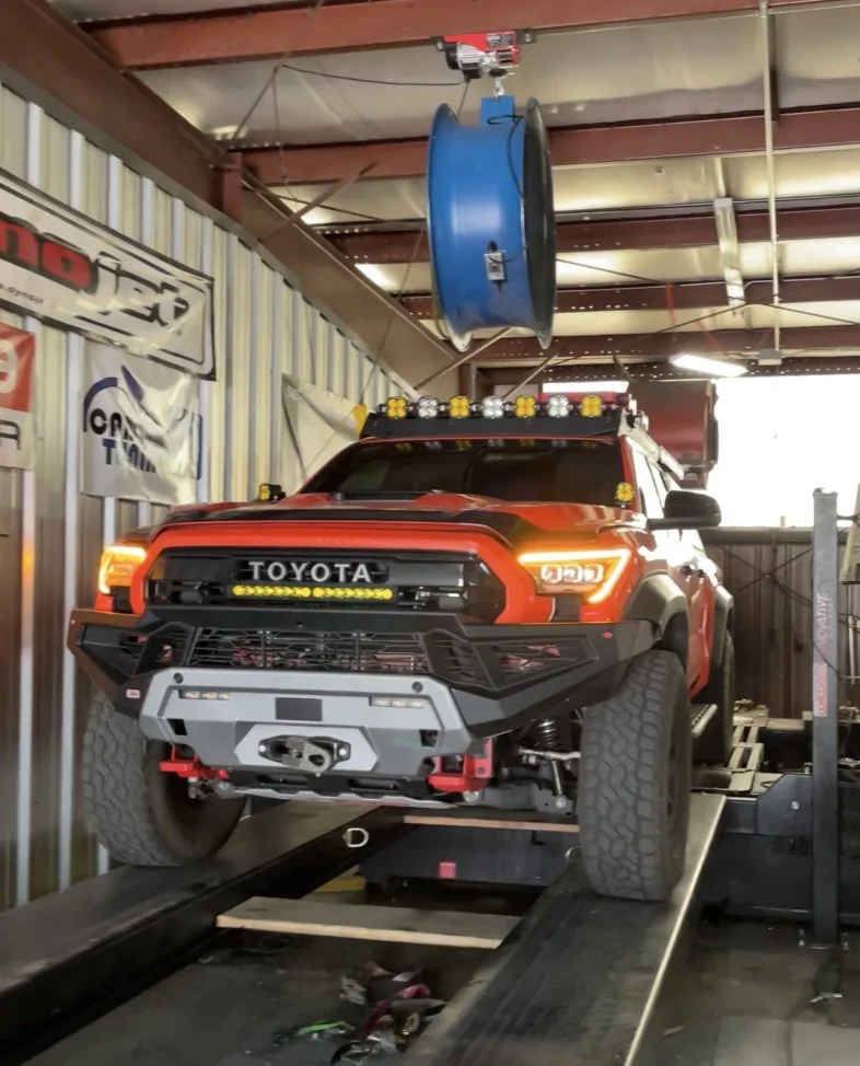

Test Vehicle
  • 2024 Toyota Tacoma (Non-Hybrid)
  • 8-Speed Automatic Transmission
  • Approximately 12,000 miles
  • 91 octane fuel
  • Dyno testing performed in 4th gear
  • AFE charge pipes installed throughout all testing

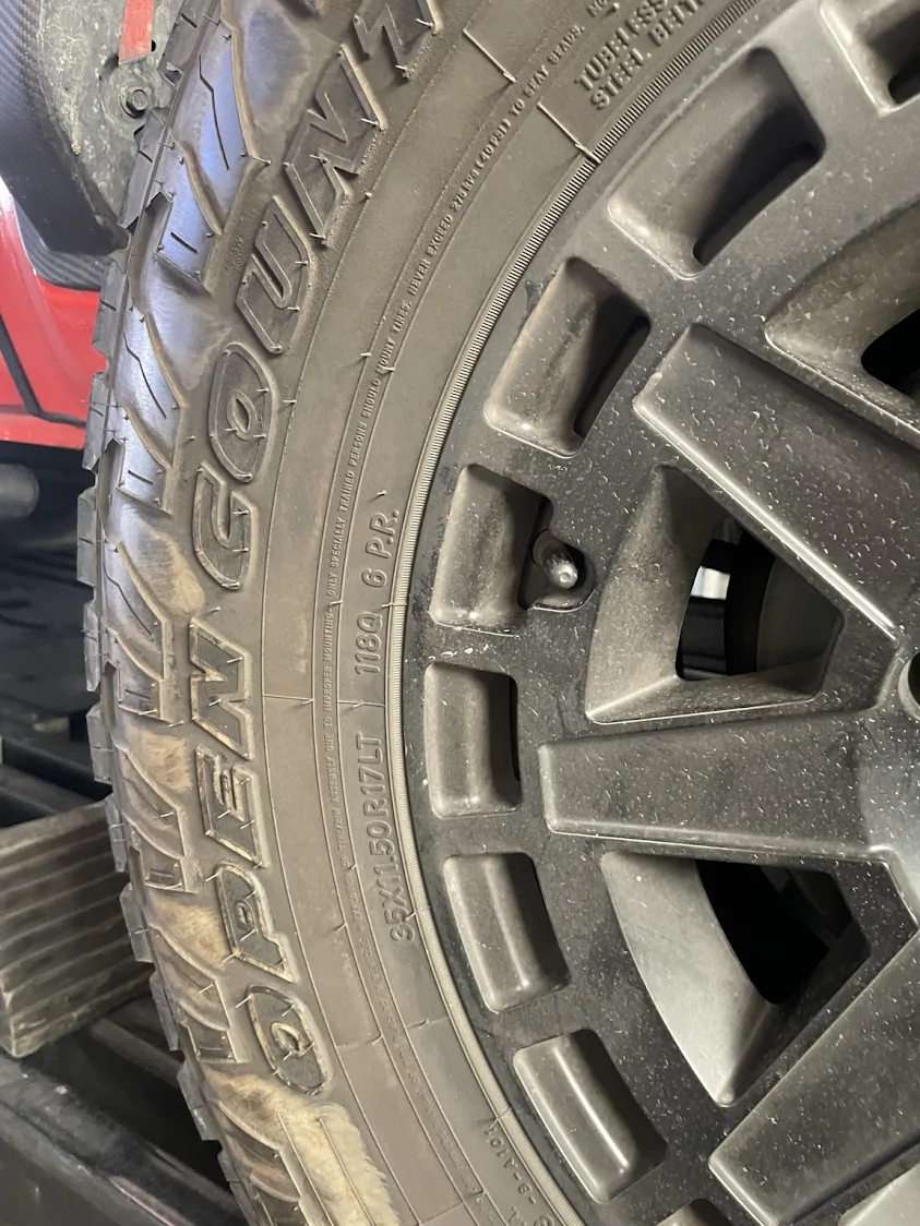

Wheel & Tire Setup
  • ICON alloy wheels
  • Toyo Open Country A/T tires
  • 35x11.50R17LT
  • Load Range C
2025 2026 4runner 6th gen Intake Power Gain Comparison (Factory, Banks, SXTH, K&N) — Same Truck, Day, Dyno, Surprising Results tir
It is important to note that this truck is running a significantly heavier-than-stock wheel and tire package. This absolutely affects measured wheel horsepower and acceleration rate on a chassis dyno compared to stock-equipped trucks.

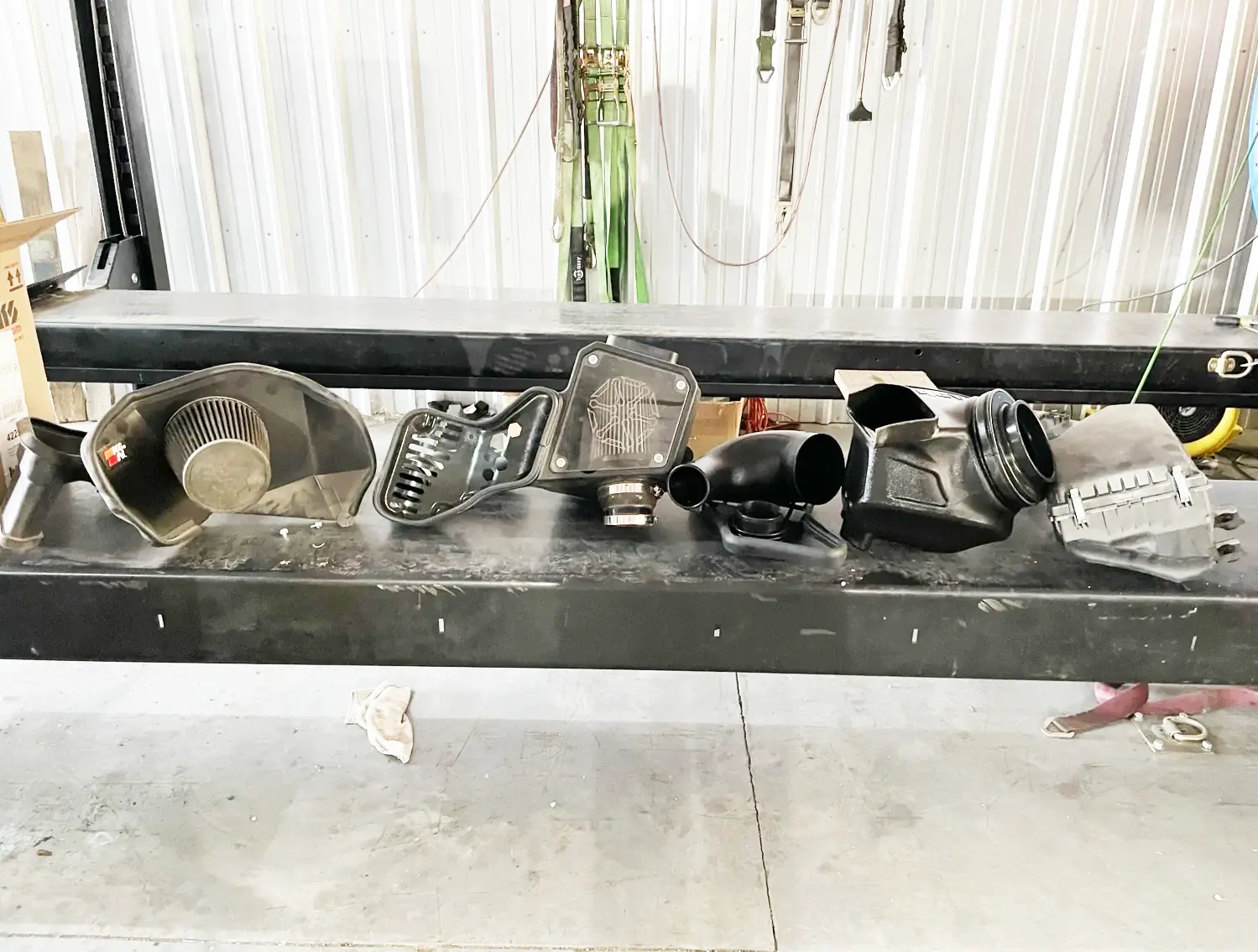

Intakes Tested
  • Factory airbox
  • Banks intake
  • SXTH intake
  • K&N intake (older version that does not replace the turbo inlet)
All intake comparisons shown below were performed on the factory calibration and stock turbocharger.

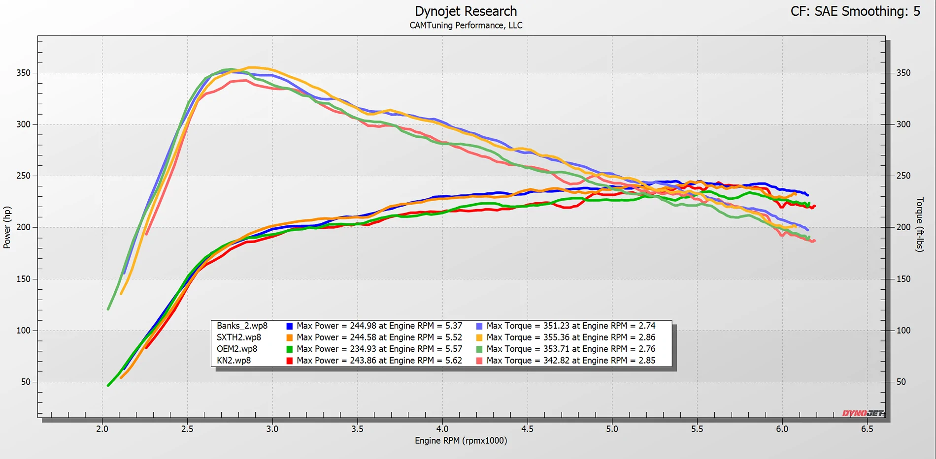

Dyno Results – Stock Calibration
Despite significant differences in intake design, the dyno results were remarkably close.
Peak horsepower results:
  • Banks: 244.98 whp
  • SXTH: 244.58 whp
  • OEM Airbox: 234.93 whp
  • K&N: 243.86 whp
Torque curves were also extremely similar throughout most of the pull.
The biggest takeaway from the dyno portion of this testing is that on the factory calibration and stock turbocharger, the ECU’s torque and airflow management strategy minimizes outright power differences between quality intake systems more than many enthusiasts expect.

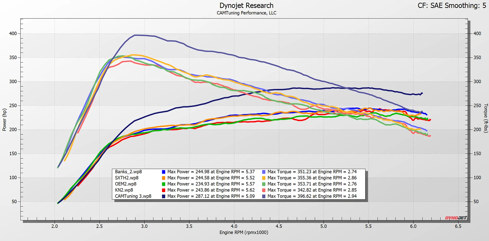

After completing the stock calibration testing, the K&N intake was professionally calibrated on 91 octane for the owner of this truck. Once the truck received a complete calibration — including airflow modeling, torque request strategy, fueling, ignition timing, boost control, and transmission tuning — the intake responded significantly better than it did on the factory calibration while maintaining stable fuel correction behavior.
2025 2026 4runner 6th gen Intake Power Gain Comparison (Factory, Banks, SXTH, K&N) — Same Truck, Day, Dyno, Surprising Results custom tune kn
That is the biggest conclusion from this testing:
These intake systems are all relatively comparable on the stock tune, but they have substantially more potential once paired with proper professional calibration.
The factory ECU is capable of adapting surprisingly well on its own, but custom tuning allows the airflow model, fuel correction behavior, and overall performance to be optimized correctly rather than simply compensated for.

Cam: Really appreciate the scientific approach and controlling variables but that last graph is so compelling I've got to ask....
If you applied "a complete calibration — including airflow modeling, torque request strategy, fueling, ignition timing, boost control, and transmission tuning" for the other tested intakes, how would the results vary? Are there some key factors (airflow restriction?) that would limit the improvement that you show on the K&M for the OEM system? Would the other upgrades achieve comparable results as the K&M?
Since you don't say, I assume that you did not actually adjust the tune but your scientific approach and writing implies both integrity and expertise - and your answer will likely add to my noob knowledge of these physical systems as well as the ECU (which is an amazing collection of algorithms being fed by an amazing collection of sensors that I am very curious about).

That's why intentionally kept the intake comparison portion of the testing on the factory calibration. To be completely clear, every intake in this test was dyno’d on a 100% stock engine and transmission tune. The only change made whatsoever was a minor shift schedule adjustment that allowed the truck to stay in 4th gear during the dyno pull from low RPM without commanding an automatic downshift. No airflow, fueling, ignition timing, boost, torque management, or power-related calibration changes were made during the intake testing.
Once tuning gets involved, the conversation becomes much harder to isolate objectively because calibration itself becomes another major variable. If I custom tuned all four intakes, it would be very easy for people to argue that one setup received a more aggressive calibration than another, even if that wasn’t the case.
The goal of this test was to compare how the intake systems themselves behaved under the exact same conditions on the factory ECU logic. I absolutely believe the other intakes would improve with proper calibration as well.
The bigger question is probably how large the differences between them would become after tuning. My personal opinion is that at stock turbo power levels, the delta between quality intake systems would still likely remain fairly small. Once you move into higher airflow demand situations — larger turbocharger, higher boost levels, ethanol blends, etc. — intake design and restriction likely become much more significant factors.
My conclusion is less “this intake makes X more horsepower” and more that "all of these systems appear capable of supporting very similar performance on the stock turbo and stock calibration, while professional calibration allows the ECU strategy to take fuller advantage of whichever hardware is installed."

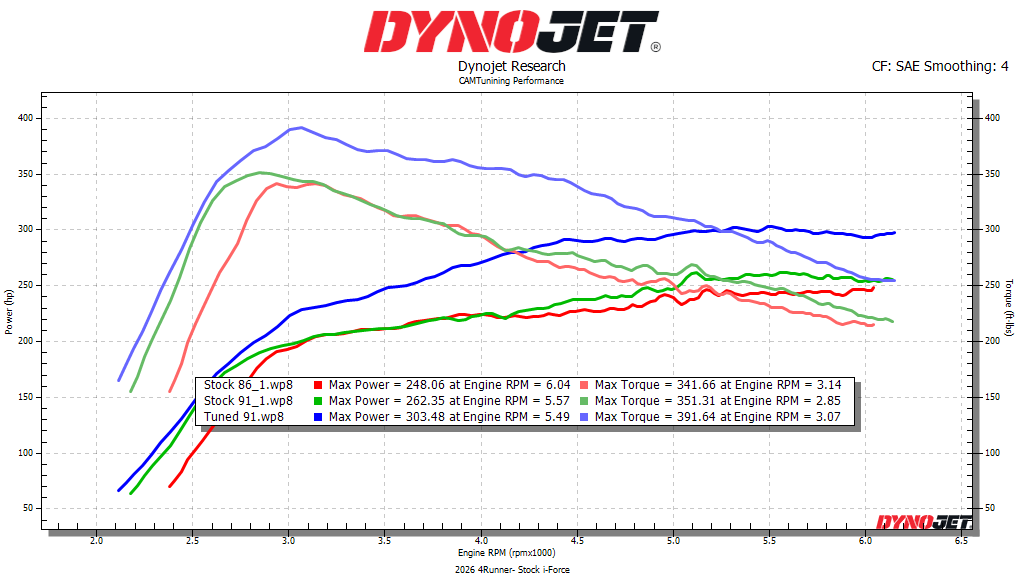

I didn't tune this particular truck on the stock airbox, but I have done a number of them. Tire size has a decent effect on peak numbers, so I focus more on the delta between the stock tune and the custom tune. Here is an example on on one of the non hybrid 4Runners I tuned recently on 91. The 86 number is there because of some earlier testing on lower octane. If you want to see hybrid numbers, I can post those as well.
This graph shows roughly 41whp and 50wtq on a 100% stock 4Runner.

So...... looking at this graph, and the one above....... doesn't seem like the aftermarket intakes have much impact?

It depends, but in my experience an intake is usually good for 10-15hp over the stock airbox on a tuned vehicle. Not every truck is the same though, which is why custom tuning is custom.
