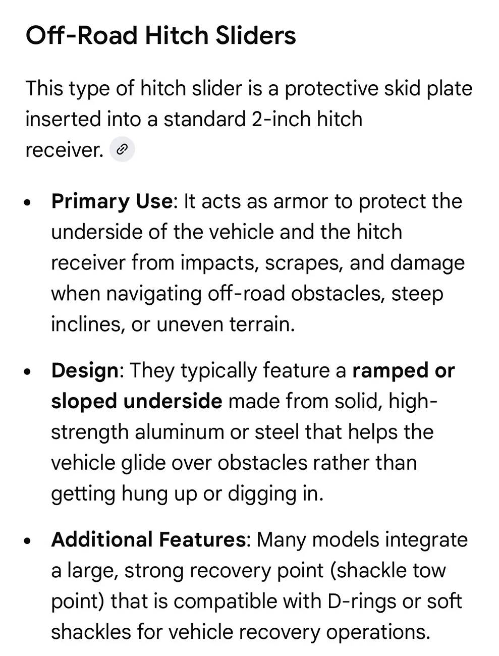

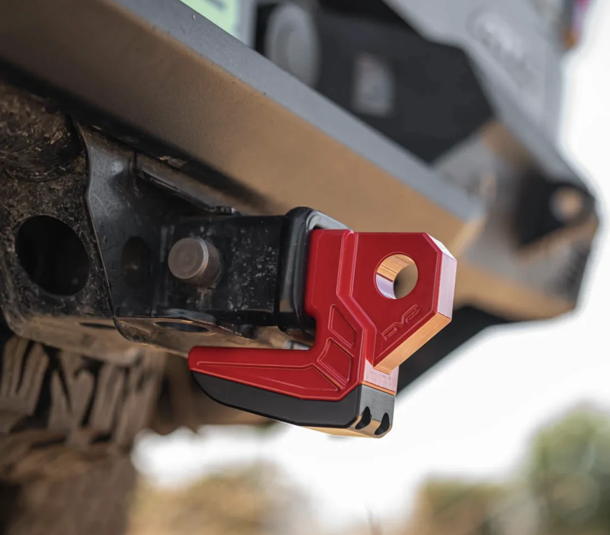

I had never seen Hitch Skid Plate until an add popped up on my socials. Initially I thought it may be a good idea but as I thought about it I started thinking doesn't it just cut down the departure angle. Anyone have thoughts or experience with them?

gimmick that worsens departure angle
I grind my '99 4runner hitch every weekend stepping up boulders
on the way to my cabin. little grinding underside of hitch...loves it
if I added that thing I'd get hung up

Not only decreases departure angle, but also increases leverage/torque on the hitch assembly when it hits.
Do they make a skid plate to protect their pretty red hitch skid plate? ;p
