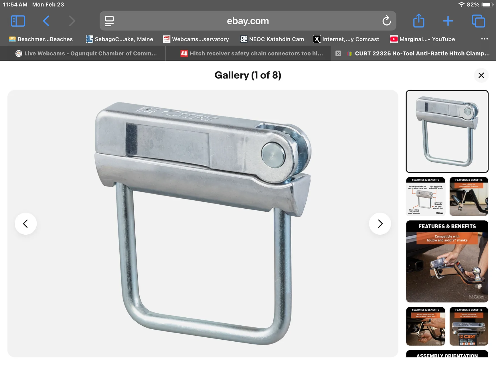

There was a few things in the glove box including extended pin. But even with it the clearances are really tight.
Hey how about when your on your hands and knees (which is necessary because of the location of the trailer wiring jack) and you trip that absolutely useless auto close/open hatch switch.
Try to boogie out from under there in a hurry.
Curt has a lever type rattle device that works on the 4runner hitch.
2025 2026 4runner 6th gen Hitch receiver safety chain connectors too high. IMG_2854
2025 2026 4runner 6th gen Hitch receiver safety chain connectors too high. IMG_2856
