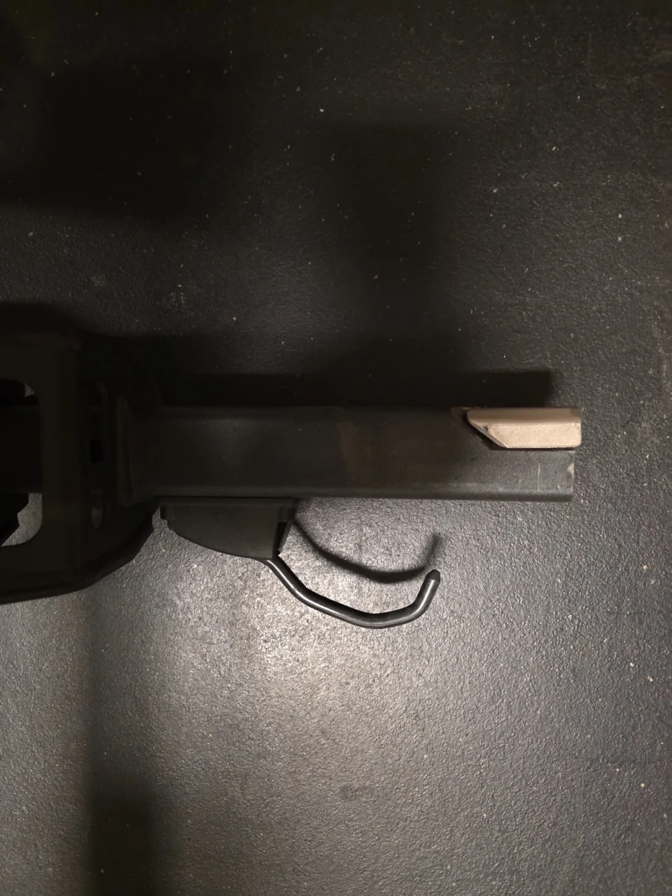

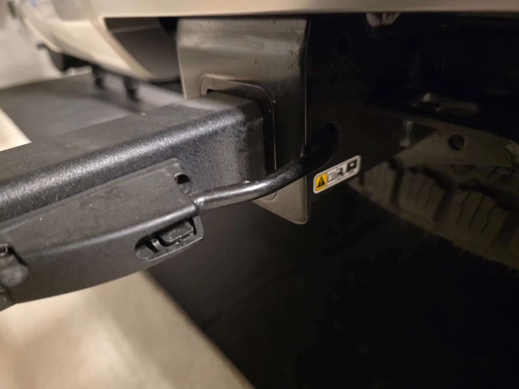

Just a follow up on your test fit…
When you mounted the carrier on your 4Runner, did its security pin “track” line up ok with the hole in the receiver itself so that you could insert and secure the pin?
brumey
Feb 1, 2025
788
439
Not made in China
Bicycle
Yes, the hitch insert has a slot. I have the longer pin, lock and it lines up. I also purchased the locking cover that goes on the end of the hitch insert covering the locking, anti wobble screw. No modifications have been made.
