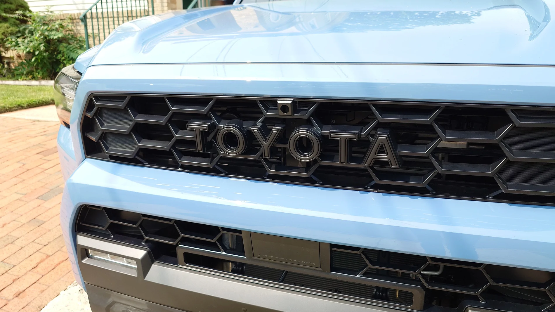

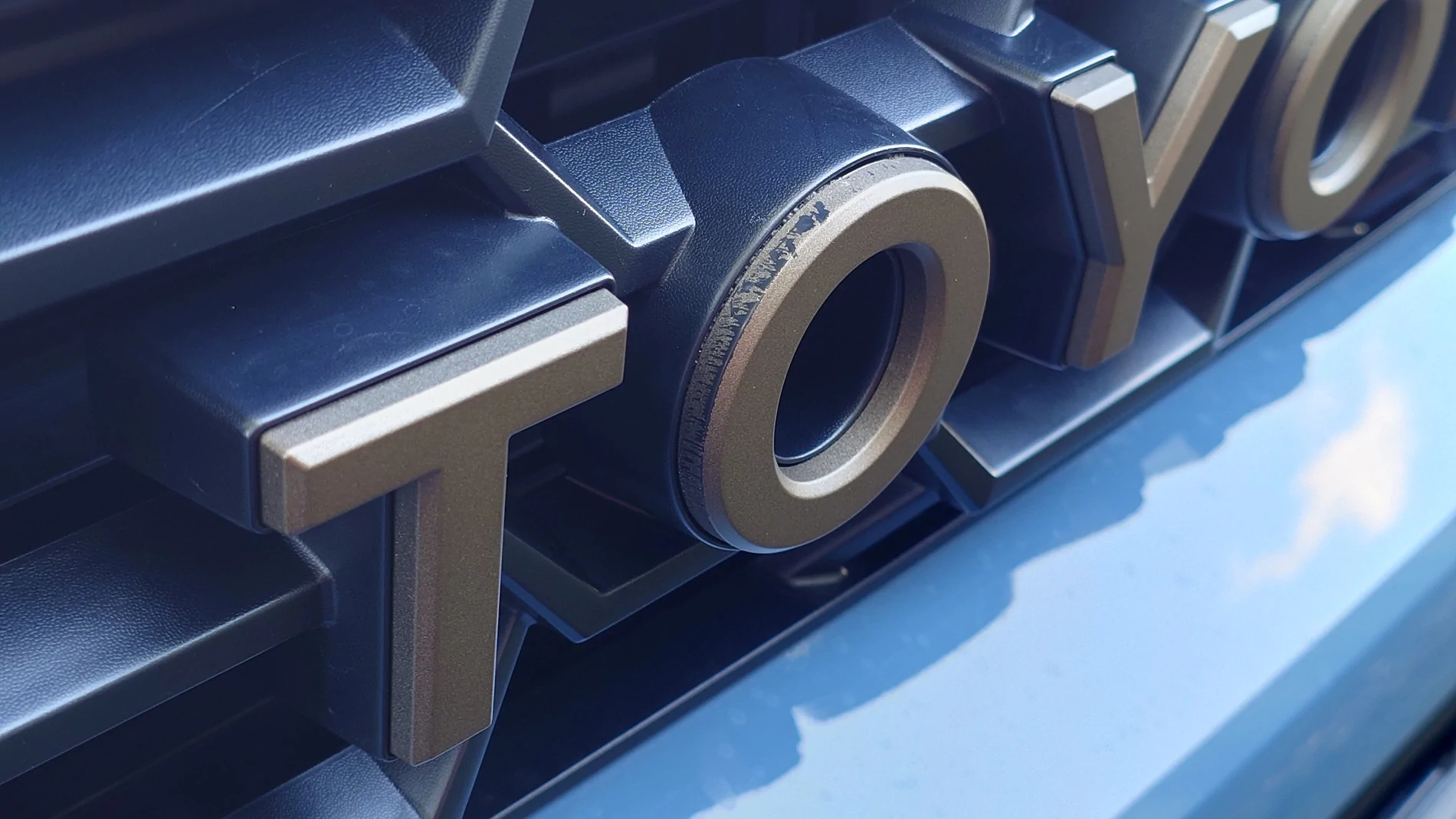

The letters only come in bronze (maybe silver too), but the good? news is the paint is worthless.
I got the matte black overlays and they look like ass with like a puffy shape, so I used alcohol to loosen the vhb to take them back off, and it dissolves the paint. It's just a thin single coat, no primer, no clear coat, nothing. Scratches if you look at it funny, mere denatured alcohol dissolves it. Like a worthless aliexpress toy instead of the exterior of a vehicle.
The bronze part is a seperate insert that is also only stuck on with vhb, So you could pry them out and clean the paint off easy and have plain black plastic, or paint the inserts some other black or color match the body etc.
(Here the T just happened to come off easy, but then the O stuck hard so I used alcohol and the scuffed part happened just from touching it, and I could see bronze dissolved in the alcohol run off, so the remaining paint is thinner and duller on the O. So the rest of the way I managed to get the hard way without using alcohol again.)
If you don't hate the way these black letters look, then the part number is above.

I'll say one thing though, I said I didn't like the way the overlays look, but I just realized they have one big advantage. They don't have weak worthless paint. The main shell part is like silver polypropylene with black ink or paint that the alcohol didn't touch. The puffy part on the front is a resin dome sticker. The resin itself is black not a paint. Both of these will surely take a lot more weather and washing and highway blasting than that bronze paint.

Sorry to bring this thread up again. Do you think if I took a cloth with acetone, I would be able to just wipe off the bronze?
I also do not like the bulby look of the overlay

Good news on the letters is that they're just 3M'd on so you can remove and paint the existing letters if you don't want to buy the overlays. I've had both silver and white plastidipped (well technically DipYourCar) on mine and they worked out great.
