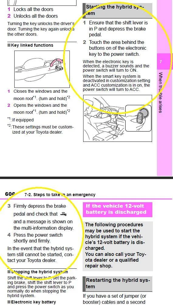

can you hold the fob and touch the start button with the fob to start the vehicle ???
thats is the emergency procedure to start a vehicle if a fob is dead
Thats the weird thing...it starts and drives but all the electrical wont come on till I start it. wont lock/unlock, no interior lights, hatch wont open, cant even use the hazards.
