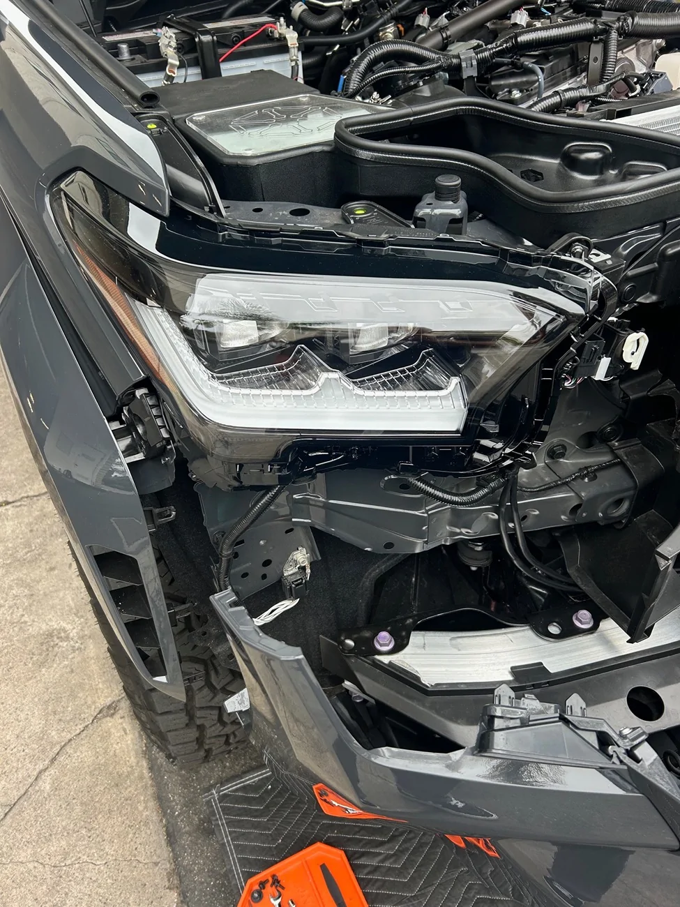

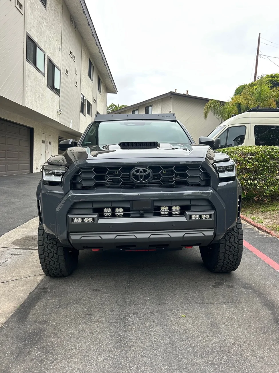

It's been a busy week of mods! After installing the carbon fiber hood this week I got a message that my 6Gen Limited Headlights arrived (Took about a month from order date).
I bought these at a discount from a local dealer PLUS the 25% off Toyota discount so about $700 each side vs the +$1300 retail!
SUPER happy with the results. Definitely makes a huge difference funtionally and astecically.

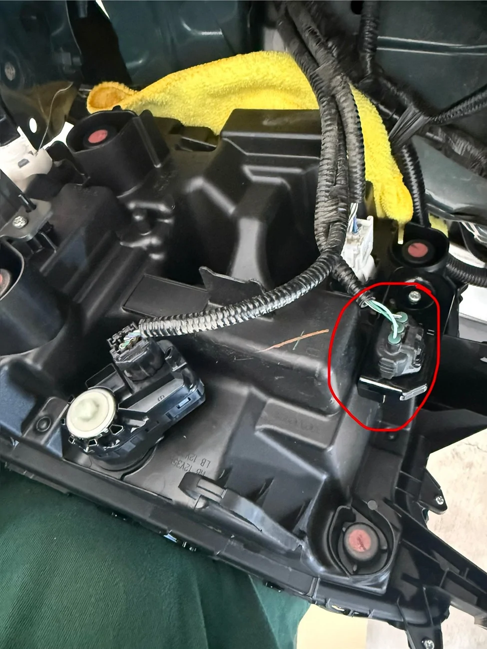

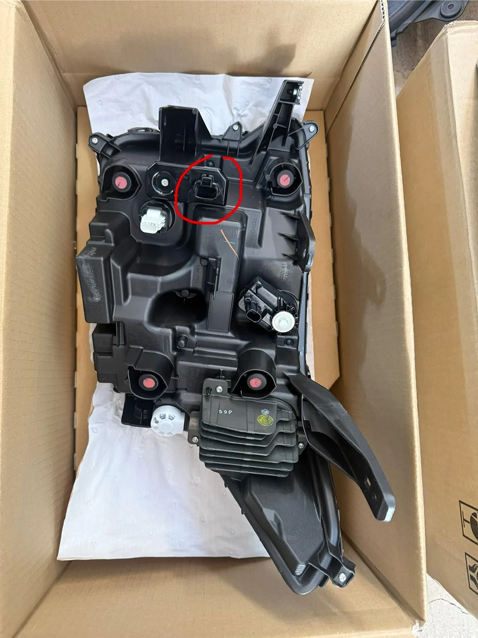

Super easy install. Plug and play. Only note is that the stock headlights have three connectors but the Limited or TRD Pro Headlights only have two so just tuck away the third connector (Not needed)

Looks sweet man especially with your Seibon carbon hood. Please post lighted daytime and night time pics.
Thank you! I love them. Tried to take a pic of the DRLs during the day but you get that "flicker". Will try to update later

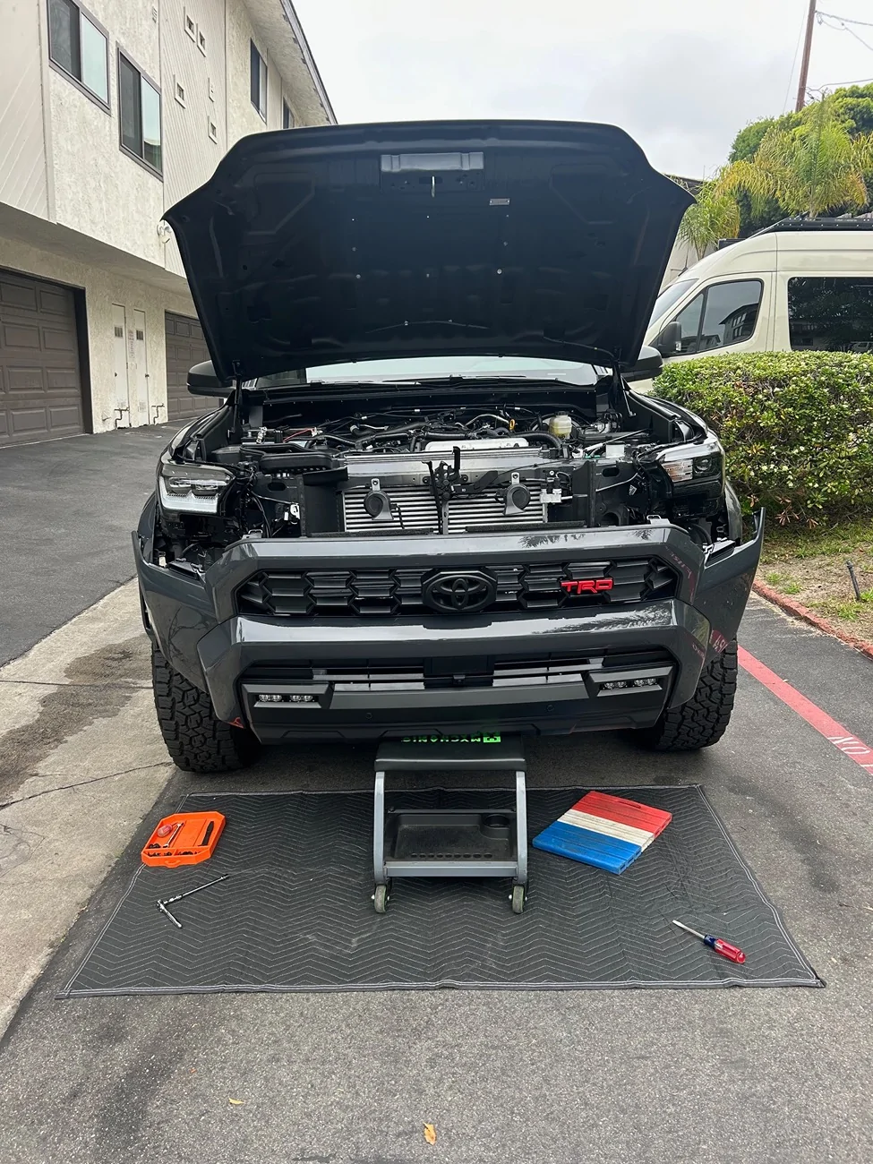

Did you install the BD under-grille lights at the same time? You don't need to fully remove the bumper for those?
I installed those earlier. Yes you do... I probably have taken the bumper off three times... :)
It's really pretty simple. Just remember to disconnect the battery before removing the bumper electrical connects

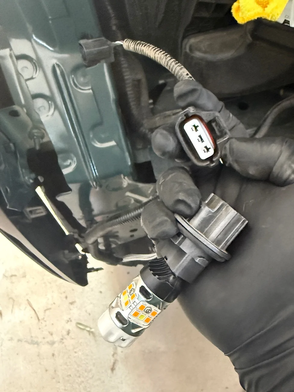

I did the same mod over the weekend! There is actually a dummy plug you can use for the halogen connector. Snapped some photos for reference

What’s the functional improvement you mention? Also, those appear to be the stock puny horns that definitely need replaced and are only $100 for the pair from StickerFab.

The Limited and TRD Pro headlights have two lights per side (Vs one on the stock set) and they are higher intensity.
Regarding the horns, I'm not sure what you are looking at but the pic clearly shows the upgraded horns...
