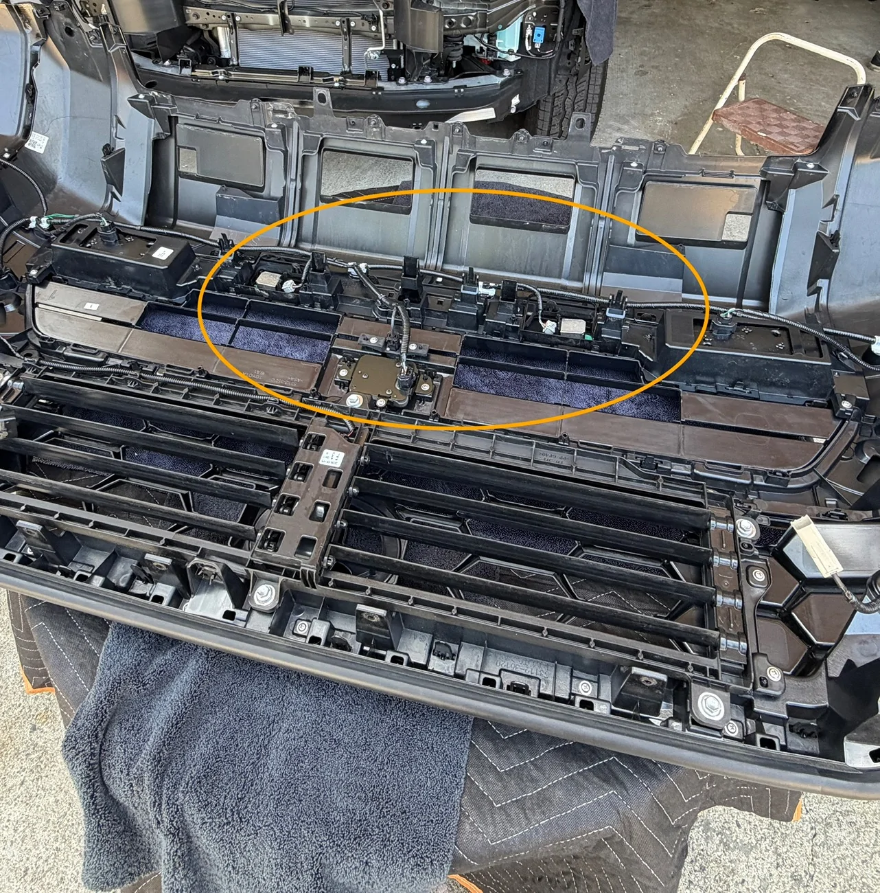

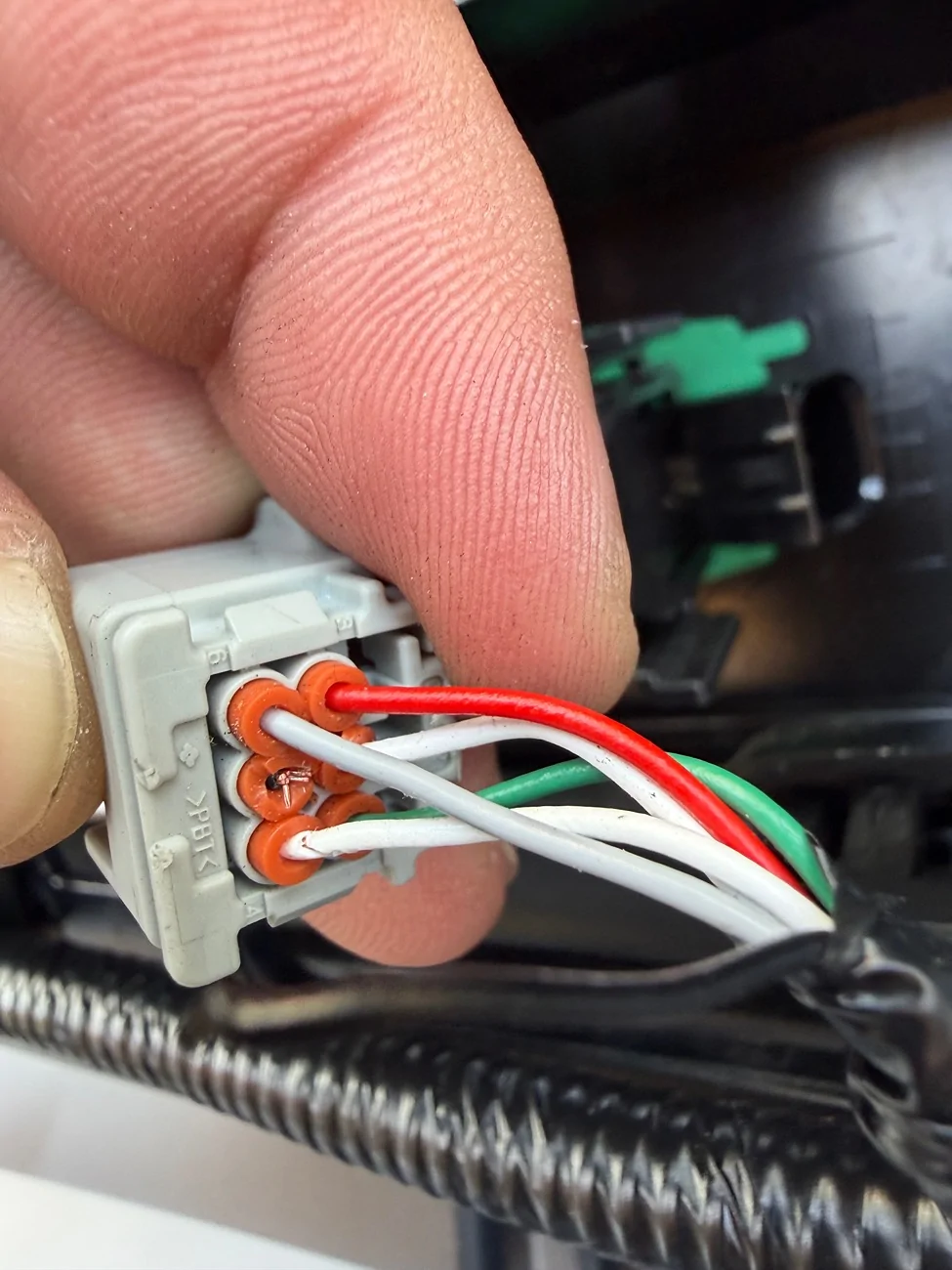

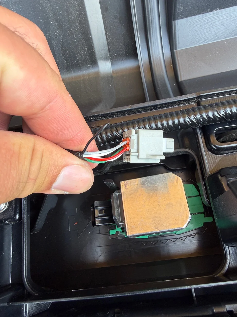

Hey everyone. I just did the heritage grill swap and added a light bar. But I made a dummy move and accidentally clipped a wire on my parking sensor connector when trying to remove it. Is there anyway I can repair this or anyone have the proper part number to replace it?

Simple fix if you can find the correct pin. De-pin the cut one and crimp on new pin.

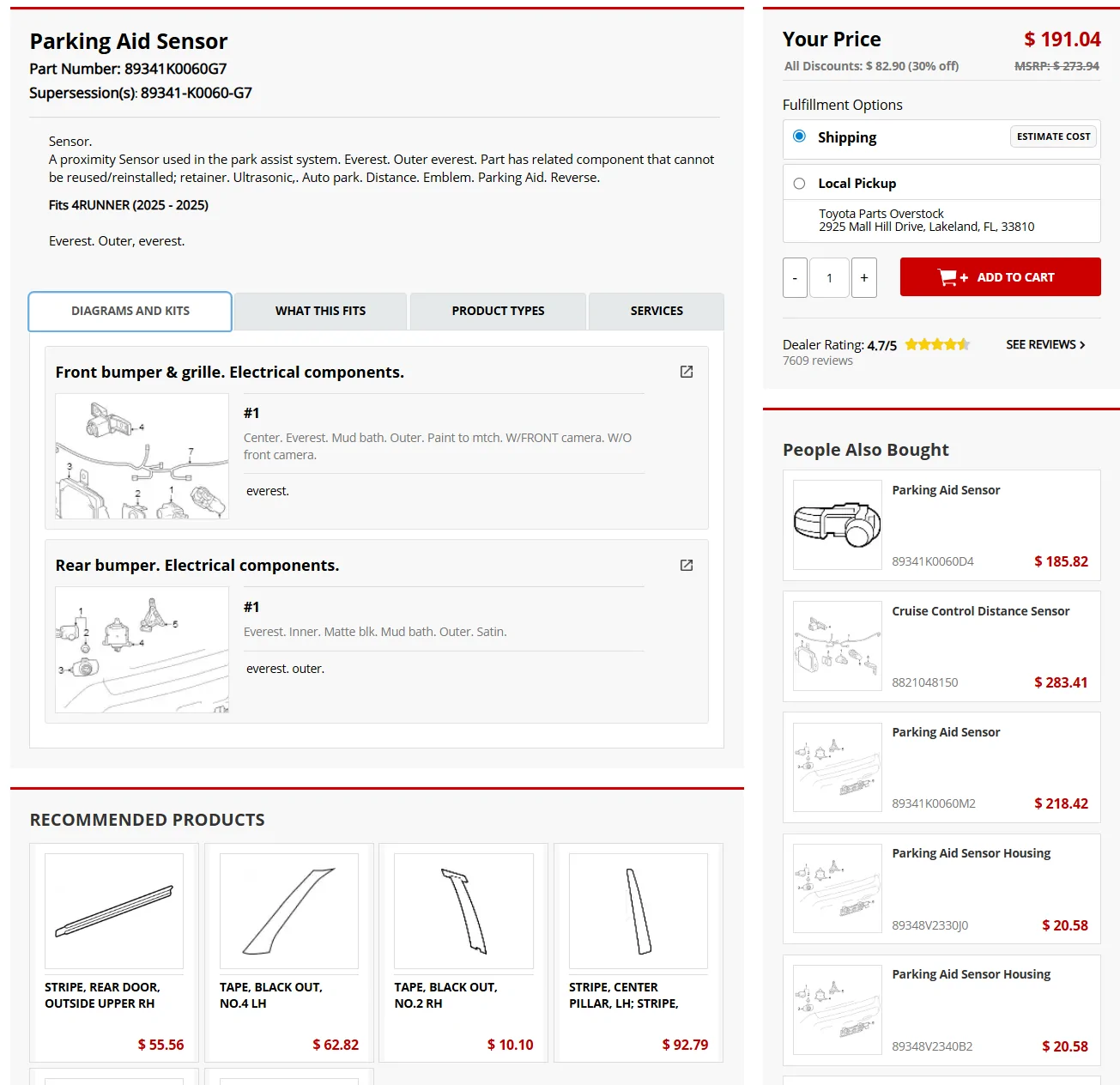

parking sensors are pretty universal for toyota's, at least the new gen vehicles.
it will come down to selecting the correct color. i am guessing you have a gas model and not a HV one.
this is just an example for an everest color sensor and breakouts of the different components
https://parts.lakelandtoyota.com/p/...MI5-jJsezqkwMV8UL_AR2i-hHaEAQYBSABEgIKNvD_BwE
I think the OP has damaged wiring Harness. Part # 8211435030 (w/o front camera) is listed as $103, and part # 8211435050 (with front camera) is listed as $142 if replacing the entire wiring harness.
If repairing with just correct pins, it will cost much less (just few bucks) but I'm not 100% sure what type of pin/blank connector that wiring harness requires. My guess is PBT blank connector with six wire pins as shown on the photos in the original post.

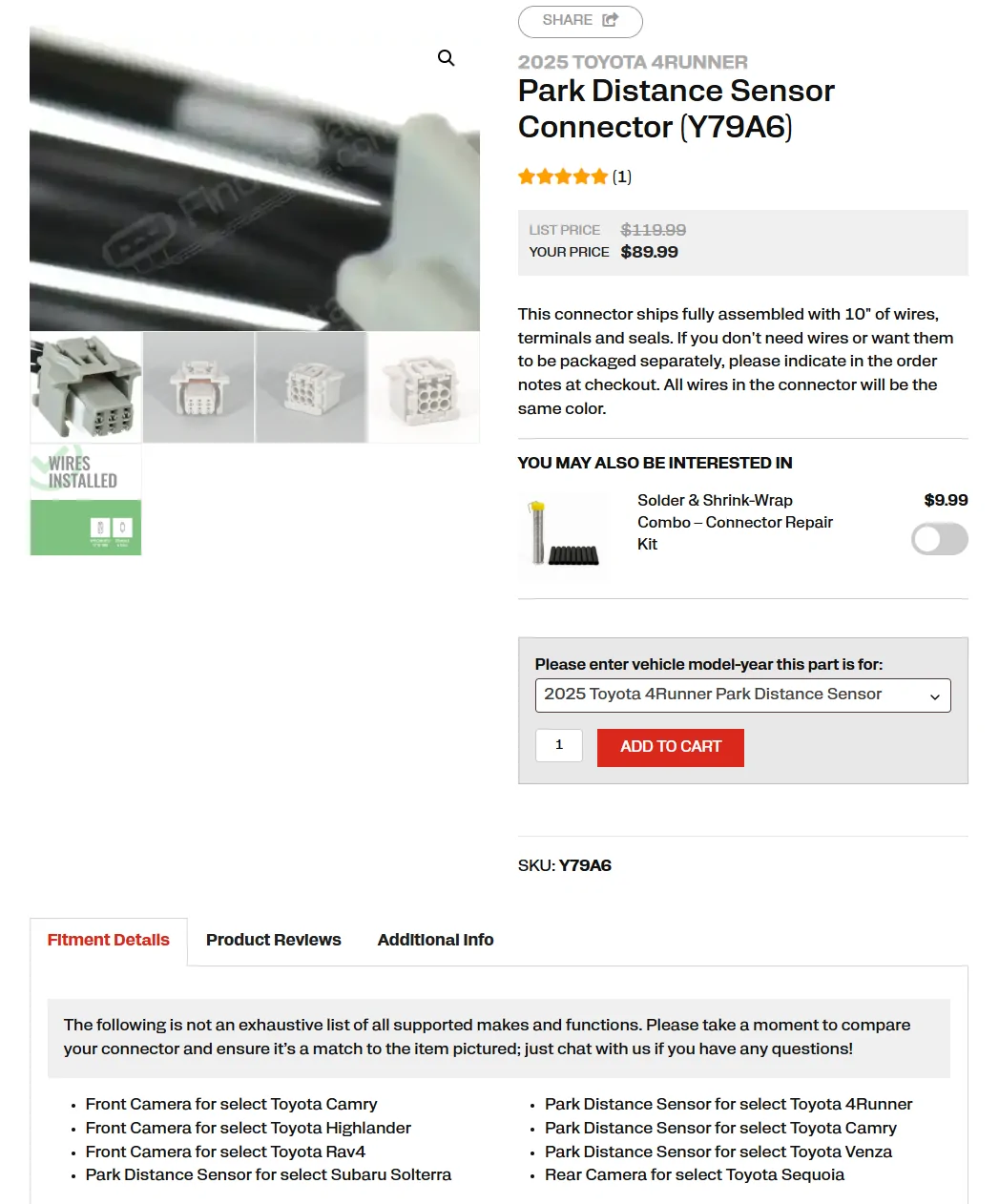

OP, if you have time...look through here.
https://findpigtails.com/industry/toyota-electrical-connectors/?
https://findpigtails.com/photo/
srsltid=AfmBOoq5fgUD22qnrZw5kH7KubTtMONusXwvKjPTnSghSv9L7xc3ZUji
https://connectorbook.com/identification.html?Q=
https://findpigtails.com/app/
The first two links above would be the easiest...for Toyota vehicles.

Thanks for this! I don’t mind spending on the wiring just for comfort knowing I did it correctly lol but I’ll look into the this as well!

I use www.findpigtails.com all the time. They have great customer service. Can text them some photos and they’ll text you a link to buy
