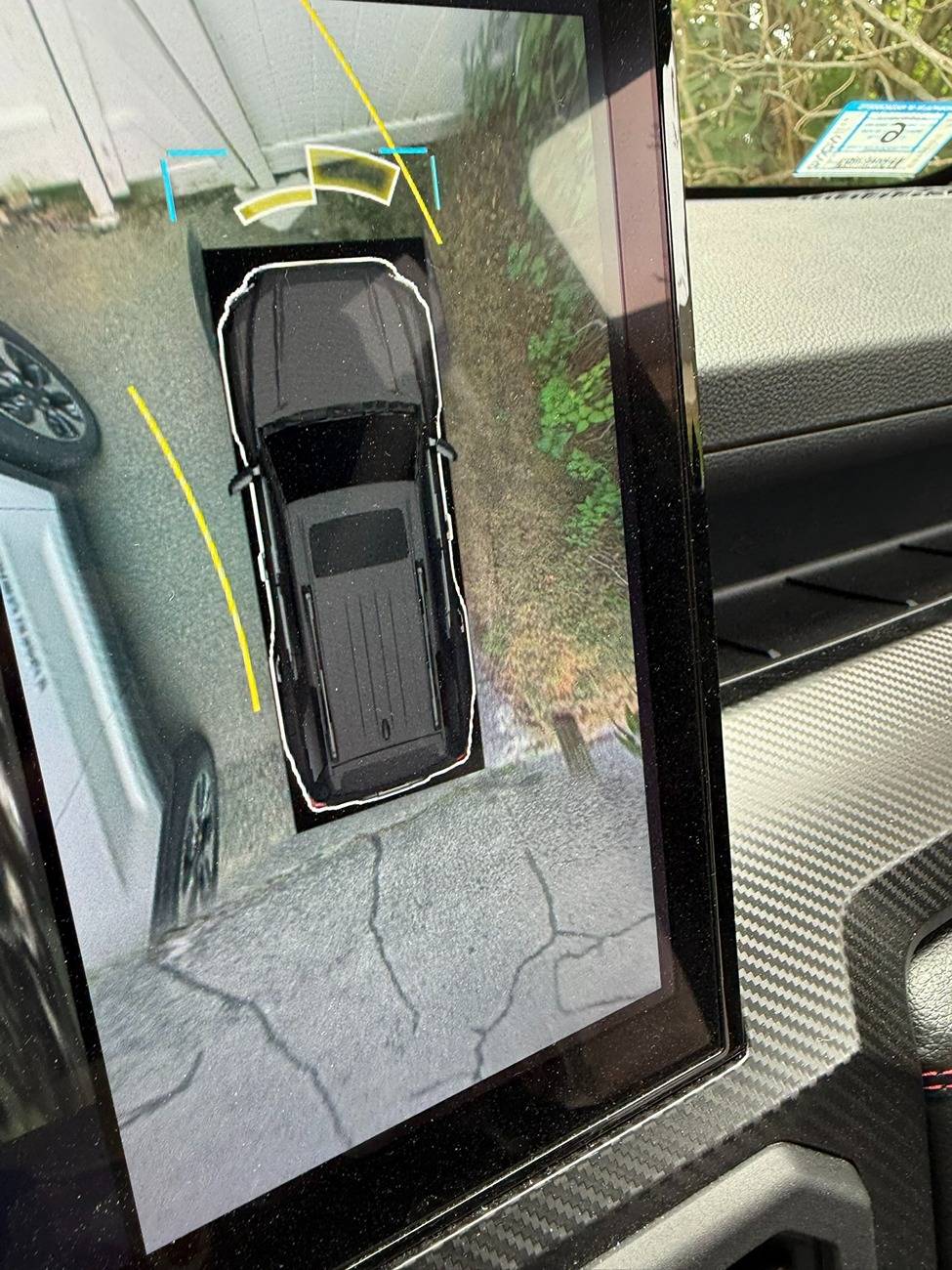

Wow, that is not great! Weird
I seem to recall there's a big section of the manual describing all the potential blind spots (or really, blind areas not spots). There's only so much you can display when you only have 4 cameras somewhere in the middle area of each side of a rectangle to cover 360* and non of those cameras has a 180* field of view. It's not a toyota issue, it's an optics issue. The field of view for each camera is a cone (or triangle) not a semi-circle.
Here's a crappy drawing I threw together to make the point. I'm guessing on the camera field of view (blue triangles) but it's probably close. The area in yellow represents the blind "area" when the 4 cameras are stitched together. Notice that the obstacle (green diamond) would be visible with the vehicle in the drawing, but as it backs up, the obstacle will fall into the blind area and disappear.
