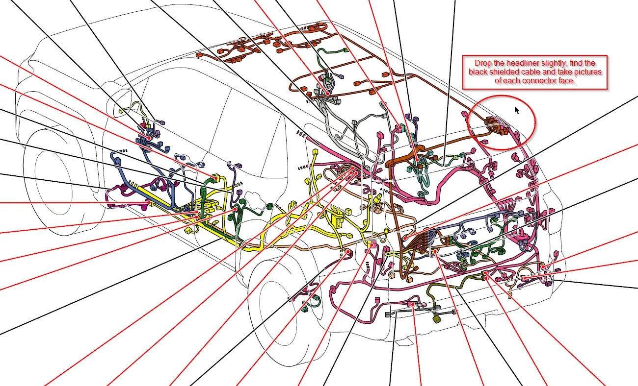

I'll follow up with a quick note. We got pictures of the connectors at the camera, but are looking for someone to help get pictures under the headliner. Pic has details. This video shows the process for getting under there:
2025 2026 4runner 6th gen Backup camera relocation kit development - need tester for free kit 2026-09-22 15_02_22-HVBodyL-W1.pdf - Adobe Acrobat Reader (64-bit)

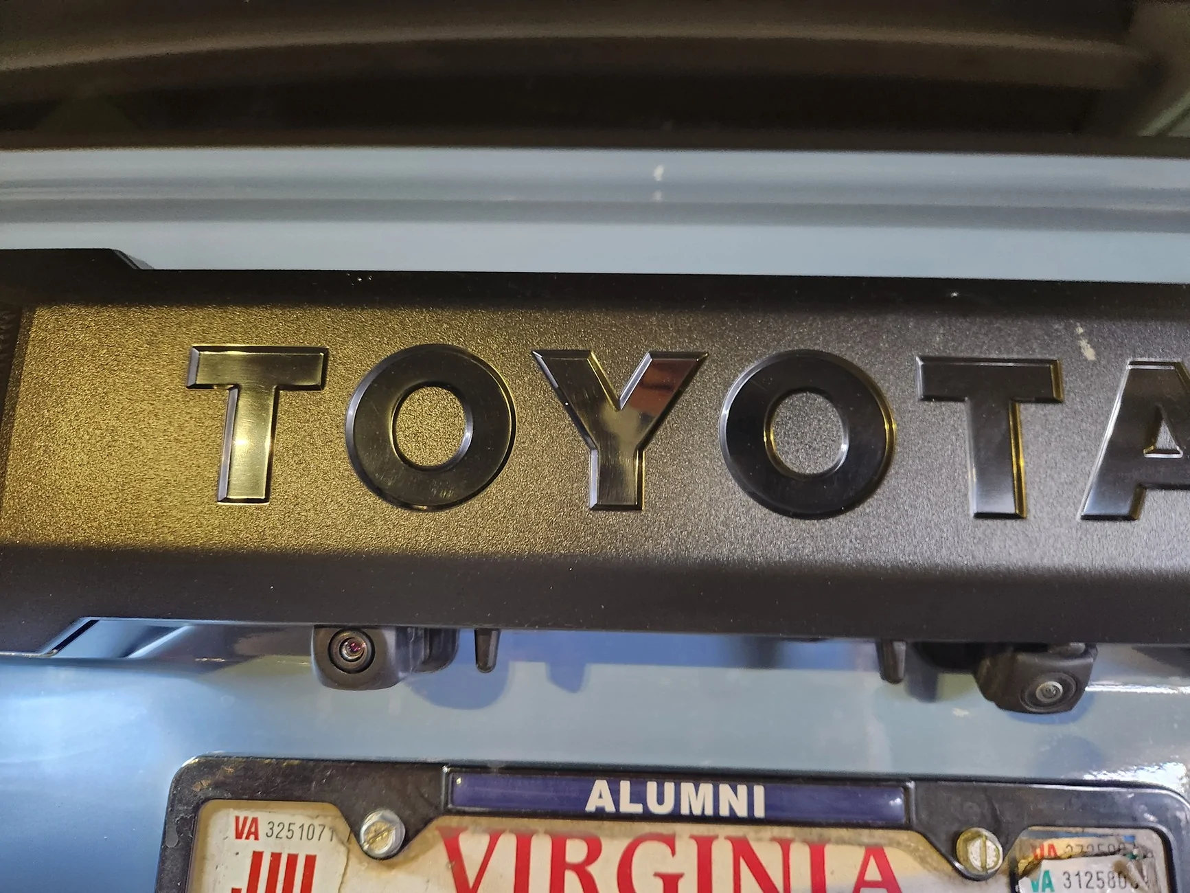

Here are the two cameras. I believe the DRV is on the left under the O and the backup is on the right under the T. If you have a kit for both I'm likely to be a customer. Have been considering both hitch and bumper-based swing out carriers for my 285/75R18 spare but need this problem solved first. Will otherwise be carrying on the roof for late Spring cross country trip so would need this available around March 2027. Is that likely?
2025 2026 4runner 6th gen Backup camera relocation kit development - need tester for free kit 1000008222
