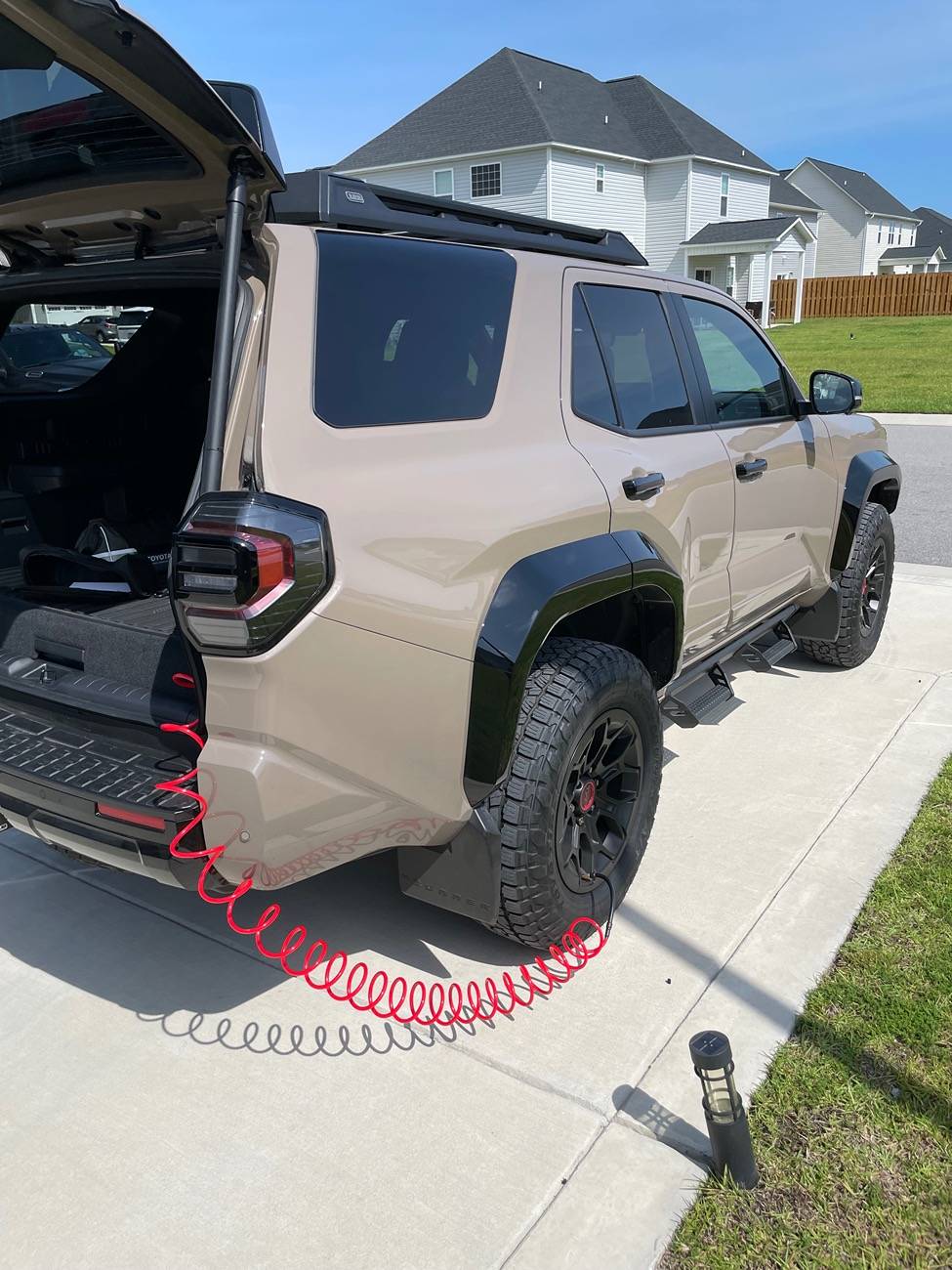

I found the part numbers for the compressor, mounting bracket, and hose accessories compatible with the 2025 TRD Pro.
I called the dealer and was told this is an ARB aftermarket part and their service department won’t install it (WTF!!!). I was informed this will ship directly from ARB and the dealer could not provide details on when it would arrive.

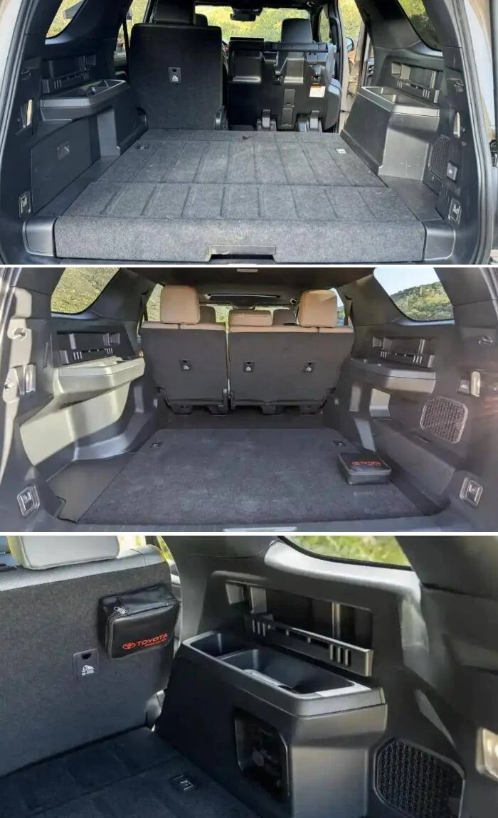

just a note you will have to buy the interior piece that is specific to the air compressor spot
see this post of the different rear passenger side interior build outs
and be mindful, there is more than one panel you have to replace, so it can be spendy real quick.
there is 3 different passenger rear cargo area configurations.
https://www.4runner6g.com/forum/threads/truck-girl’s-first-4runner-subwoofer-on-different-cargo-area-sides-in-different-trims.2751/post-38890
if you dont want to jump to my old post here is screen grab from that post
the bottom pic shows where the air compressor is stored

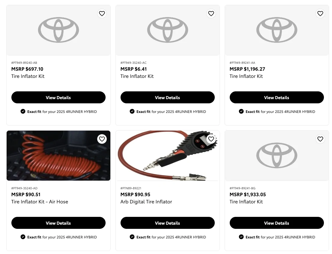

Really curious if anyone has done this? I was just looking up the parts and it seems there might actually be 4 needed:
2025 2026 4runner 6th gen Factory air compressor on a hybrid OR? 1770143620109-5u
I haven't called the dealership yet, but the descriptions on each part are:
- #PT949-89240-AB ($697.10) - "4RUN COMPRESSOR ON BOARD"
- #PT949-35240-AC ($6.41) - "TIRE INFLATOR FILTER"
- #PT949-89241-AA ($1,196.27) - "4RUNH OBTRIFL CTRL PNL SQ"
- #PT949-35240-AD ($90.51) - "Tire Inflator Kit - AIR HOSE"
The 4th part that wasn't mentioned previously (ending in "AA") seems to be the square control panel, and unfortunately is separate from the actual compressor mounted inside the body. This matches the Tacoma because it was 2 separate pieces in the bed of the truck: Tacoma install video by Rave Off Road
If all are truly needed that comes to $1990.29 before discounts, shipping, etc. The 6th product in the screenshot listed at $1933.05 might be all of them bundled but it doesn't have a description. I'm just guessing so if anyone knows for sure or has done it would love to verify!

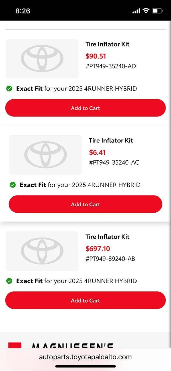

Update: after adding to the cart with my dealership's discount, total for the 4 parts separately came to $1496.62.
