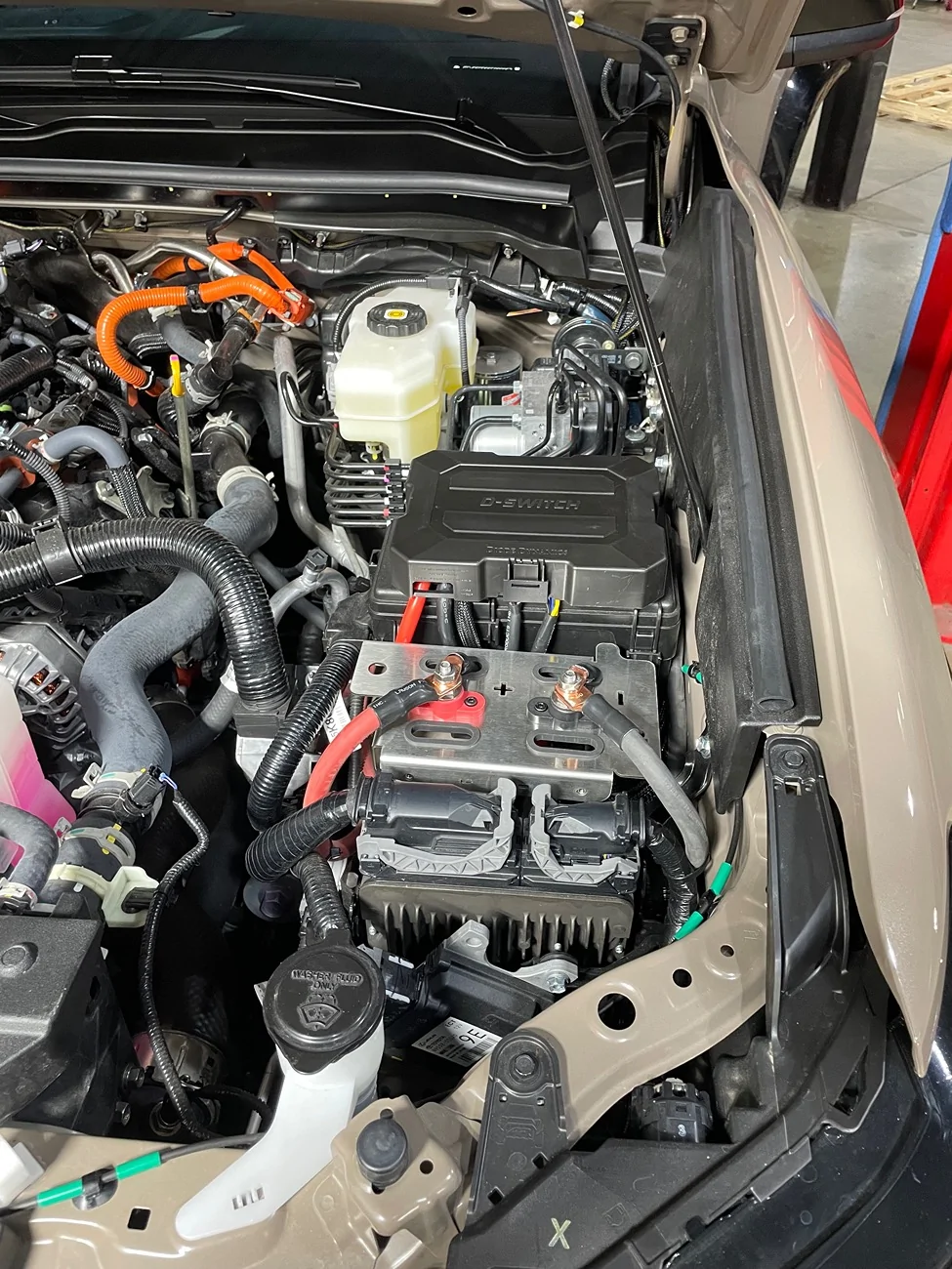

I’m still looking for somebody that installed on the hybrid because of the electric motor they shut down and start up but I don’t know if he’s gonna interfere all these videos are for non-hybrids
mine is a hybrid but I have a power plate installed in my engine bay that runs lines up from the starter battery in the rear.
@mcd_ovrlnd The terminal located inside the fuse box in the front engine bay -- that is connected to the positive terminal of the 12v starter battery in the rear cargo compartment -- is the other option for power source for the 41.22 kill switch control box. I had considered it before leaning towards the fuse tap option. I would reconsider utilizing the positive terminal in the fuse box if there a secure way to connect the wiring from the kill switch control box to the power plate. Is there a small screw clamp terminal connector for wiring to securely clamp to the terminal?

@mcd_ovrlnd The power plate in front engine bay -- that is connected to the positive terminal of the 12v starter battery in the rear cargo compartment -- is the other option for power source for the 41.22 kill switch control box. I had considered it before leaning towards the fuse tap option. I would reconsider utilizing the power plate if there a secure way to connect the wiring from the kill switch control box to the power plate. Is there a small screw clamp terminal connector for wiring?
I had the power plate installed so I could wire a switch panel and other accessories. They ran 2/o wiring from the rear battery. So I can wire my kill switch to the power plate.
