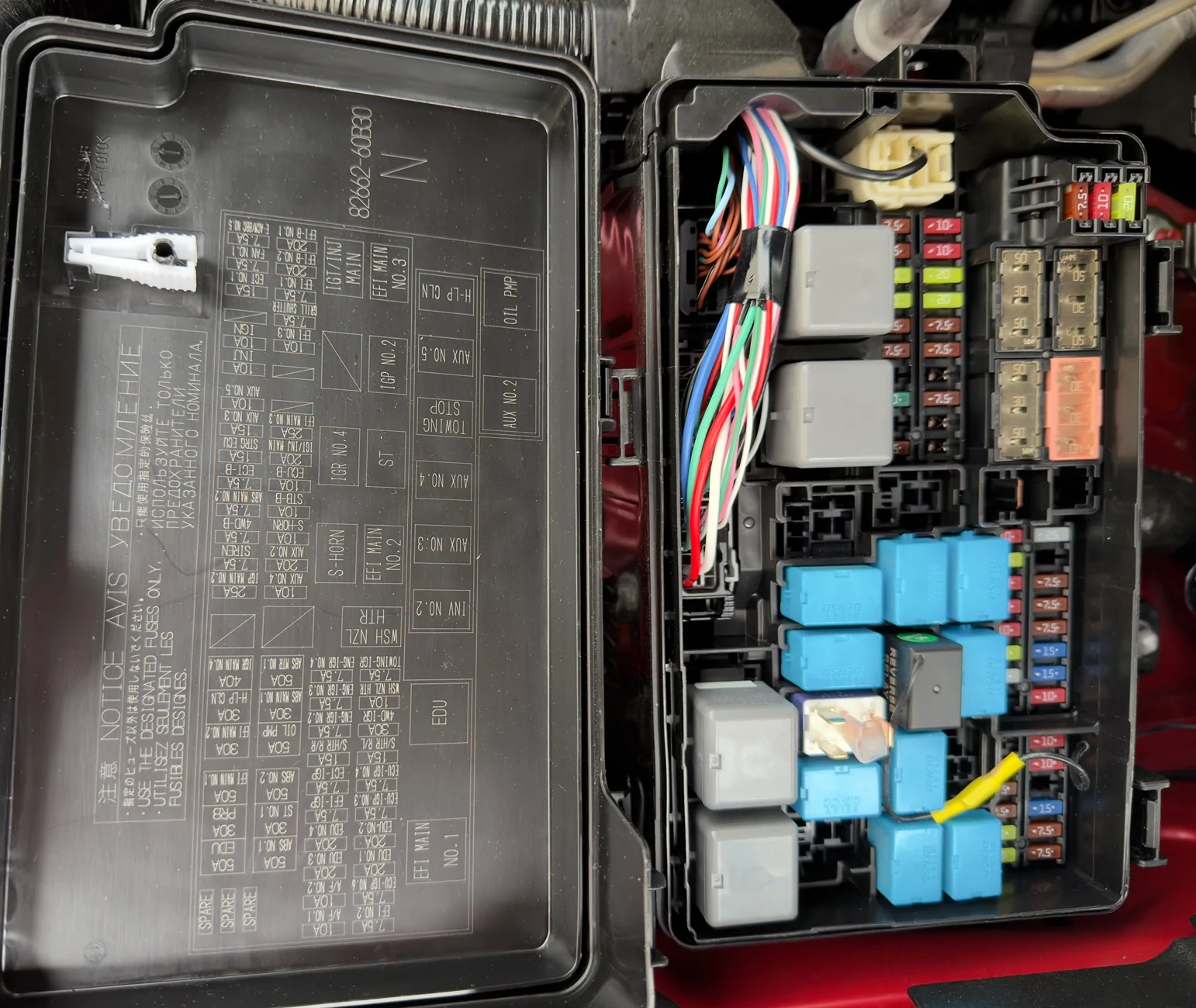

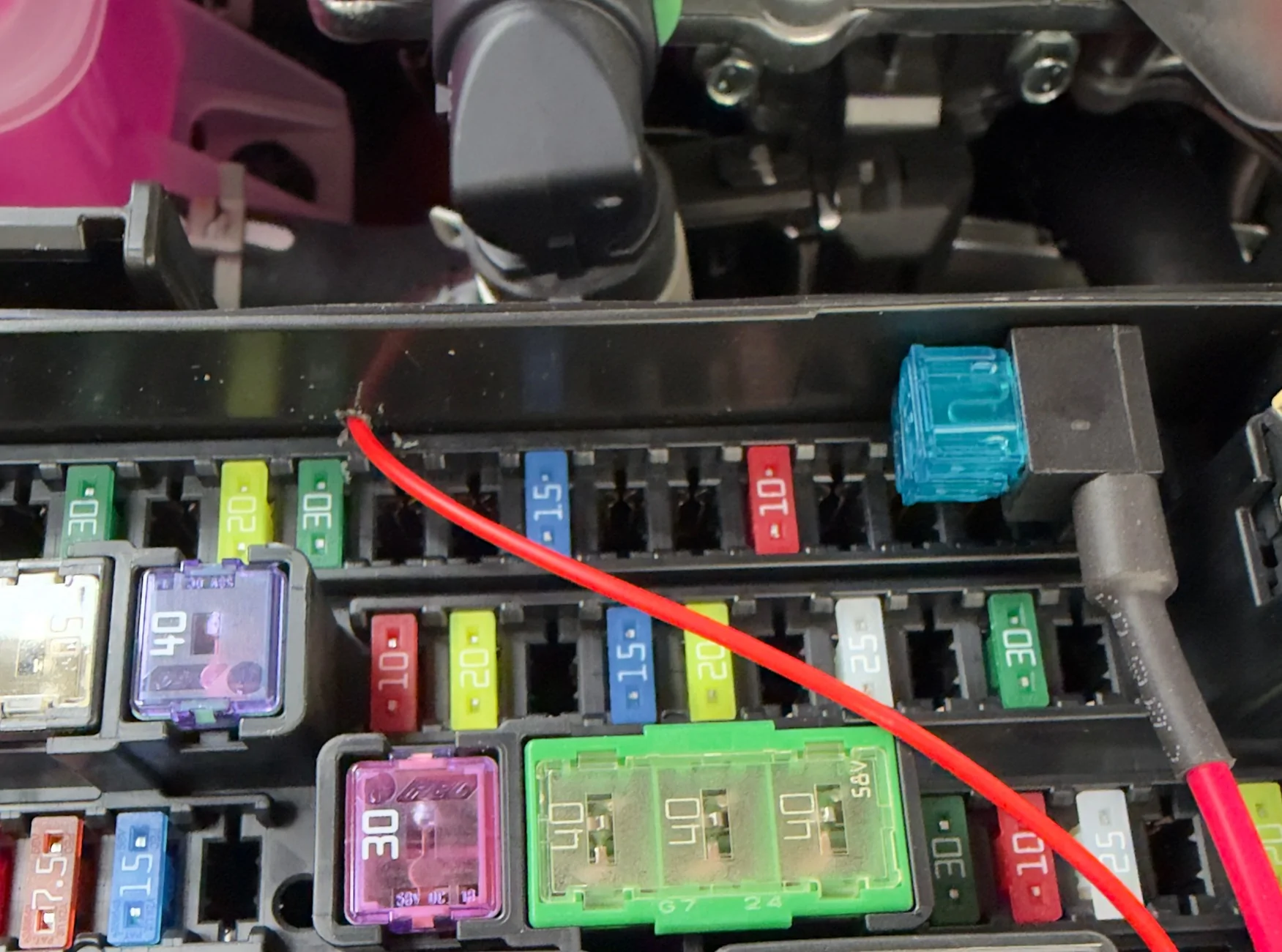

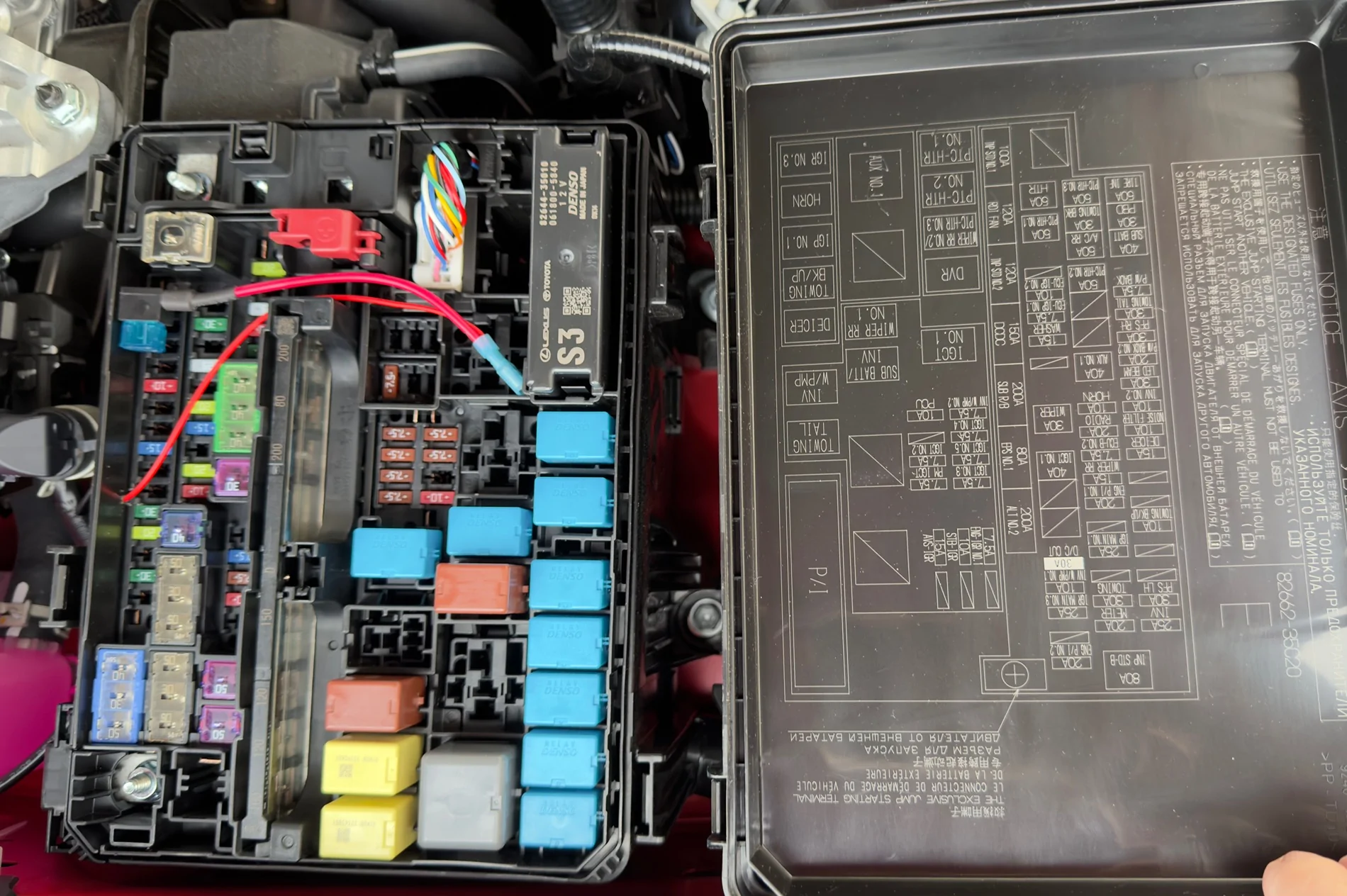

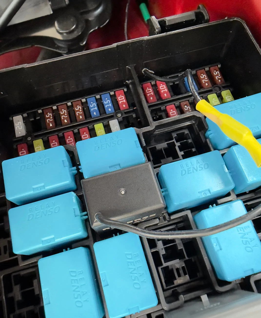

Installed wireless version on my 2026 trd orp hybrid this weekend. Power from passenger side under hood fuse box, relay on driver side fuse box. Both boxes are soft plastic, so i drilled tiny holes close to the base where fuses lie out toward rear of vehicle. Cut the+ wire and slid through then added connector once in the fuse box, same for the relay wire-relay wire is a single wire so cut and slid through tiny hole then just soldered and used heat shrink tube that sits inside the fuse box.

Is the fuse you pull the purple one?
Yes, its marked on the lid as ST
Do you have any pictures and have you had any issues with the hybrid starting stopping
No issues whatsoever, here are a few pictures. I might add a dab of silicon just for safety, but the holes i made the wires went in very snug.

What size drill bit did you use to make the hole?
