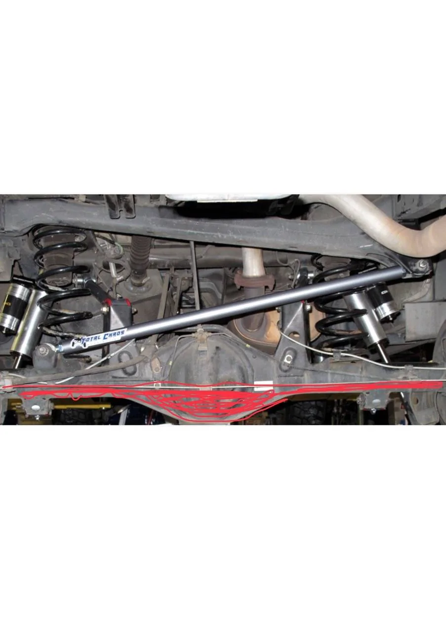

I know in all previous generations it was around 3 quarts. Perhaps this is a typo?
Vincenzo
Mar 27, 2025
407
306
Southeast
While that was a photo I found for visual reference. The housing is pretty big on the new 4Runner

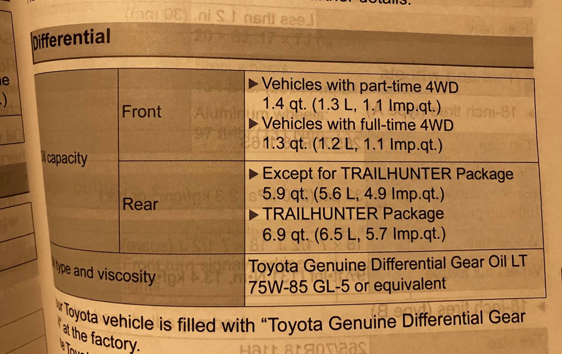

Yes I looked at the manual last night looking for an answer to see.... nevertheless I was shocked! I knew that Hybrids have the 9" ring diff, but still.... 6.9 seems like a LOT>
I've been in and around Toyota axles from 80's and 90's... my 3rd gen takes a little over 2 qt..
I know the axle on 6th gen is wider and in TH bigger diff. compared to 3rd gen, but 5.9 seems crazy!
Please anyone enlighten us here if you've changed your diff oil already. THX

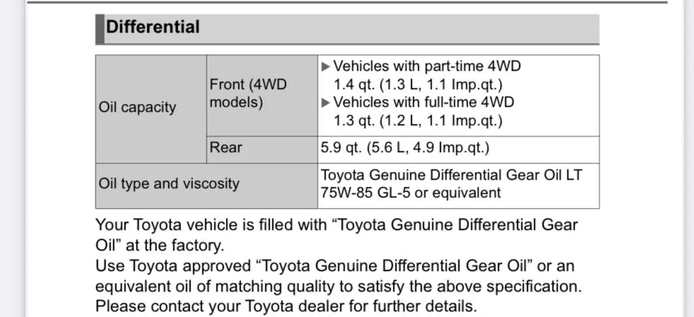

my manual print is slightly diffreent... still 6.9!!!
