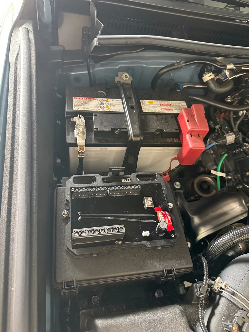

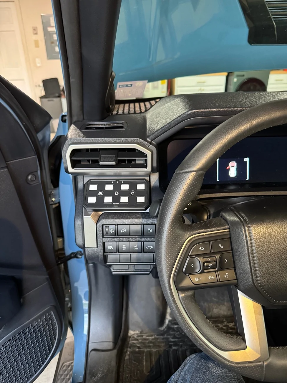

Installed the D-Switch this week. Ended up mounting it on top of the fuse box next to the to the battery. The hardest part was getting the controller wire thru the firewall.

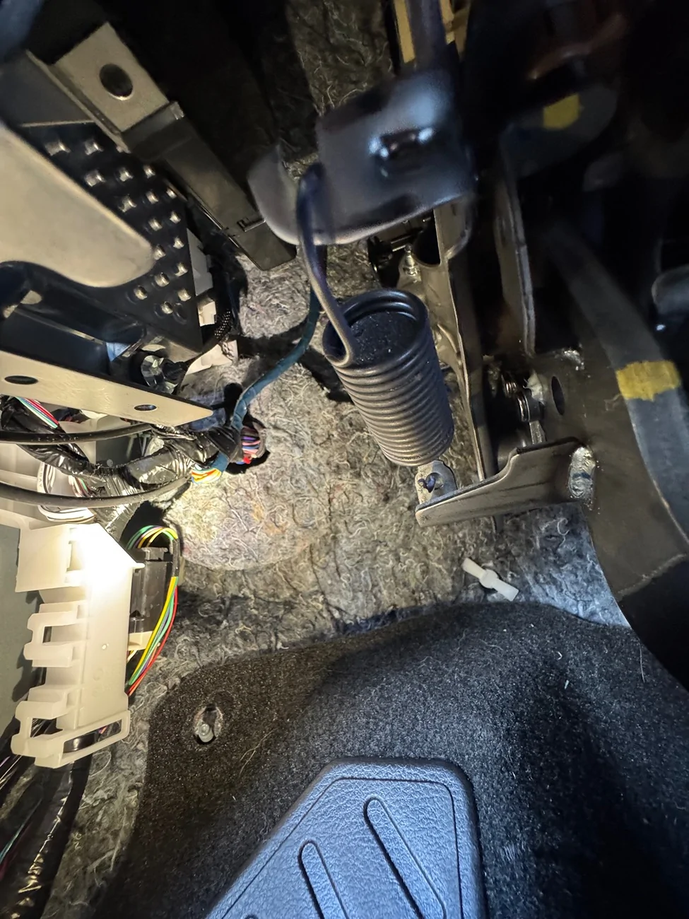

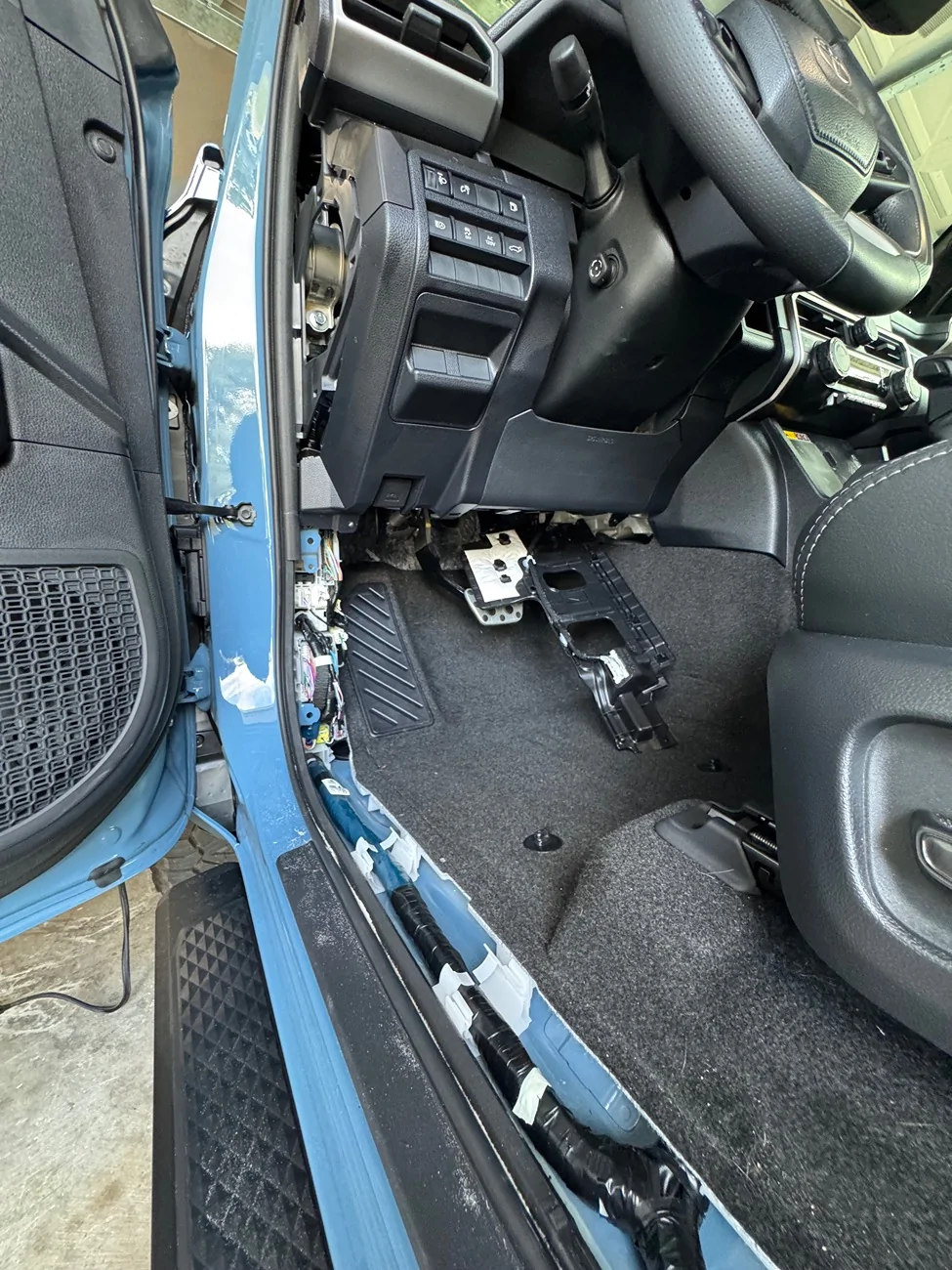

Removed a lot of the trim in the drivers side floor to make it easier to get to the pass thru on the firewall.
2025 2026 4runner 6th gen Diode Dynamics D-Switch (installed) IMG_1379

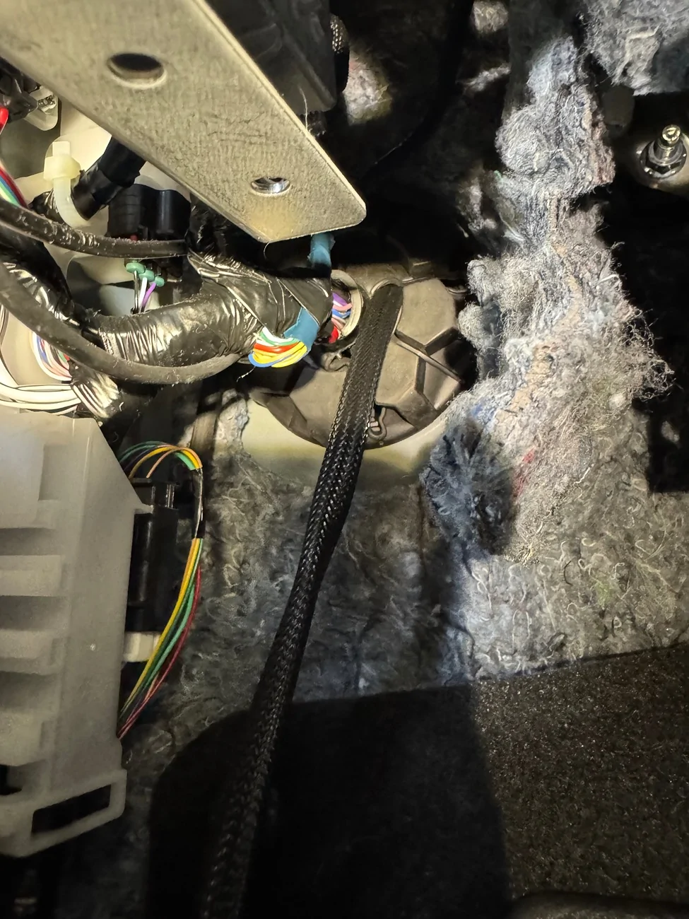

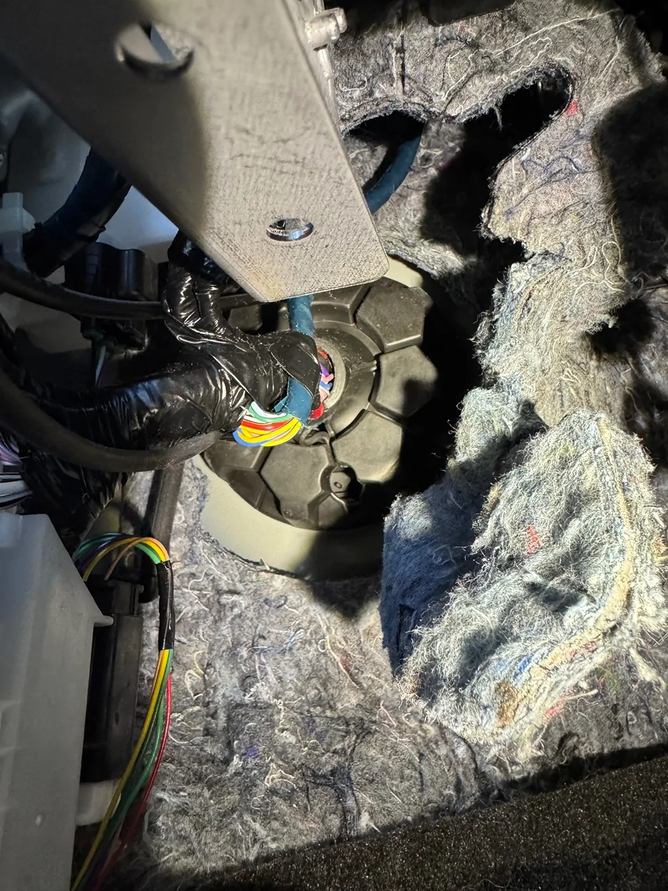

Find where the wire harness passes thru the firewall and pull back the sound deadening around it.
2025 2026 4runner 6th gen Diode Dynamics D-Switch (installed) IMG_1380

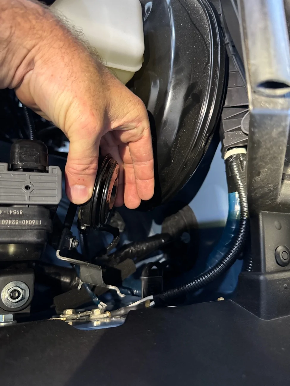

Back side of the rubber boot for the wire harness
2025 2026 4runner 6th gen Diode Dynamics D-Switch (installed) IMG_1381

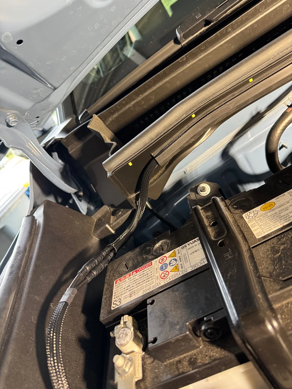

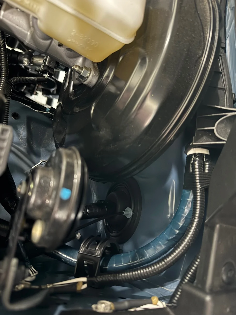

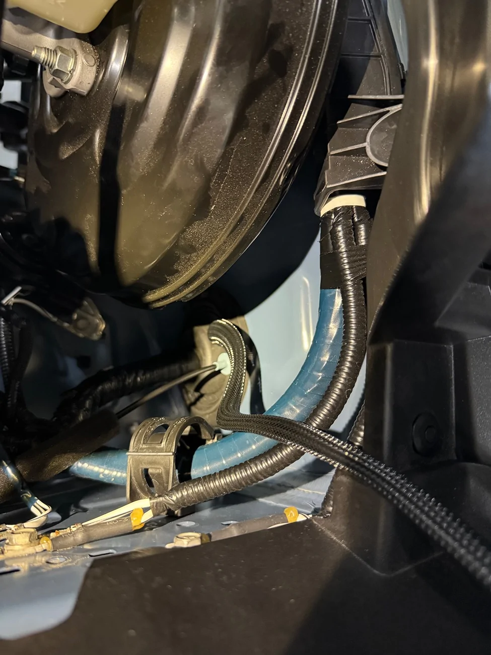

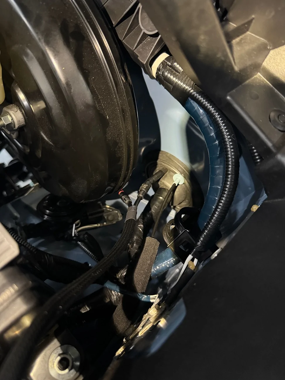

Other side in the engine bay. I've seen a lot of videos of people pulling the side back and fishing it thru that way. Don't be lazy, find something pointy and push it thru be careful not to hit the wire harness.
2025 2026 4runner 6th gen Diode Dynamics D-Switch (installed) IMG_1382
Pro tip, un-bolt the horn to give yourself some more working space.
2025 2026 4runner 6th gen Diode Dynamics D-Switch (installed) IMG_1383
2025 2026 4runner 6th gen Diode Dynamics D-Switch (installed) IMG_1384

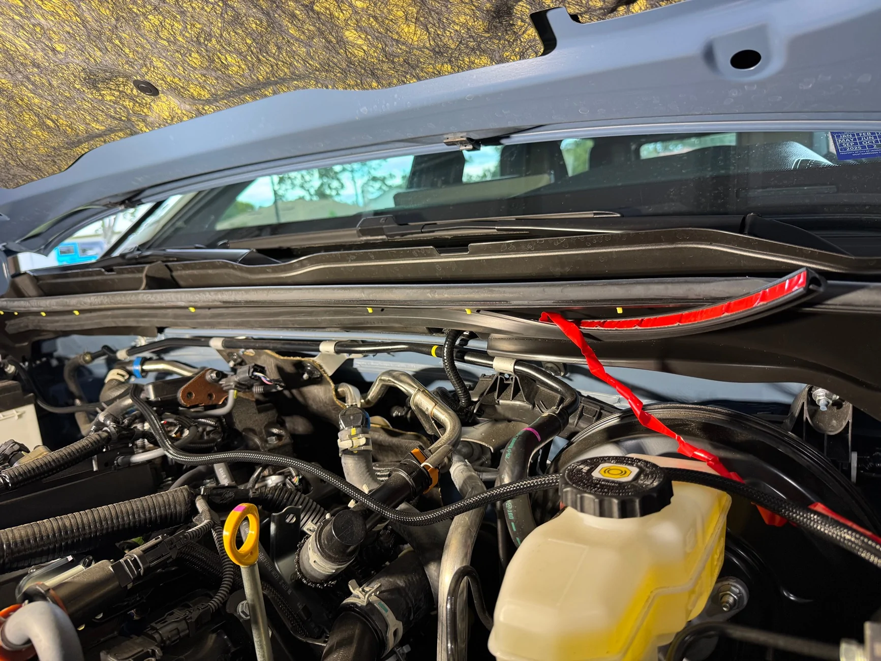

Controller wire is thru.

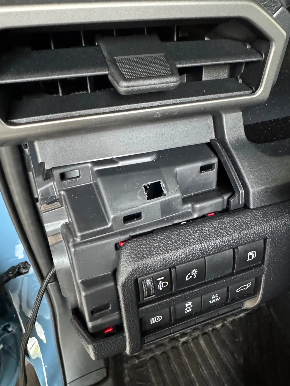

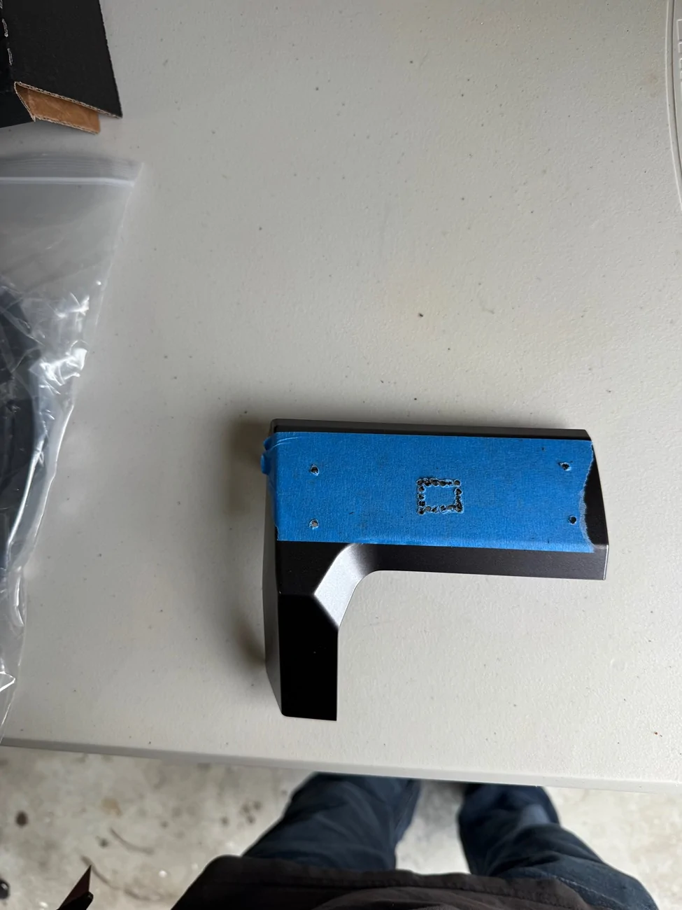

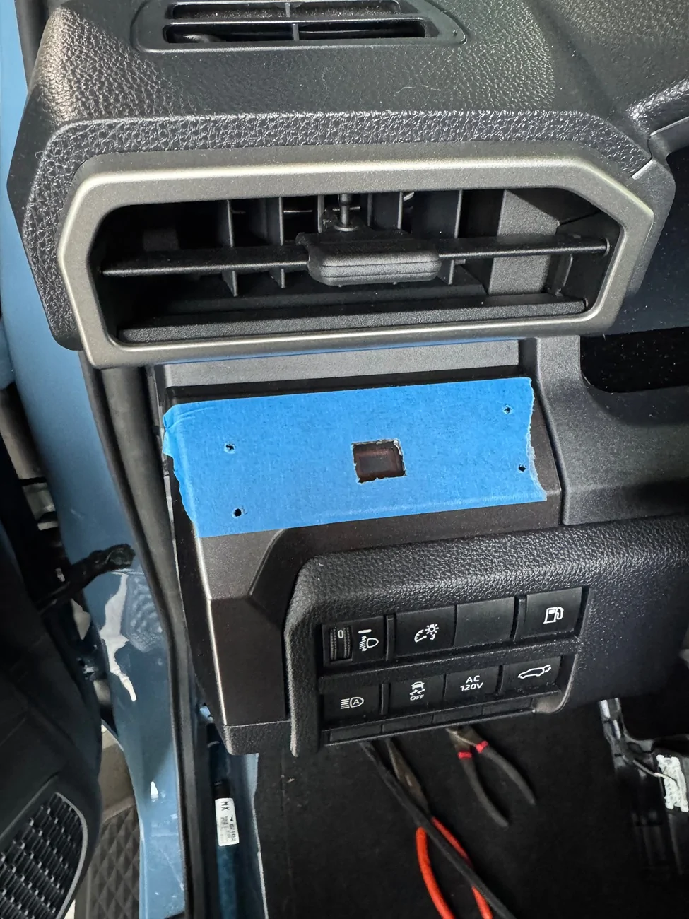

Opted to flush mount it under the drivers side vent and not use the mount that came with it.
You can use the mount to trace out where you want it on a piece of tape before drilling holes.
