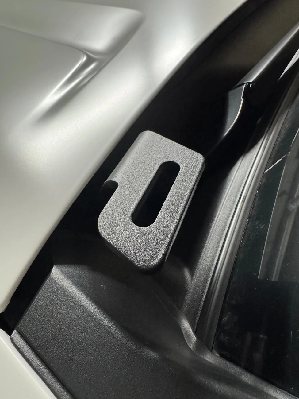

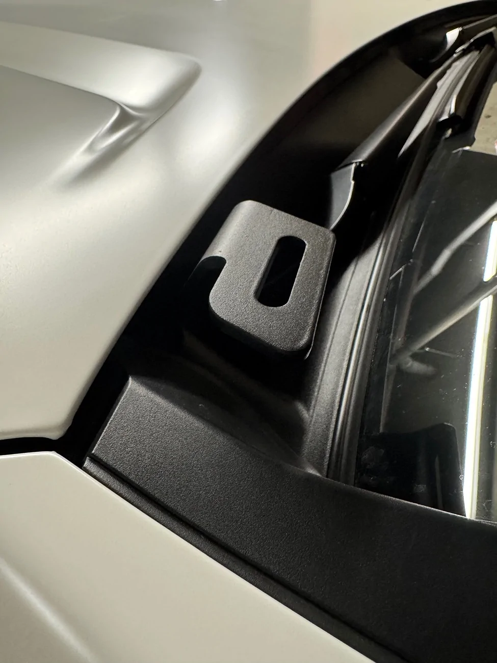

Step 3: Deleted / Removed from build
Rago GMRS / Ham Mount attached to Ditch Light Mount.
2025 2026 4runner 6th gen Diode Dynamics / Stormtrooper Lighting Build 514i2bJTEHL._AC_SL1200_
The mount will not fit as intended you would need to have it mounted towards the inside so we decided it's a no Go!

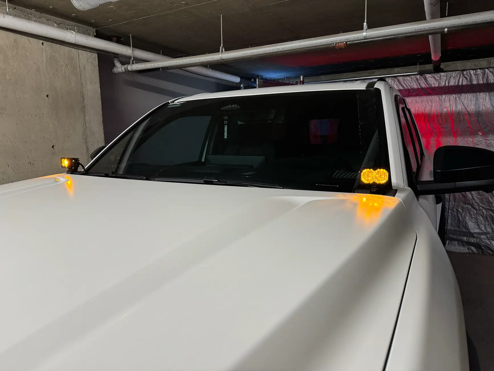

Step 4:

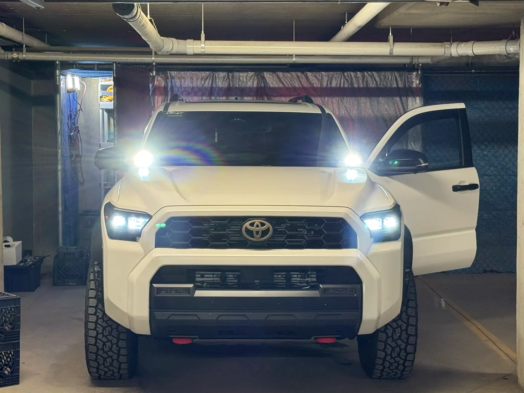

Installation of .............@DIODE DYNAMICS C2 2.0 ......... Stay Tuned this weeks completion and full review - Testing
"LIGHT UP THE ROAD"

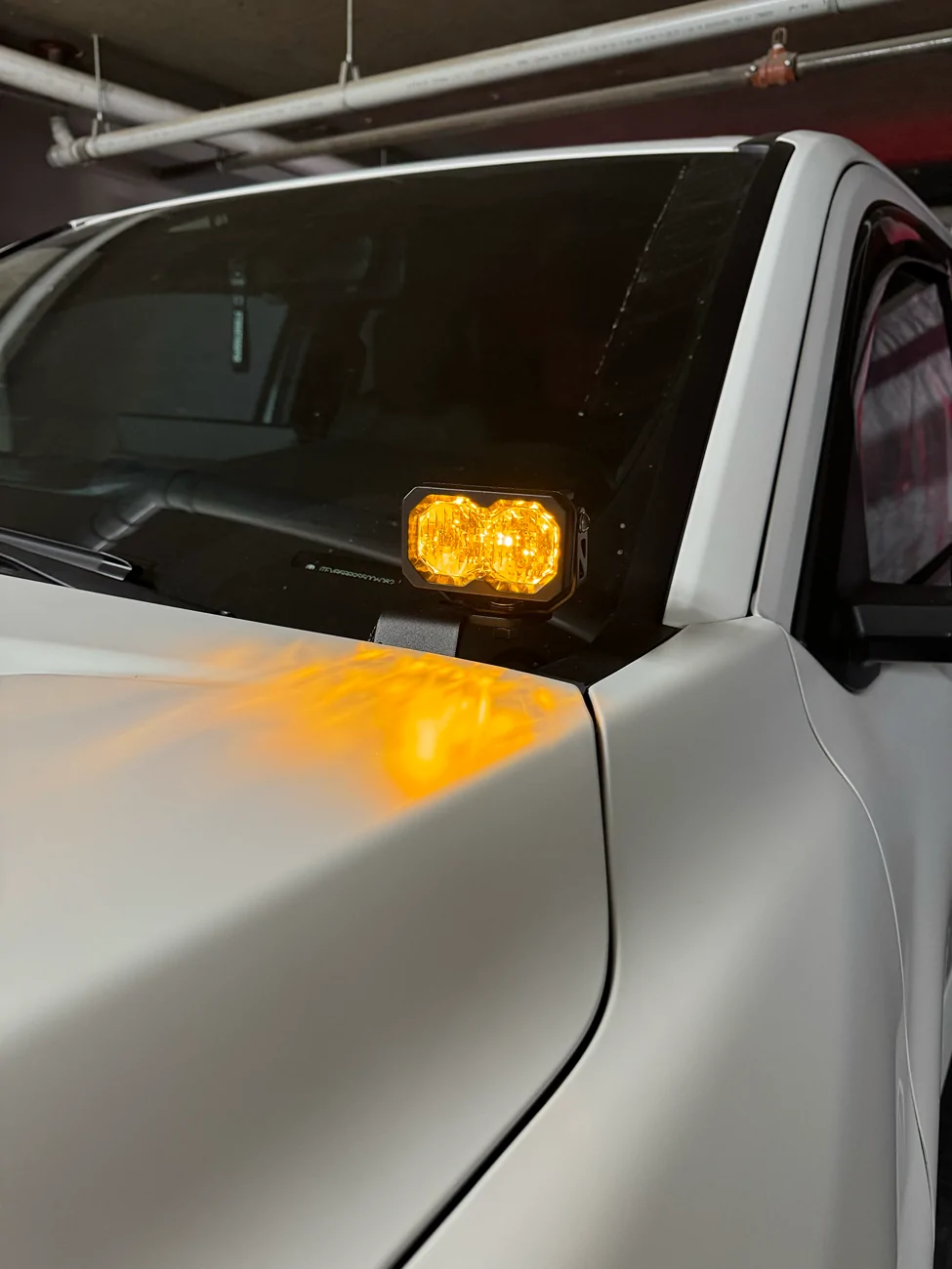

These Combo/Driving lights are Brighter than my last lightbar!
They have a dim amber mode that we set to the Aux 3 for night time coasting or hanging out at camp, then the Brightness gives way when we engage the Aux 4 and total white light that's well above any standards I have seen or used before....Clear Crisp white light that truly has no distortion or feathering at all.
Installation was very simple thanks to the wire harness we got for Diode Dynamics, the 4 pin heavy duty harness connected to the factory pigtail with ease.
Keeping the installation clean with additional loom and routing the cables via the engine harness for a stealth clean look.
We will add more night time images and outside performance shortly....
***Our next will be the C1R+BRAKE by @Diode Dynamics follow this review as we continue our @Diode Dynamics light builds......

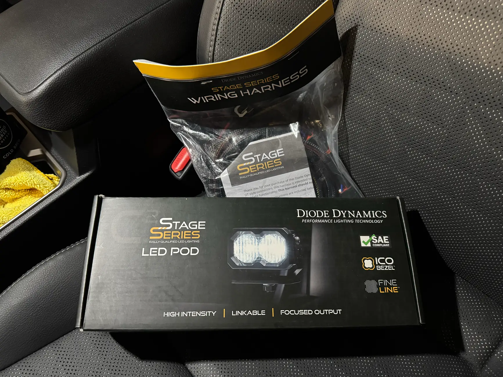

The kit we will be installing is @Diode Dynamics C@ 2.0 Driving Combo Pro Series with the wire harness kit that includes pigtail connections.

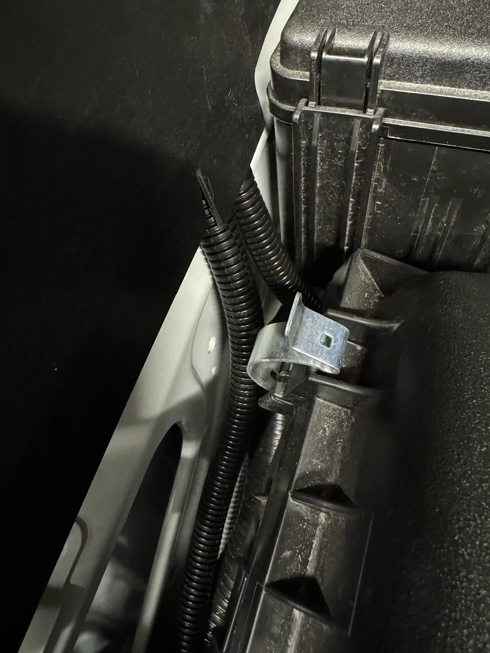

Routing the wires on the passenger side behind the plastic inner fender guard.
2025 2026 4runner 6th gen Diode Dynamics / Stormtrooper Lighting Build tempImageLZErwi

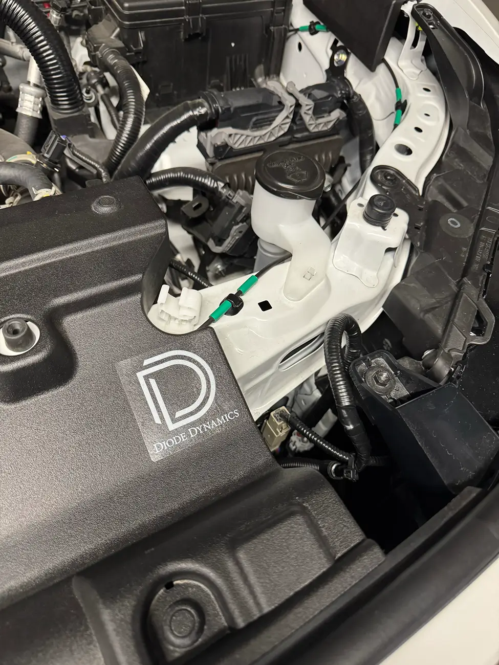

Loomed the light cables.
2025 2026 4runner 6th gen Diode Dynamics / Stormtrooper Lighting Build tempImagekYsAnT
The main light cables routed via the existing engine cables for a factory clean look.
2025 2026 4runner 6th gen Diode Dynamics / Stormtrooper Lighting Build tempImagemYXe5

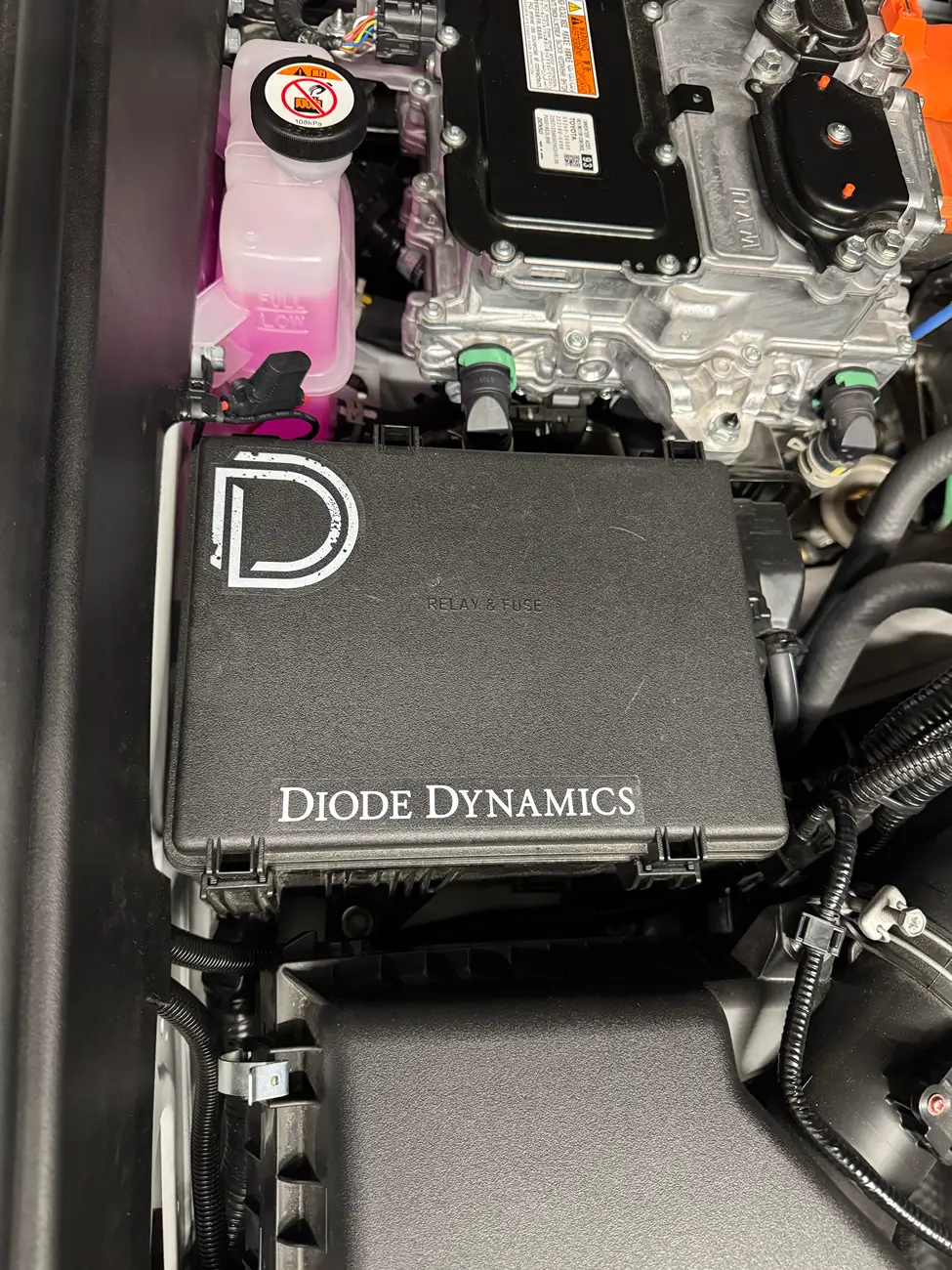

2025 2026 4runner 6th gen Diode Dynamics / Stormtrooper Lighting Build tempImageSIDtiH
Fuse box used.

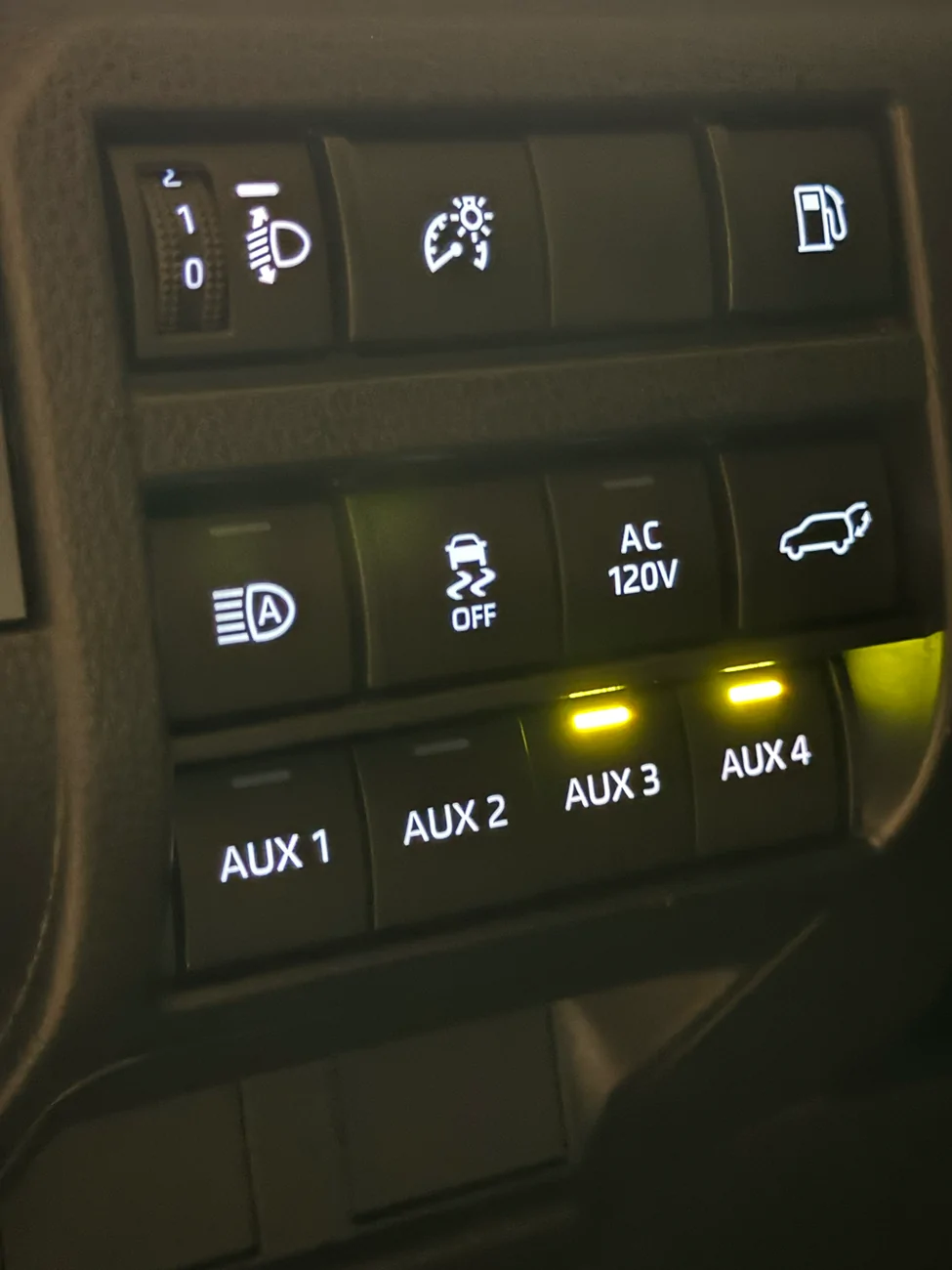

Aux 3 is to be used for the backlighted amber (Black pigtail).
2025 2026 4runner 6th gen Diode Dynamics / Stormtrooper Lighting Build tempImage61GeQc
2025 2026 4runner 6th gen Diode Dynamics / Stormtrooper Lighting Build tempImageVx9PzT
2025 2026 4runner 6th gen Diode Dynamics / Stormtrooper Lighting Build tempImageWg38nk
2025 2026 4runner 6th gen Diode Dynamics / Stormtrooper Lighting Build tempImageQqS6Wd
Aux 4 used to power main lighting of th eC2 2.0 lights.

How did you wire/use both aux 3 & 4 with only one pigtail adapter provided by DD?

Will do guy's just on vacation. please see images in post for now.
Used the passenger side fuse box and ran power via the rear inlet.
Ground wire to the body.
Pigtails has multiple power feeds and a ground each feed is a separate AUX button.

Inspired by your build.
Use the Toyota OEM pigtail it has 4 leads each lead offers a separate AUX, in our case we are using the lead that offers Aux 3 & Aux 4
Use Aux 3 amber light output
and Aux 4 Main output
or use the white from pigtail as its ignition on (Amber lights on while vehicle is on)
