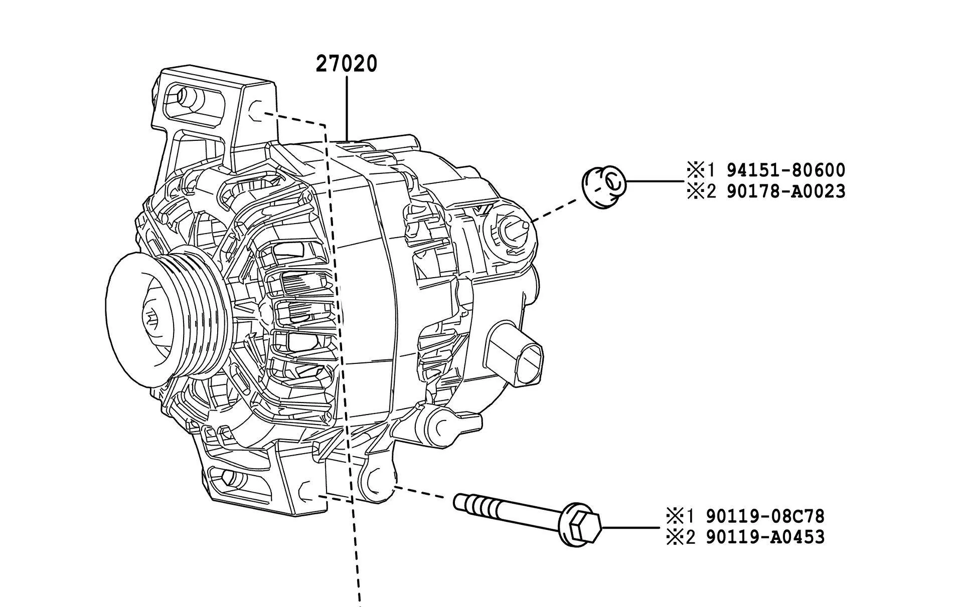

The recent review of the 4Runner by Car Care Nut Mechanic mentioned that certain hybrid 4Runners (specifically, those with the pre-wired AUX port switches) include a traditional alternator that can serve as a backup in the event the hybrid motor can't charge the battery, and the vehicle essentially reverts to a non-hybrid.
If that's true, and the addition of an alternator provides increased redundancy/reliability, then it seems like a worthwhile upgrade to consider.
My questions are:
  • Is the wiring for an alternator present on all 4Runners?
  • Can you simply order and install an OEM alternator like this?
  • Would the combined motor + alternator = higher amperage?
  • Would an aftermarket high-output alternator be even better?
