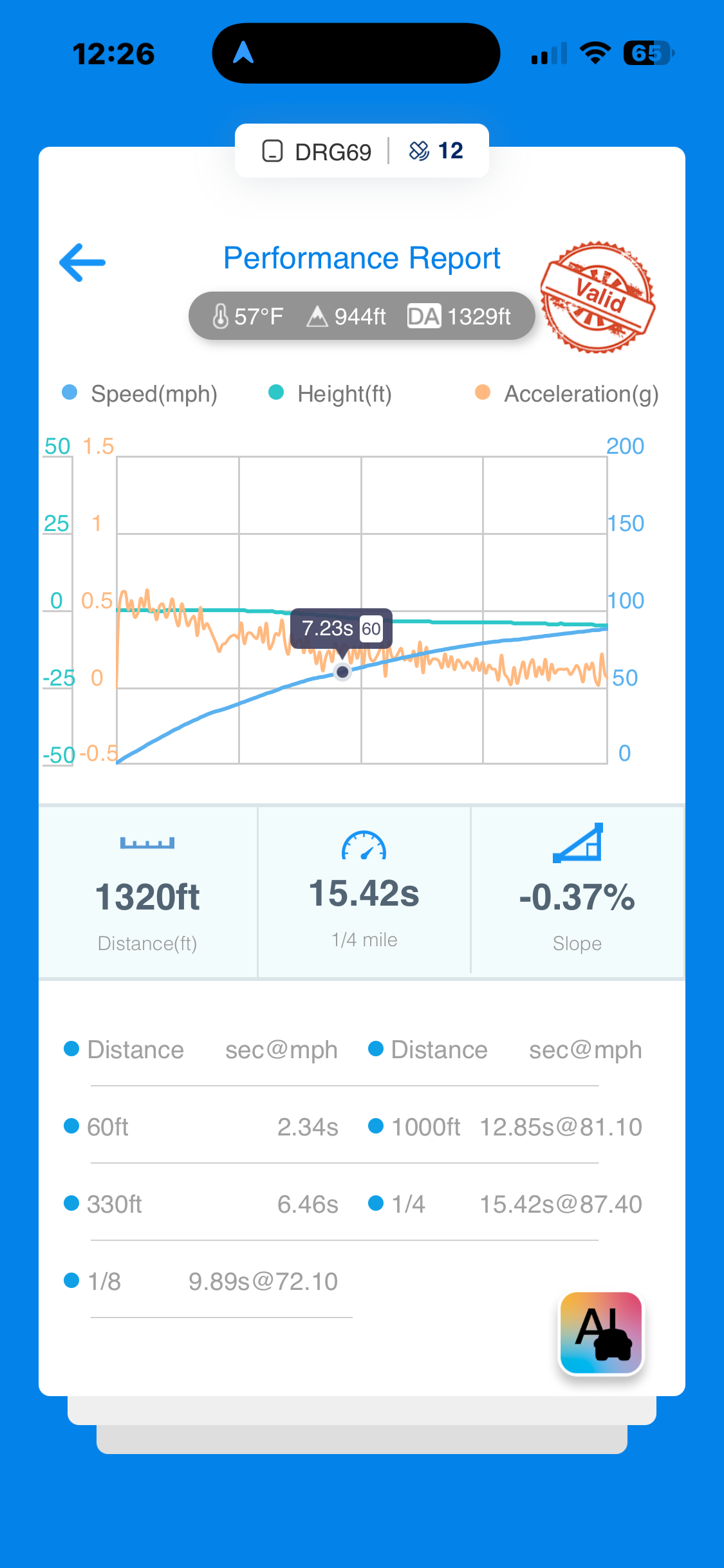

I wanted a baseline. I own a Dragy. It's time to time some 0-60/quarter mile runs. What's the point of tuning if you're not faster, am I right? For Dragy timing purposes, I used the same guidelines: The same road, same direction, same full tank of 93 octane(this is all I've ever used), and no one or anything else in the 4Runner so the weight was as close to the same. I launched the same way: Sport mode, traction control off, mash brake, mash accelerator, release brake when RPM's get to 2500. I did four runs over the course of 30 minutes or so, driving around a bit to cool things down between each. This is a combination of 0-60 and quarter mile PRIOR to tuning.

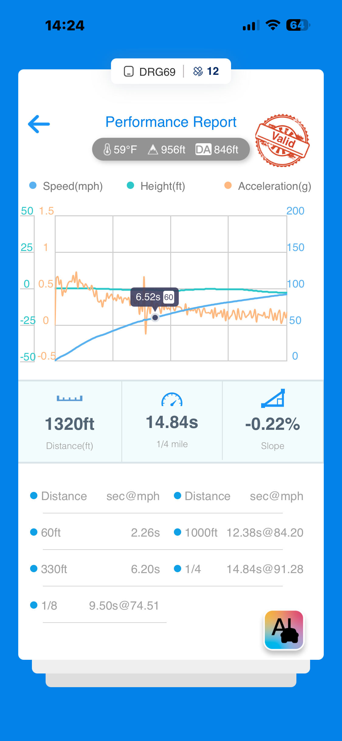

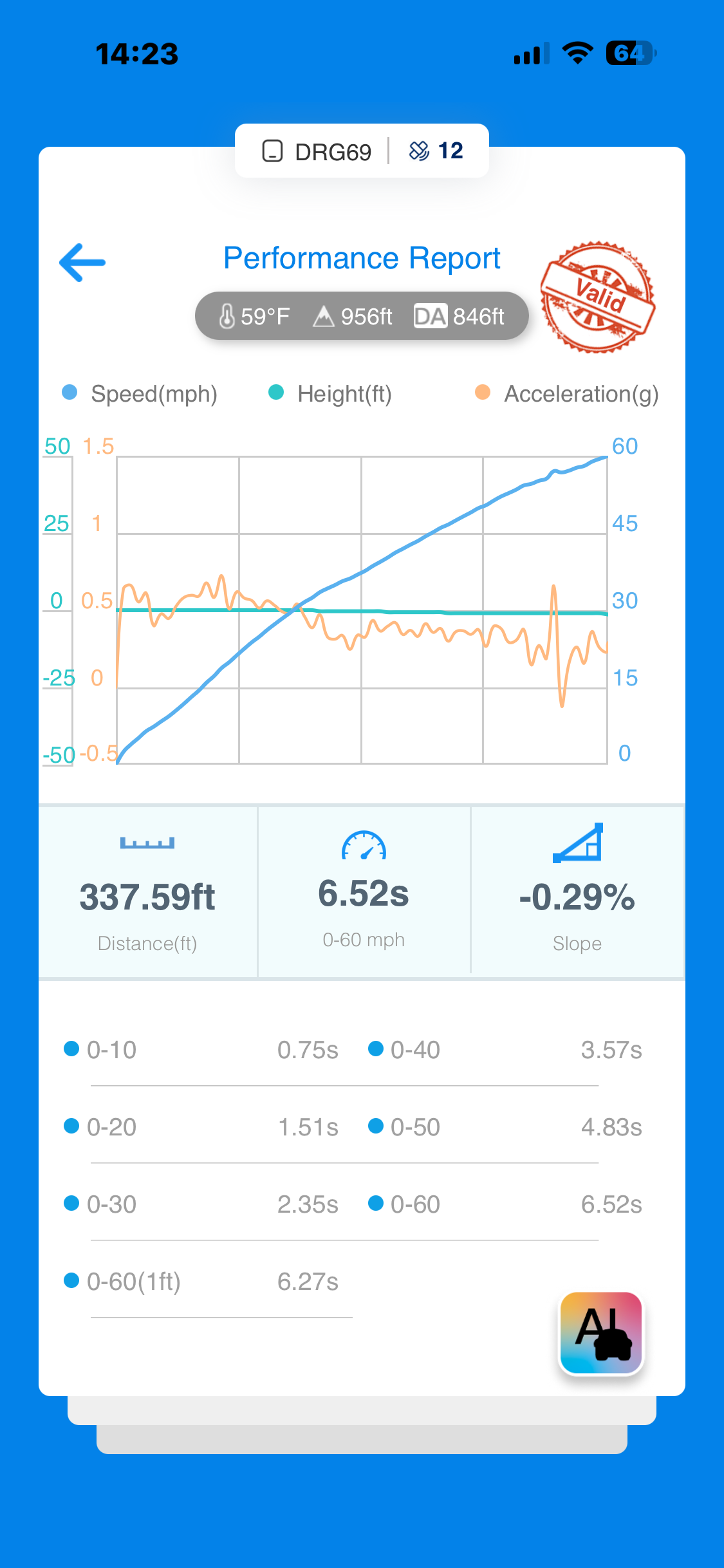

Oh, and the performance difference Dragy results. They speak for themselves:
2025 4runner 6th gen CAMTuning/Cobb Accessport Tuning and Performance Review 0dlQahs
2025 4runner 6th gen CAMTuning/Cobb Accessport Tuning and Performance Review AjX7rGE
