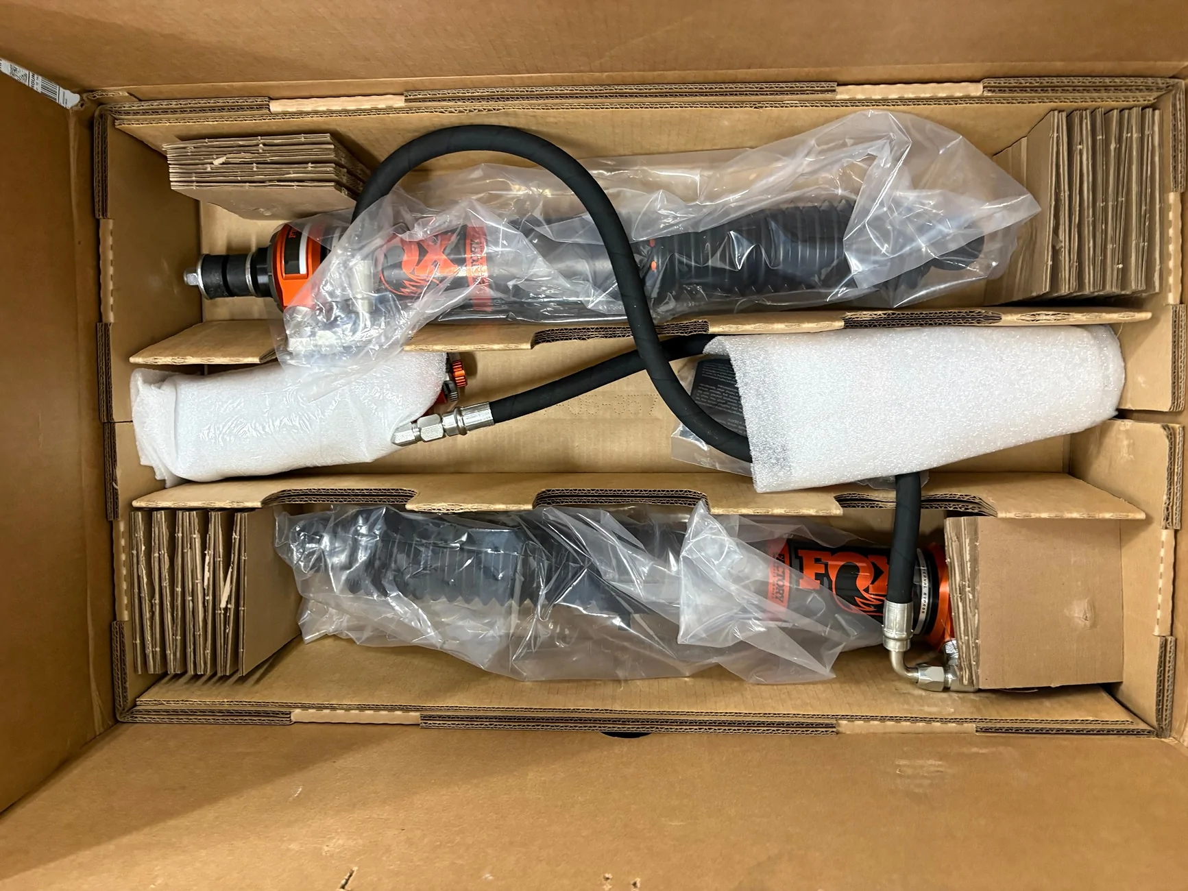

  1. Fox 3.2 coilovers/shocks and to-be-determined rear springs - arguably overkill, but I will be spending quite a bit of time on rough logging roads at moderate speeds and these seem like the best there is for that use case
  2. UCAs of an undetermined type - this is an area where my knowledge is lacking. I’m thinking a tubular arm with a bushing and uniball is the way to go, but does that leave performance on the table compared to a Heim Joint? Unclear to me what the practical advantage is: does it let me tune behavior more, or just align easier to factory specs? Do billet arms have a practical strength advantage?
Other suspension questions:
  • Is there anything else I should upgrade while I’m down there and why? I don’t want to handicap the 3.2s by missing an obvious upgrade.
  • The 3.2 rears aren’t described as ”extended travel” so I‘m assuming I won’t get any more rear travel. Could I possibly be better off going with one of the 2.5 Fox/Icon/King kits that’s specified as extended travel and upgrading rear links etc? I plan on DIYing this so I’m hesitant to go that direction but I’m interested to hear what the pros/cons would be.

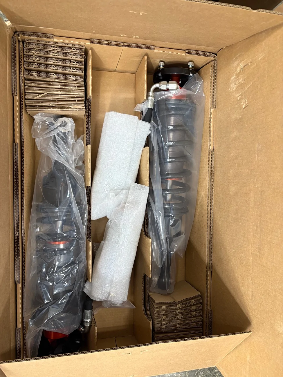

Ordered the 3.2s, OME UCAs, and 17” Fifteen52 Turbomac HDs w/ E-rated 285/70r17 Duratracs.
