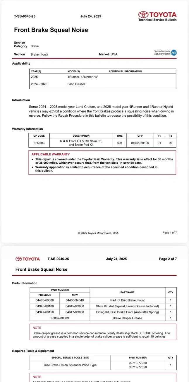

It’s not a recall but I think technical service bulletin. Someone posted in the fb channel the number. My dealer already ordered the parts to fix this but it’s on back order. It’s new pads, and like 2 other parts I think no rotors though.

TRD PRO, just started at 1800 miles, very minor and brief but it’s a start. Already contacted dealer about fix under TSB.

I have a trailhunter, have the squealing brakes (started periodically around 1,500 miles, now horrible at 3,500) and a shaking/shuttering in the steering column.
Getting the brakes fixed via the TSB, and the dealership is doing tests on Thursday (request from Toyota corporate) to determine the cause and fix for the steering column issue. There was one person with an SR5 that wrote about the steering column issue, the dealership is using that as a starting point (I believe that person had the column completely replaced).

Here’s the TSB - I’m taking mine in next week to be the first one to get the fix at my dealer.
2025 2026 4runner 6th gen Brakes squeal horribly backing out of driveway each day IMG_1832
