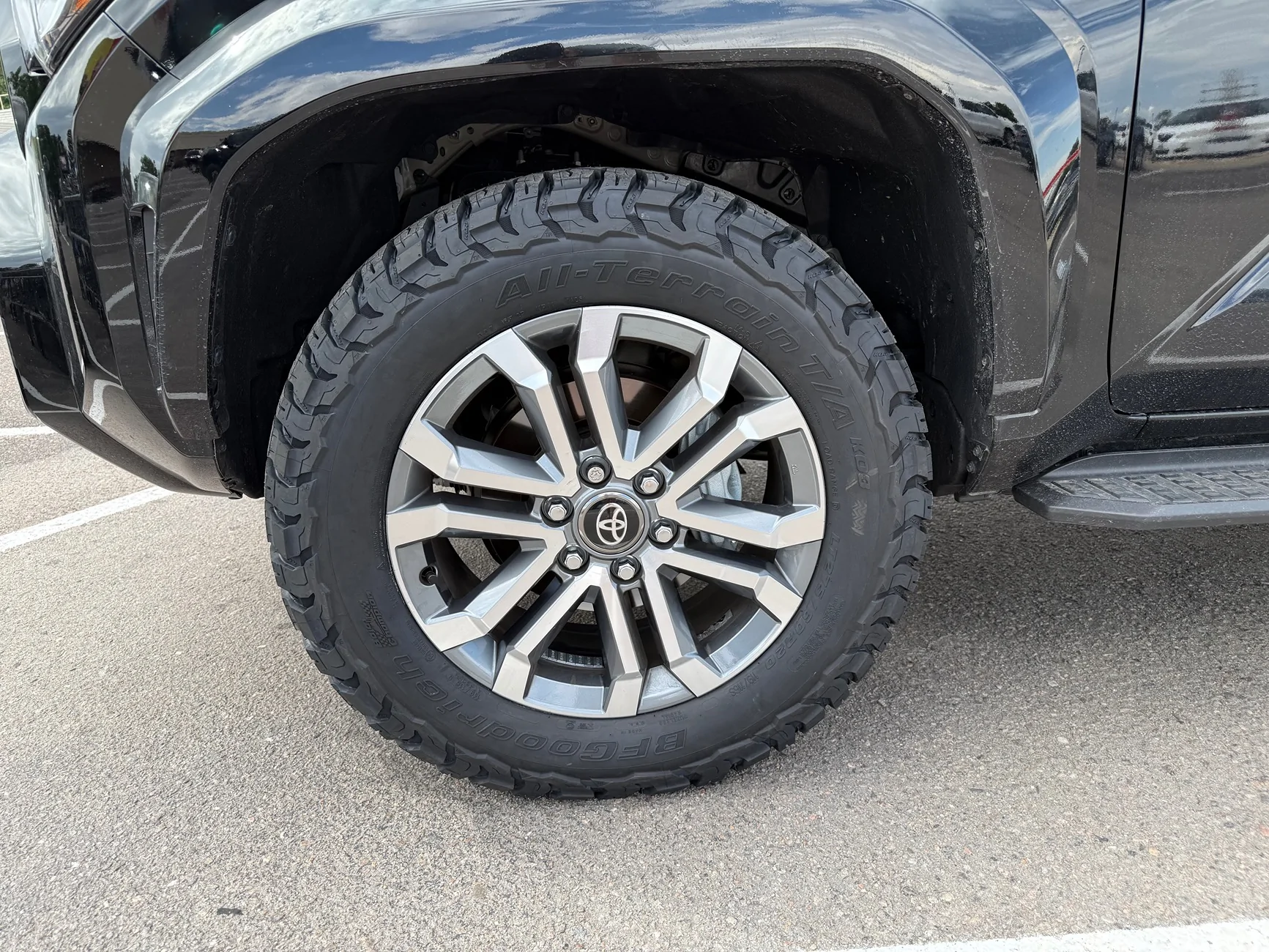

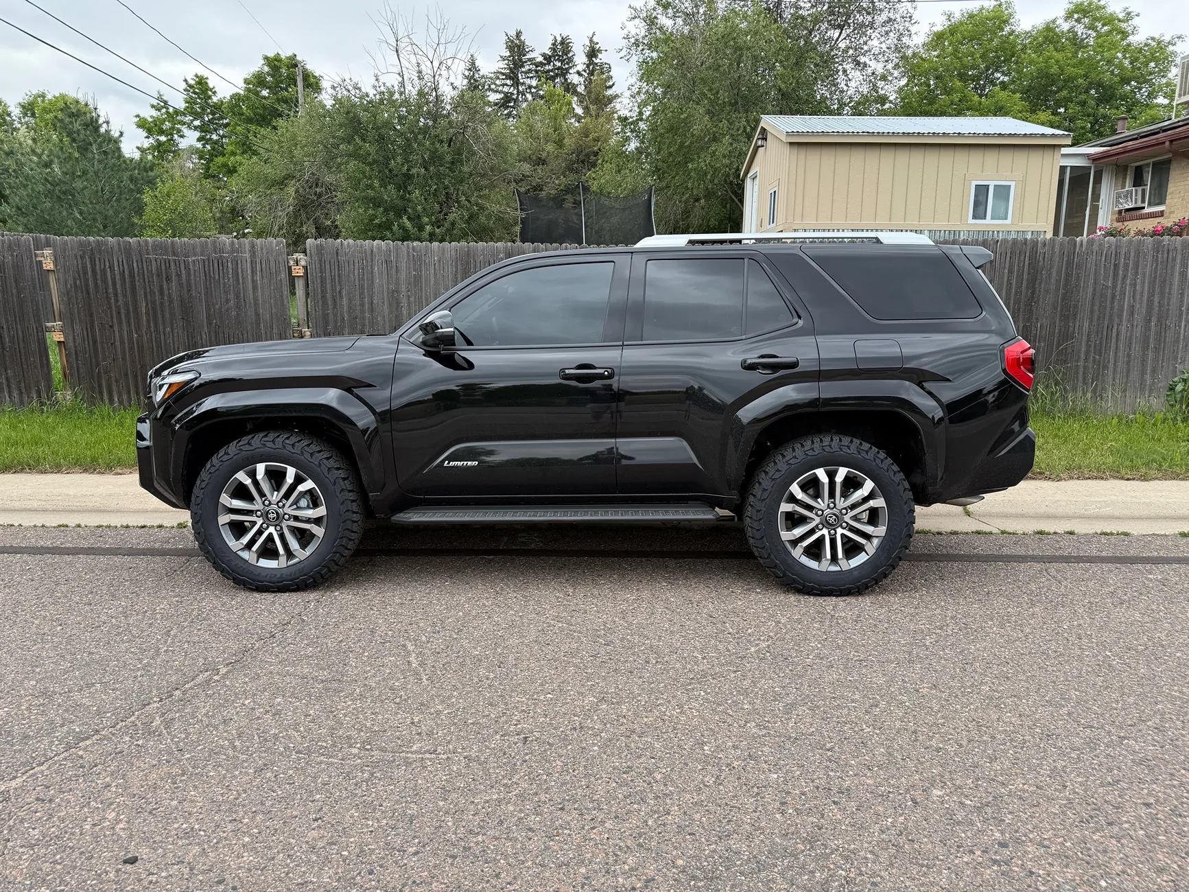

I have to ask. Did you go with the 275 55 20 ? Did you consider a 265 60 20 for more sidewall? I'm interested in the same thing and am curious if you have taken a leap.
Hobb3s
Jan 9, 2025
88
84
2012 Jeep Grand Cherokee
i put a 275 60 20 on my for a little. no rubbing was a true 33in
i ended up taking it off because of the mileage associated with the d load tire. but it was sweet
