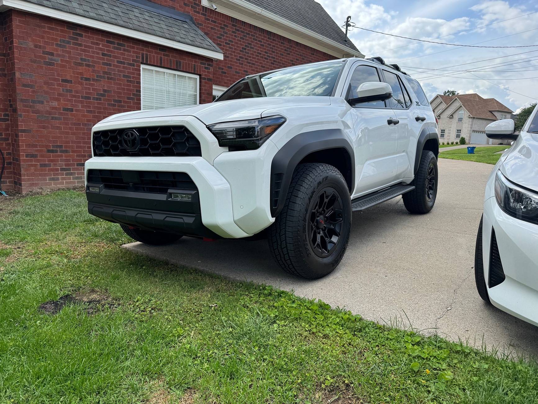

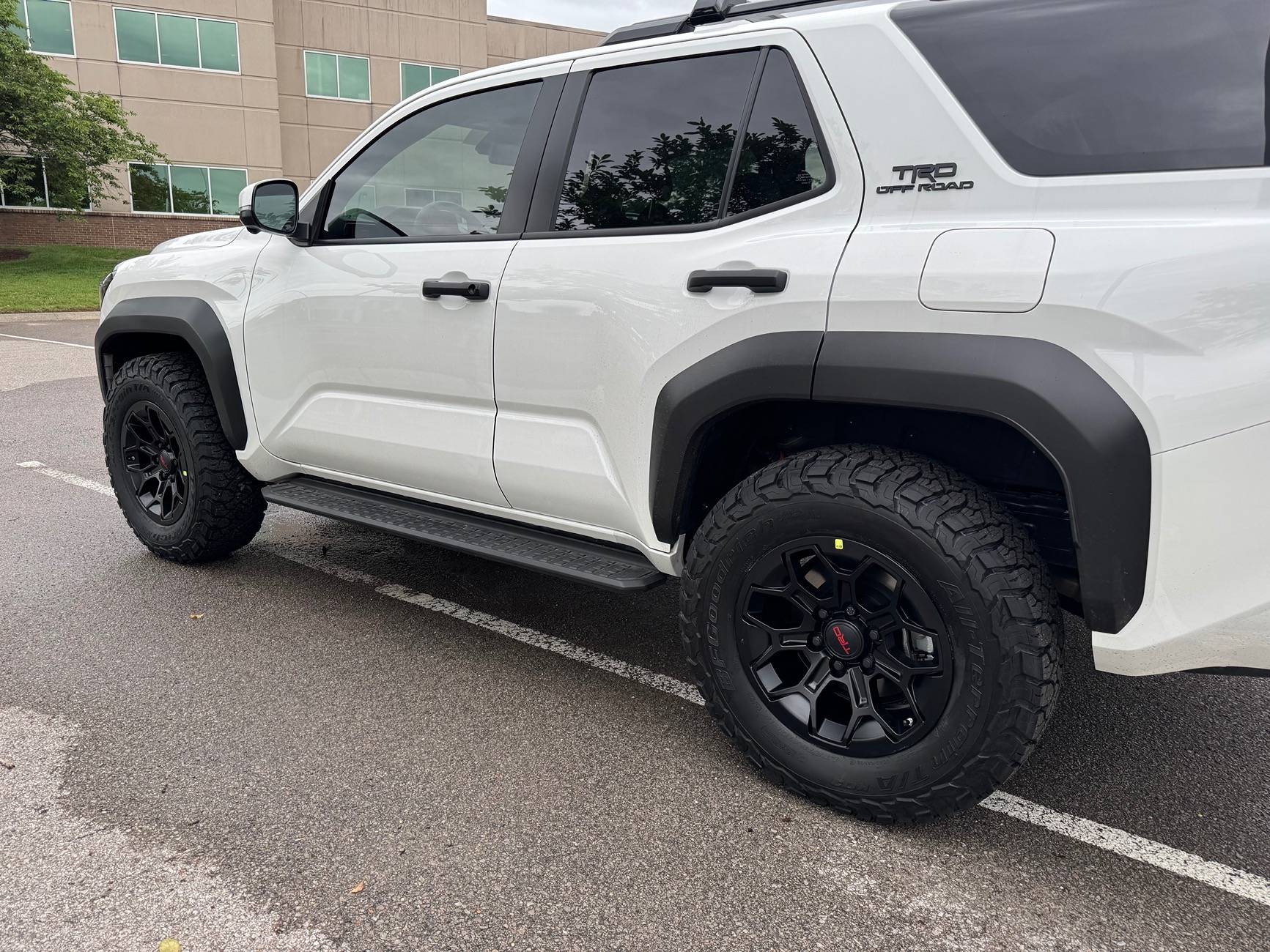

I had some 275/70r18 KO3’s put on my ORP with the TRD Pro OEM wheels. No rubbing at all from what I can tell on normal streets or at full lock. It’ll be a few weeks before I can get it on anything besides pavement.

Looks great with the TRD Pro wheels! Does it currently have a leveling kit or other lift installed? If so, what did you go with? i apologize if this has already been asked and answered….
Hey! No leveling kit or anything as it sat here with zero rubbing. Unfortunately I had some serious balancing issues with the KO3s. Discount Tire tried to correct but they shook the entire wheel at highway speeds. I have the stock Falkens back on now. They don’t look nearly as aggressive but they aren’t horrible and ride perfectly. I’m going to give the 275/70r18 another shot soon, I just couldn’t keep going back to have them tweaked right now.

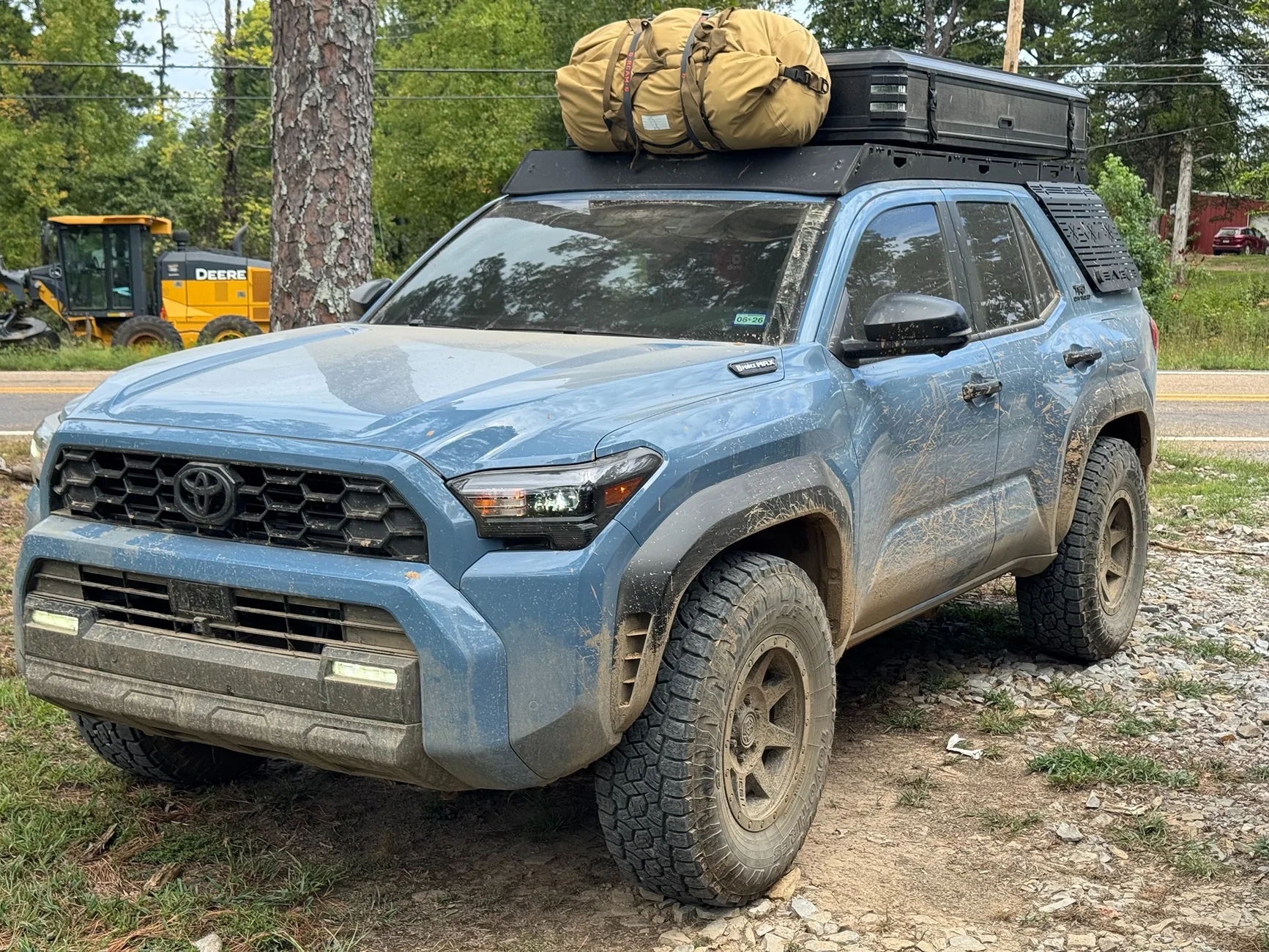

2025 4runner 6th gen Will 34” tires fit on 4R TRD OR without a lift or spacers? IMG_0477
+25 offset wheels needed to fit, removed the back bolted on crash plates. no rub at all.
Toyo OC AT3 285/75/17 - 33.8 in overall
