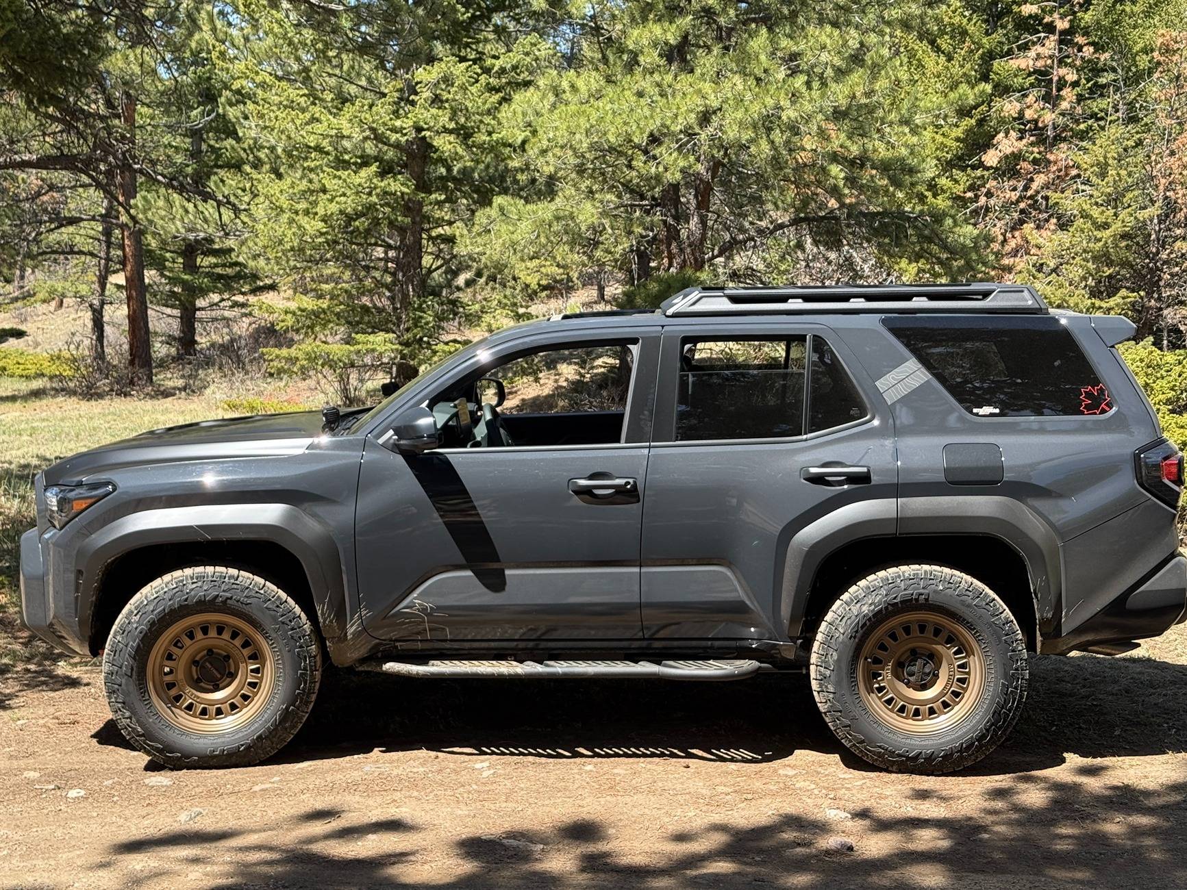

+25 offset wheels needed to fit, removed the back bolted on crash plates. no rub at all.
Toyo OC AT3 285/75/17 - 33.8 in overall

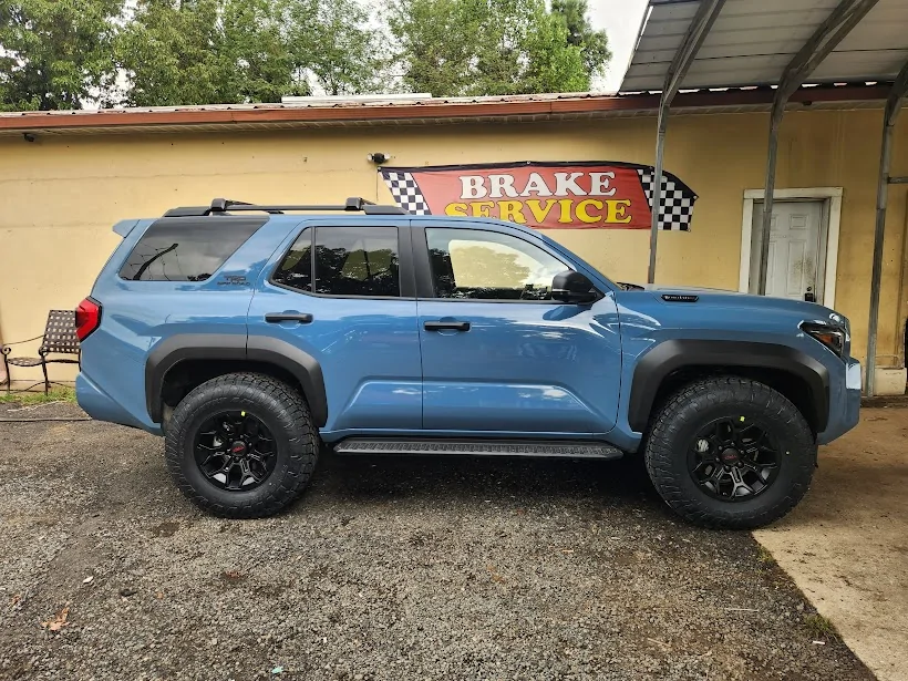

yep - will be removing the crash plate this afternoon. My Toyos are supposed to be .1" smaller diameter than yours.
