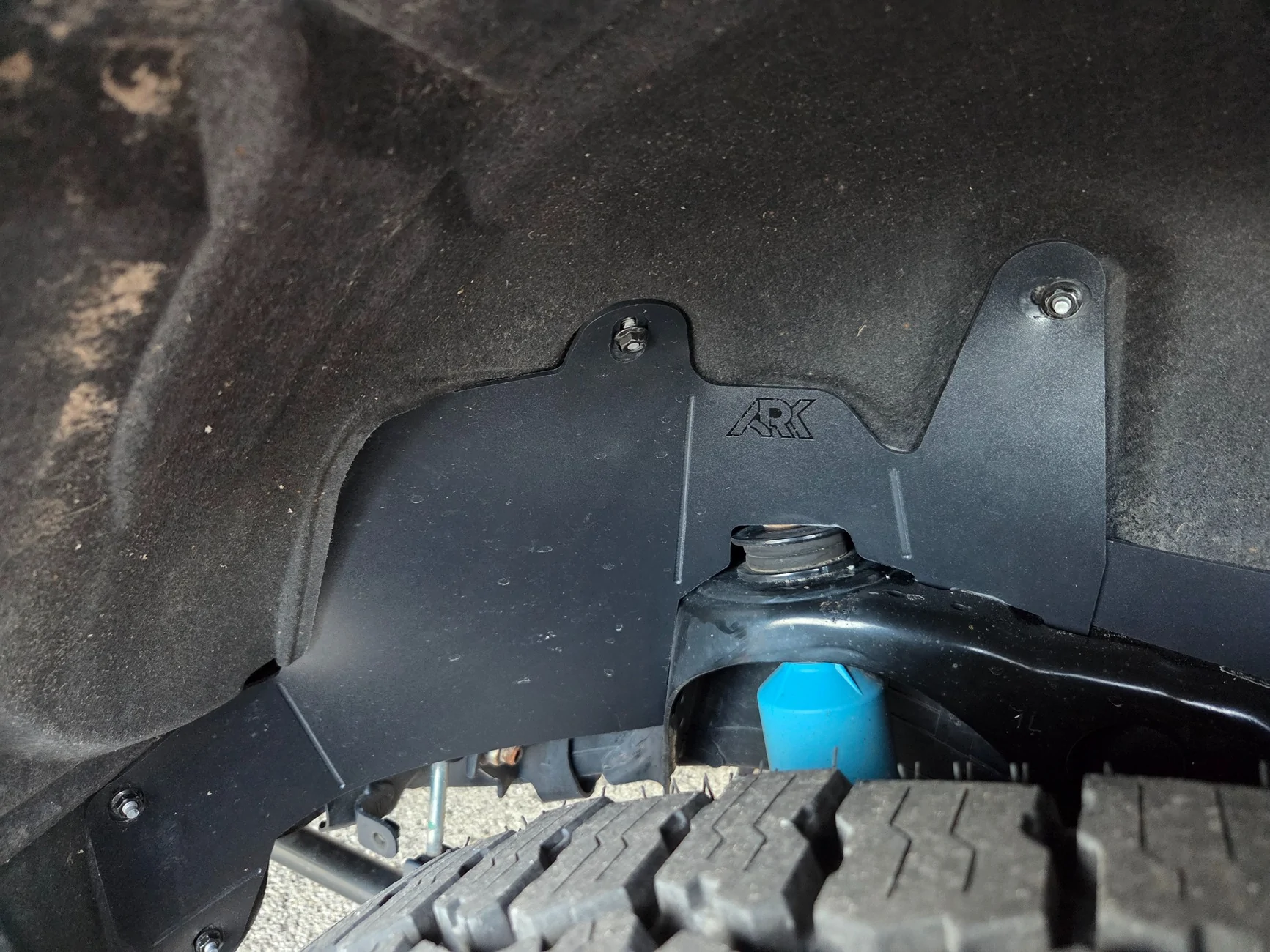

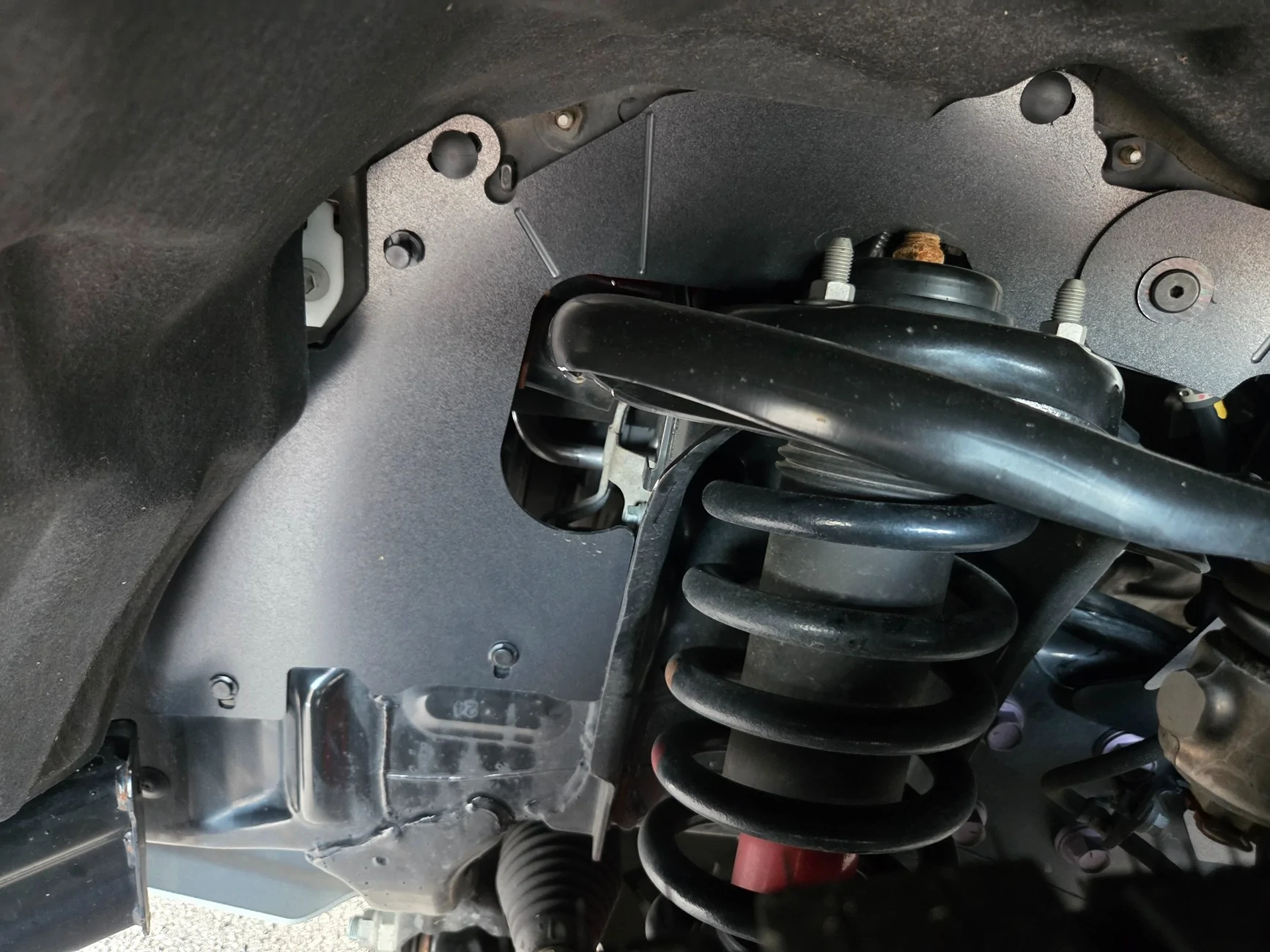

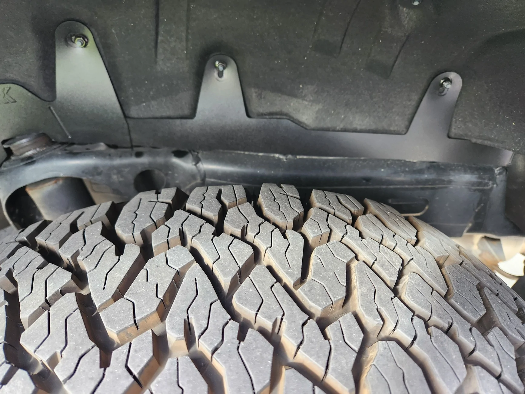

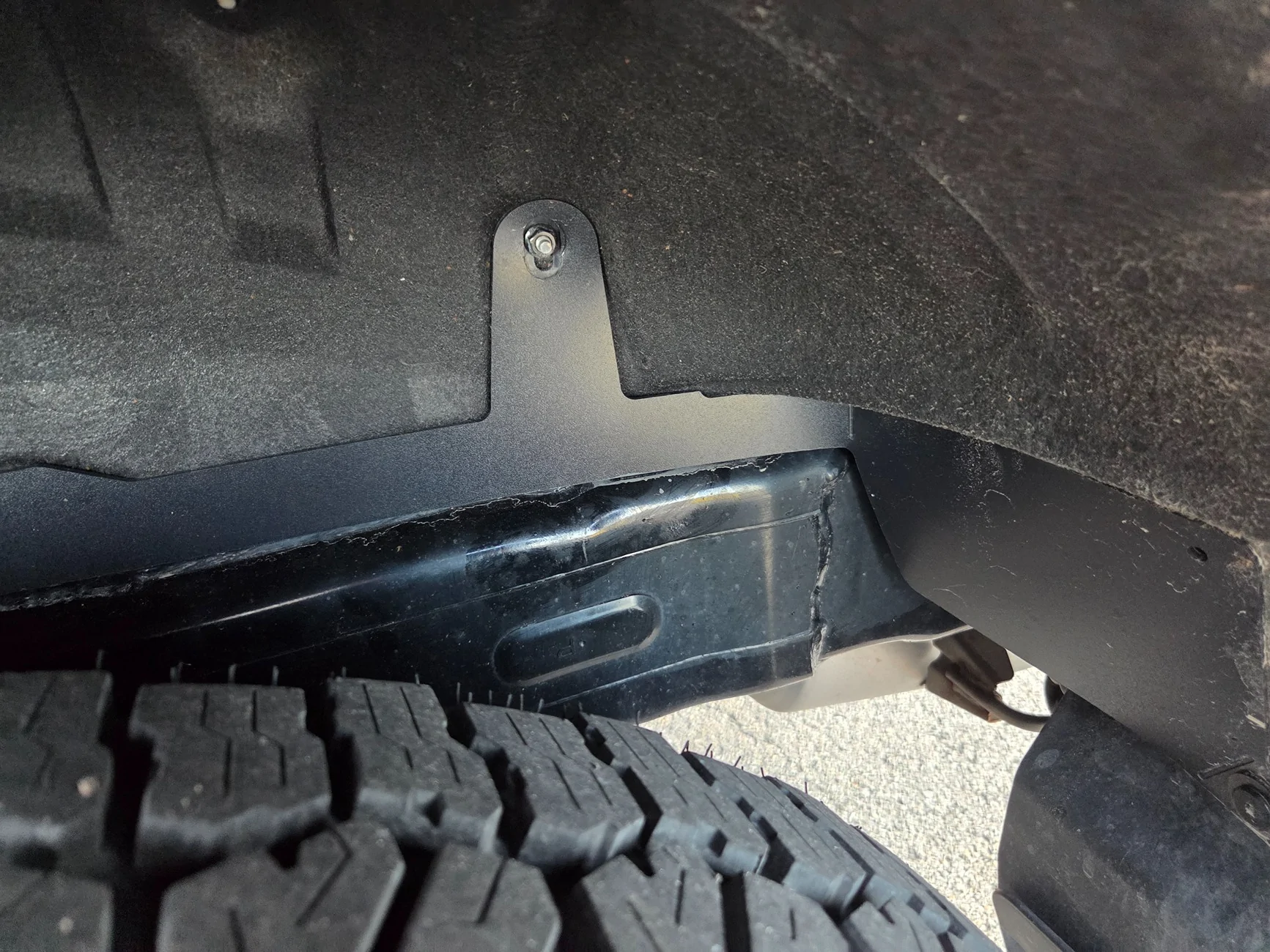

For you all that wanted to see pics of the ARK Splashguards. Here are front and rear. Nice fit and protection from all dirt and debris. Worth doing for sure.

That top left fastener is just looking like its wanting to find its way into your tire

Good catch I'll tighten it down. Always a hood idea to check and retighten. Thanks!

Those studs are factory and have plastic, finger tight nuts to hold the rear liners in. ARK supplies machine nuts to replace them and secure the guards. I missed tightening that one ugh. Thanks again and go Bills!!

I've heard others have. Easier with them off but doable. The big problem is lack of installation instructions. Best is to watch step by step YouTube video in shorts segments. Drilling a 5/16 hole in your rear liners is optional I did not do that. ARK supplies a bolt that holds it well without the additional fastener. If you do would be hard to access with the wheel on.

See left side of pic.

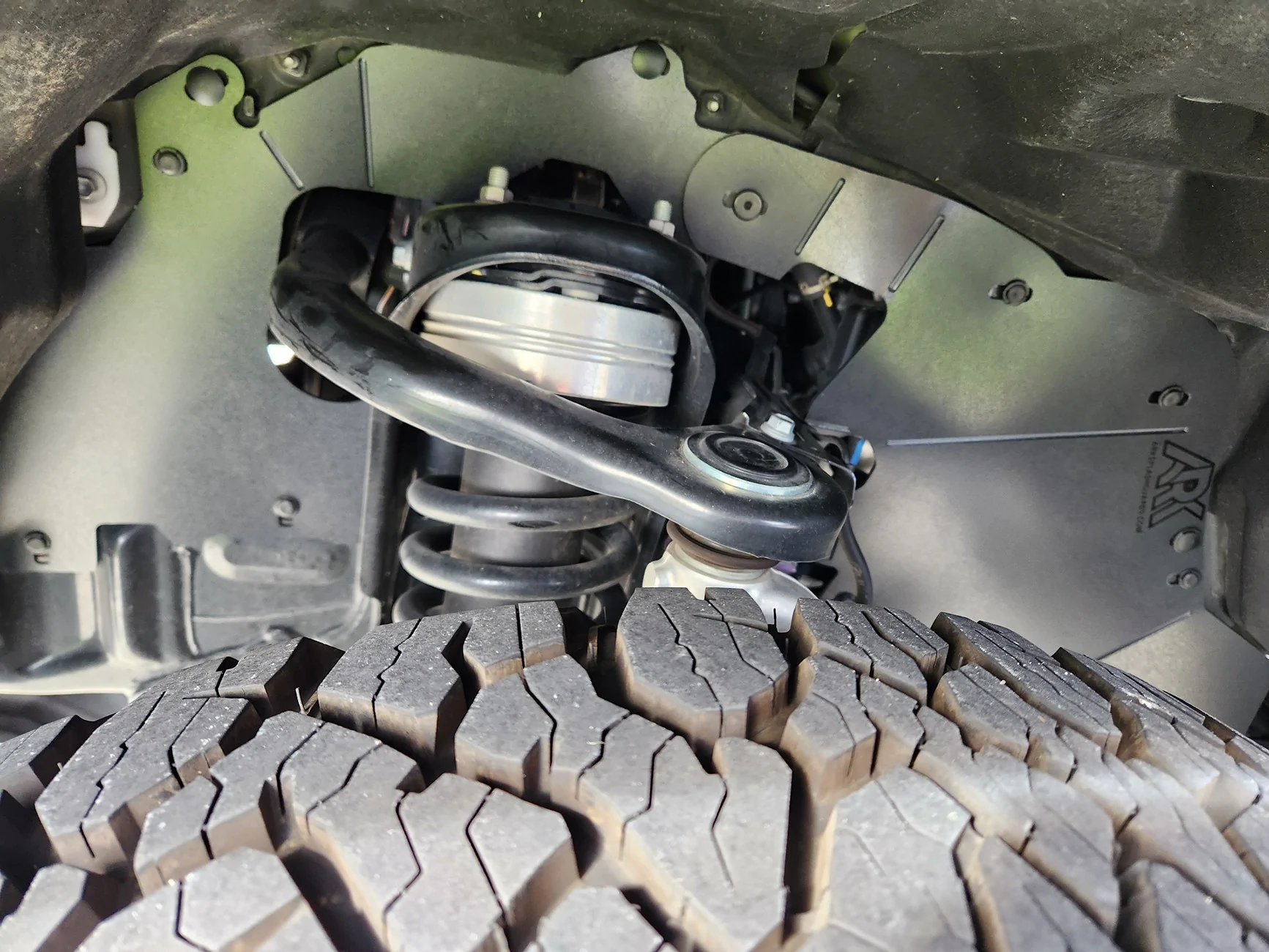

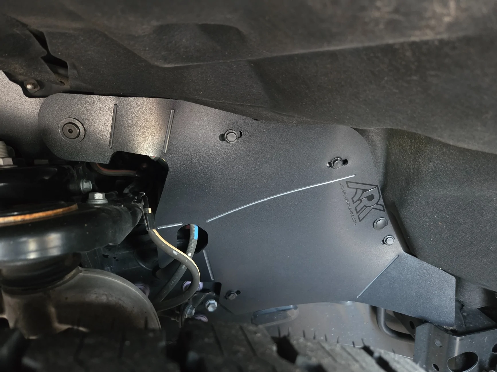

Installed all 4 corners without removing the wheels. Directions kinda suck but I figured it out.
