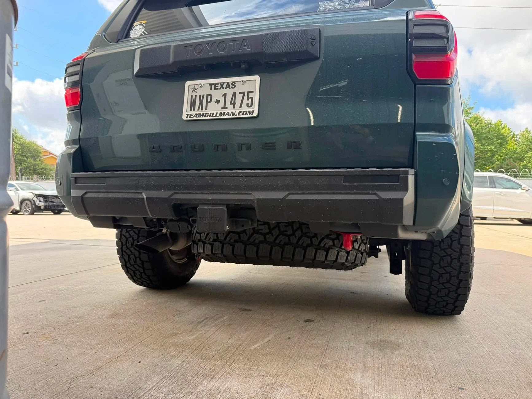

I recently put on 285/75r17 Toyo AT3s on my ORP, and want to get a spare that has the same diameter, but if I get a complete match, it will hang down very low and reduce departure angle and frankly looks like a full diaper. Also not going full rear bumper/swingout. Considering just removing the spare all together and keeping some slime/liquid patch in the truck but I don't love that especially if offroad.
(not my pic, found on FB. 285/75r17)
2025 2026 4runner 6th gen Anyone who has upsized tires running a skinnier spare? 740601941_27997150986543175_1362465826244915444_n
I am considering getting a 34X10.5R17 to keep the diameter, but reduce width. My OCD hates that it wont be a full match. But this is just... a dumb design choice by toyota to accommodate the useless 3rd row (or the hybrid battery) IMO.
Anyone else dealing with this dilemma? What did you go with?

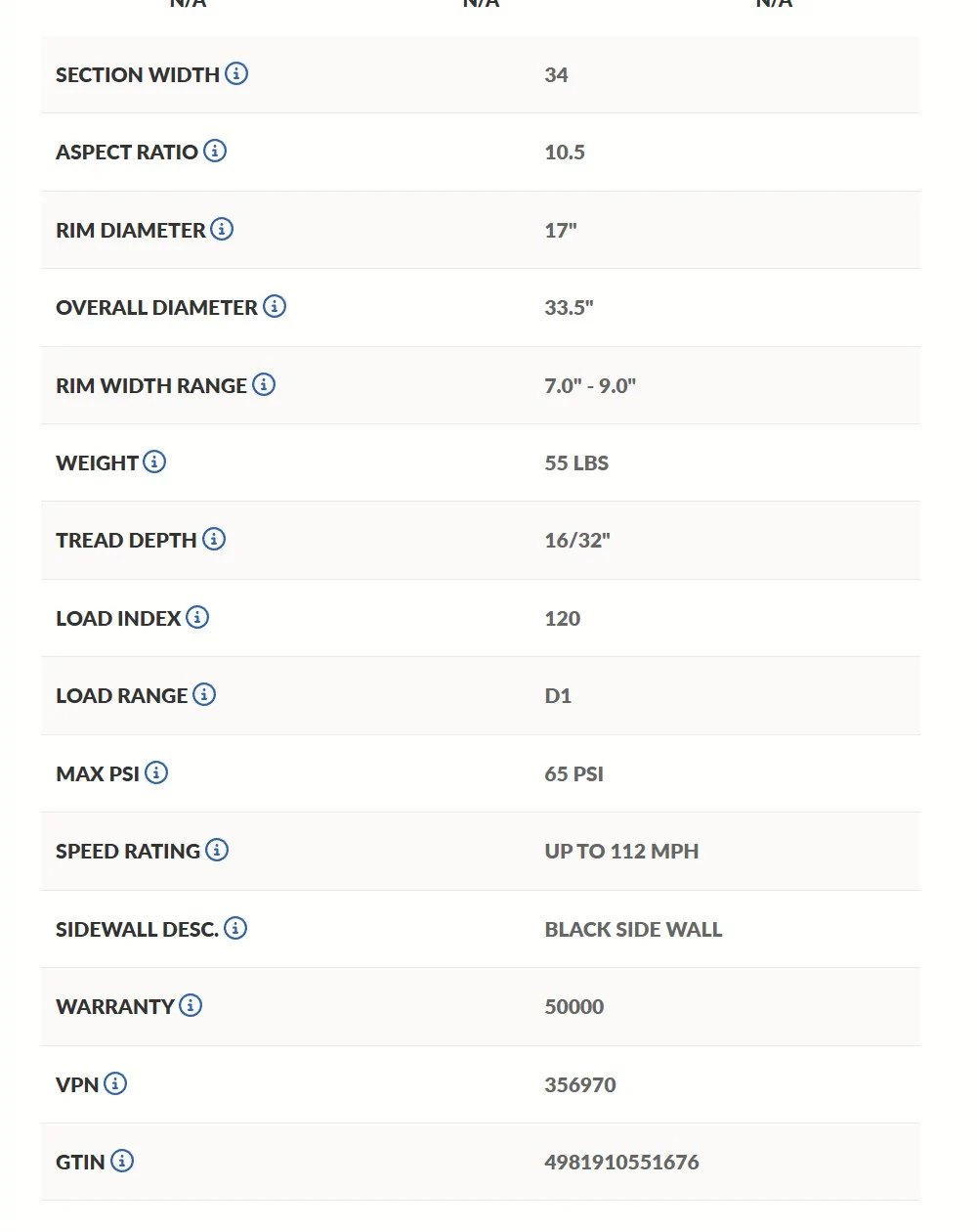

Ok I think I am going to run an AT3 in 34 X10.50R17 LT on a matching wheel. I would prefer a steelie to save some money and weight, but I can't find one that has a comparable offset. Only .3" wider than the stock spare, and .4" smaller diameter than my fullsize 285/75r17s.
