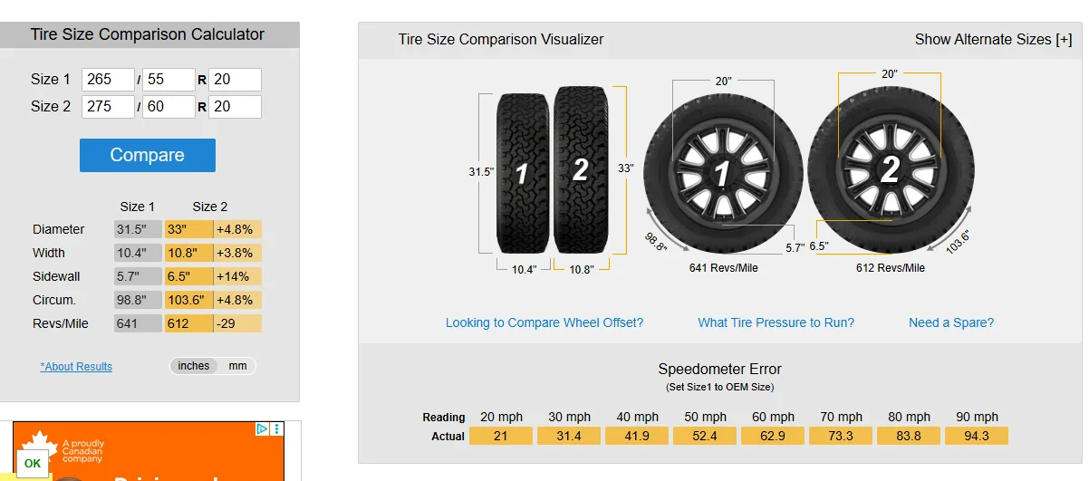

I'm trying to learn what the tire possibilities are on an unmodified 4Runner with 20" wheels. Has anyone tried the 275 60 R20? Any other suggestions that allow a full choke without modification?

Looks like it becomes 33" with that spec.
Wild quess is it should be fine without rubs
