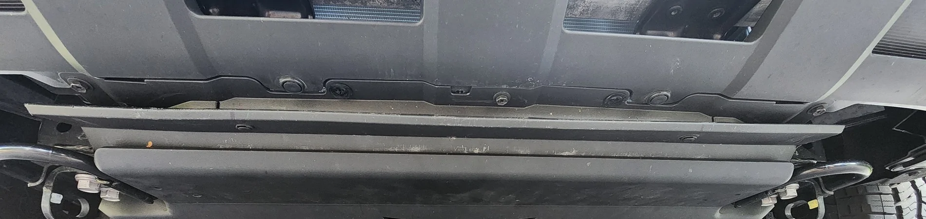

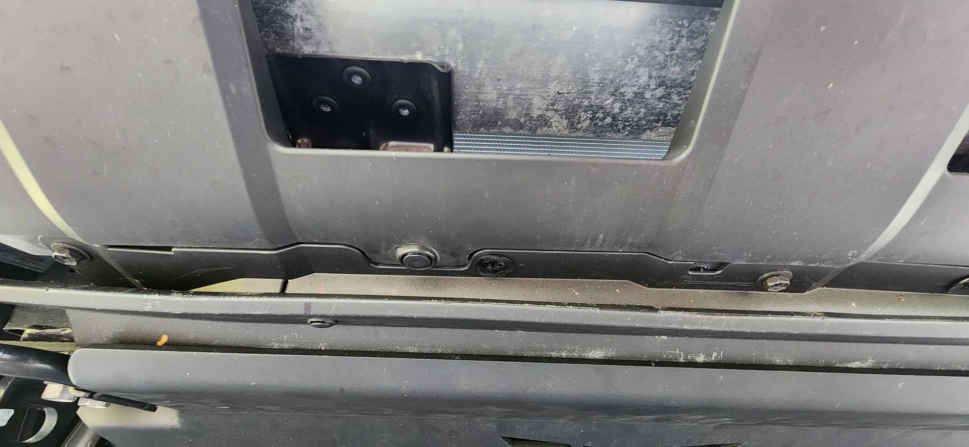

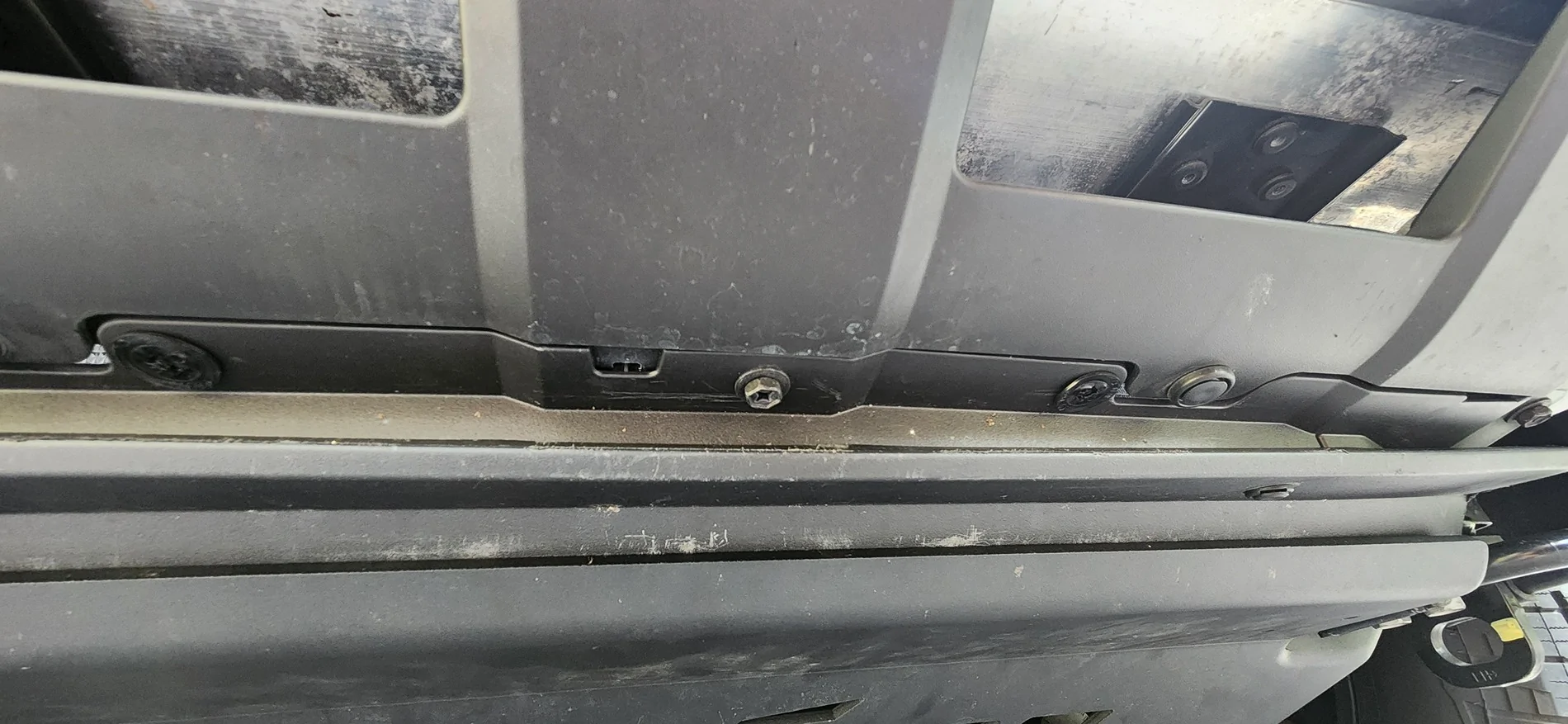

I used an oscillating multi tool to cut my air dam and fashion a gap filler. Used existing holes/screws from air dam mount. Drilled holes in the cut plastic and used plastic rivets leftover from recent splash guard install to secure two pieces together.
Just plastic but will deinitely keep out small debris, brush, pebbles, etc. from that gap exposing radiator and condensor.

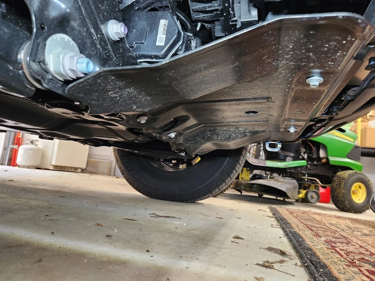

Interesting dilemma. I took the photo below after removing mine to go offroading and it sort of shows what I recalled - no obvious gap. But that is with the OEM plastic/fiber skid plate still intact (and I assume when I replace that with the Land Cruiser skid it will connect in the exact same place so still no gap). (And now I think I understand why aftermarket bumpers reference trimming the OEM skids.)

Can you post of picture of your gap filler? I just installed the Rival plates but am waiting on the engine plate from back order. I’m wondering if it’ll have a gap or not so I’d like to get some ideas.
