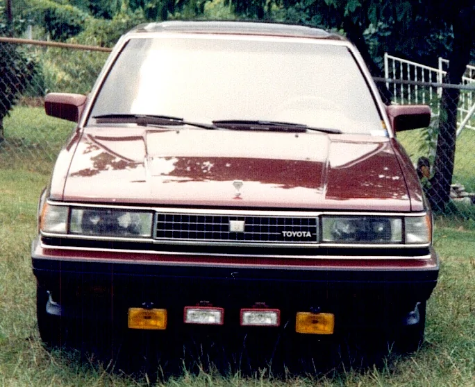

unless its pretty much plug and play (diode dynamics hitch light kit), i no longer install mods myself. its either the professionals or the oem installs it (if aftermarket) when i can.
too old and dont have the time to do things DIY anymore outside of basic stuff. plus i dont mod as much as i used to.
good example is my old 84 cressida when i traveled from GA to ND for my first base. (btw i got 1800 miles on $100 borrowed, $20 for a bucket of KFC and rest in gas and slept in rest stops, god gas was cheap in the 80s, $0.92c, and yes i barely made it, it came close to $80 in gas)
installed piaa fogs and driving lights for night time driving. did the wiring and mounting (angle iron for mount strip)
but yeah i dont do these types of projects anymore. too much can go wrong with everything being tied into canbus and what not and error checks causing codes to get thrown for even being out of voltage specs

Cool old Cressida. I bet that thing is still out there somewhere running.
