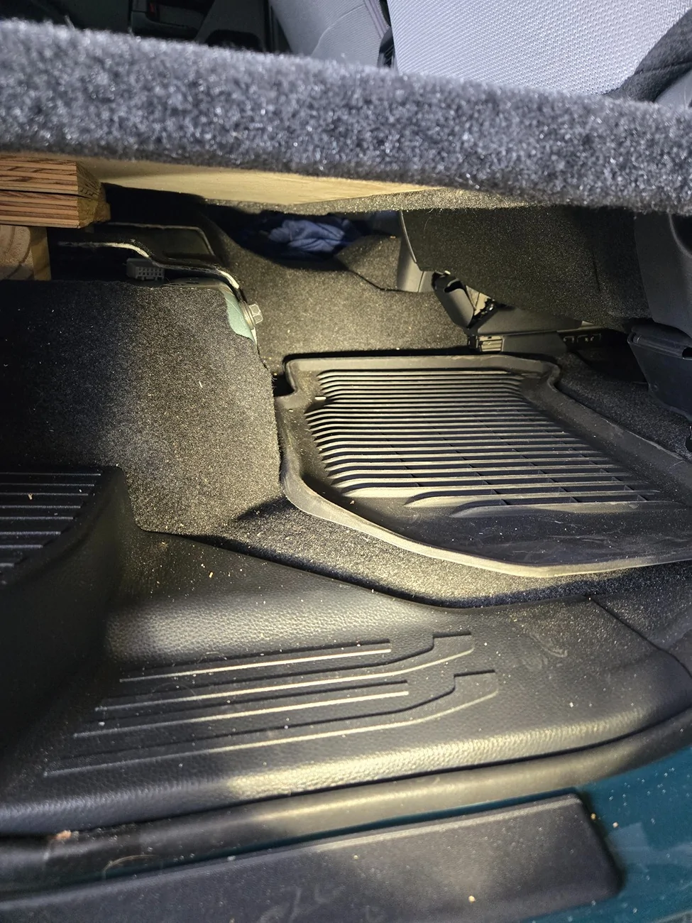

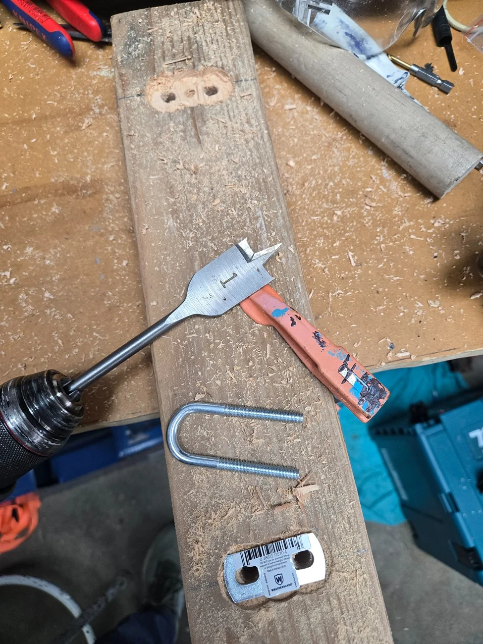

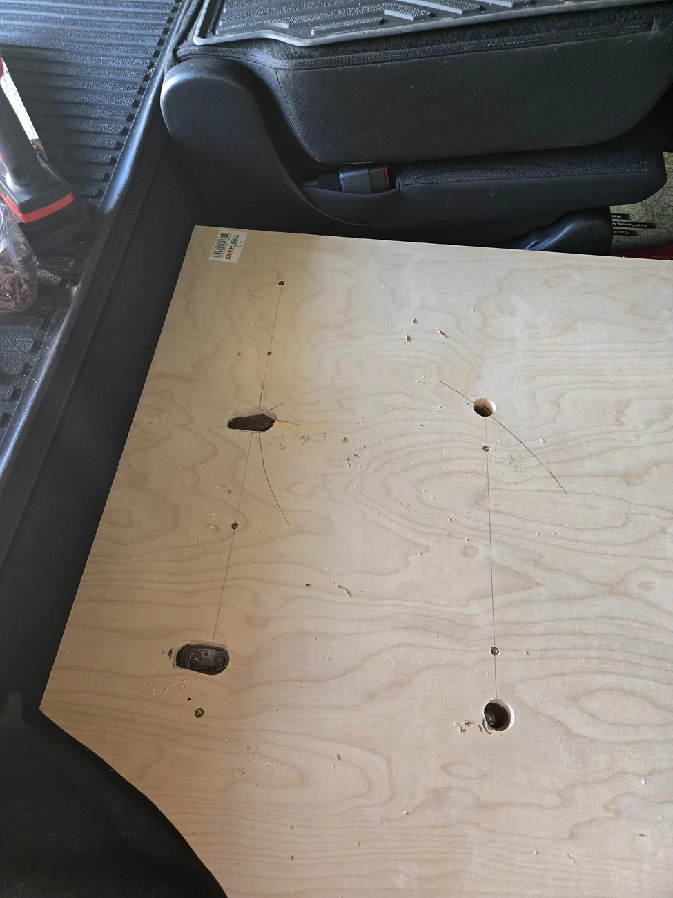

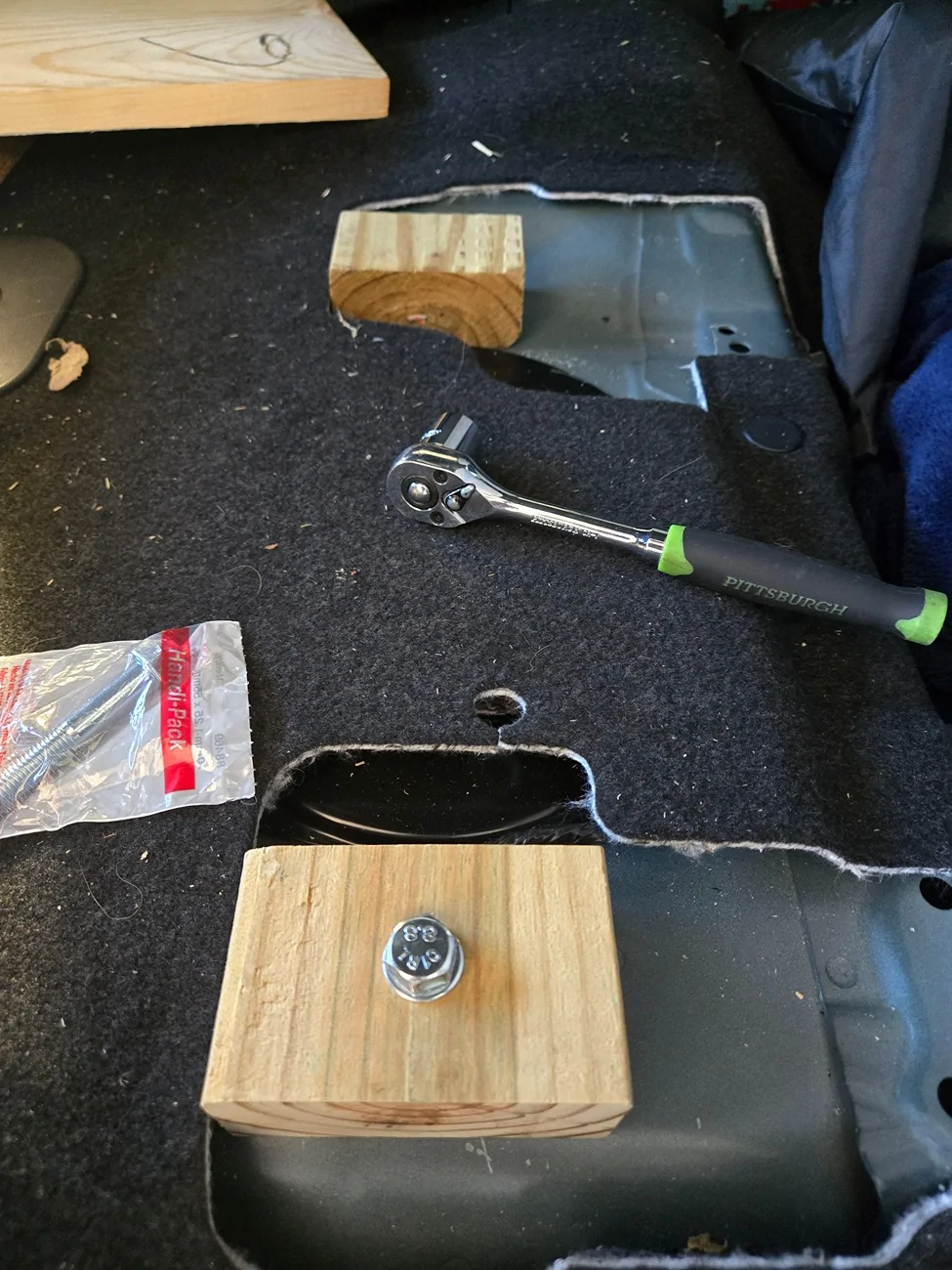

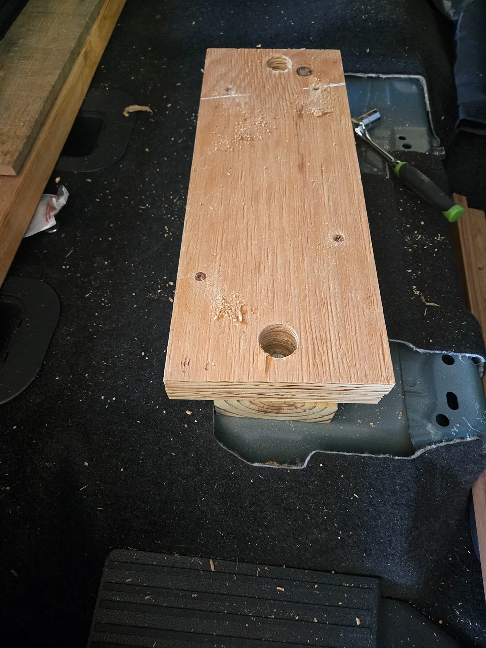

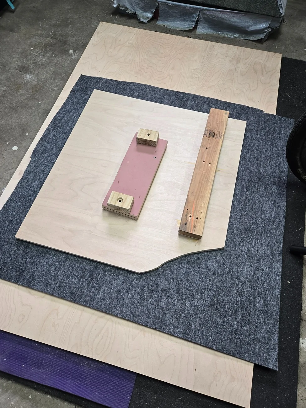

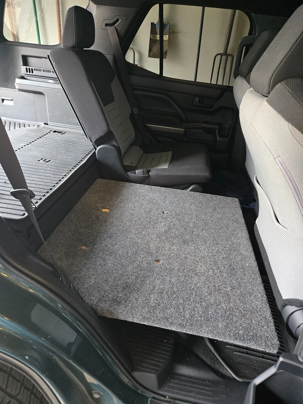

I dont ever use the rear seats so removed 60 percent side of second row and built a level platform. To make it level I lost some space underneath but it is a net gain of space.
I Thought about making it level with the rear cargo area but I kept it lower for now. Might make a second shelf to be level with rear platform at some point, but going to try this out. I Used longer 10m bolts and U- bolts to attach to brackets and holes where seat was mounted.

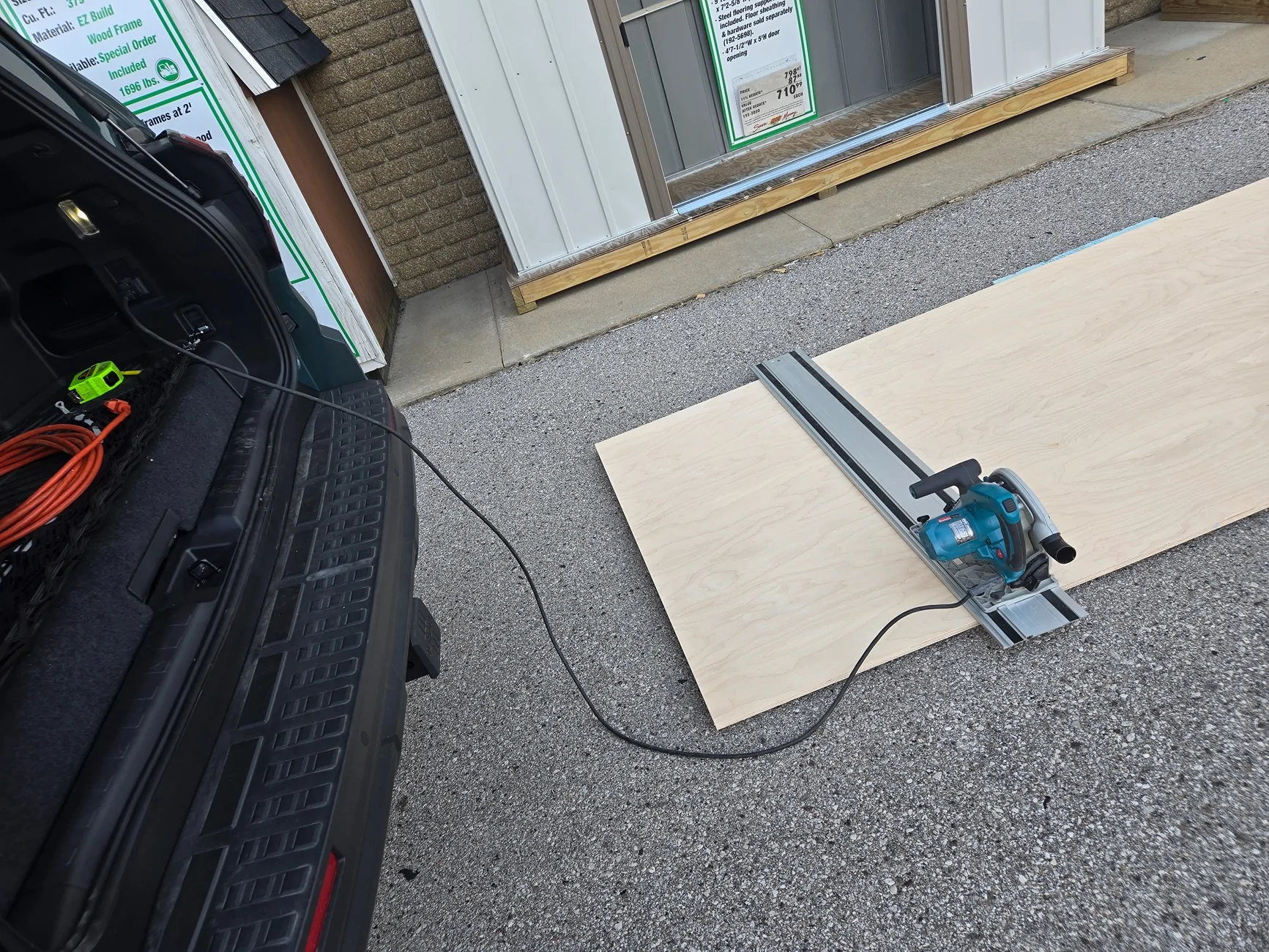

Cut the plywood to fit in the 4runner using the inverter on my 4runner :)

Nice. I would definitely make it level with the rear cargo area though.

Nice work! I've been thinking about doing this same thing, except on the smaller drive side seat.
Thanks. If you did the driver's side you wouldn't have to worry about the center hump and the platform could be a couple inches lower. I will probably do that eventually, I never have passengers.
It is nice having a lower load floor to access from the side door. I can look down into a cooler. Also when I slide my mountain bike in the back it fits a lot better than it did with the seat folded down. A seat probably weighed 70 lbs and platform weighs 20 lbs so I gained some payload as well haha.

No error lights after unplugging the seat. I have had the seat out for a while and I dont get any "check your rear seat" reminders or seat belt reminders for the missing seat

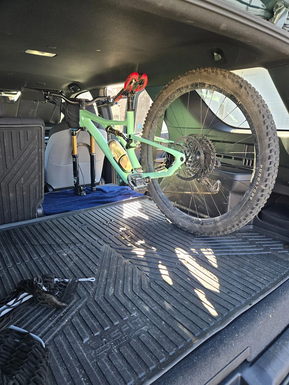

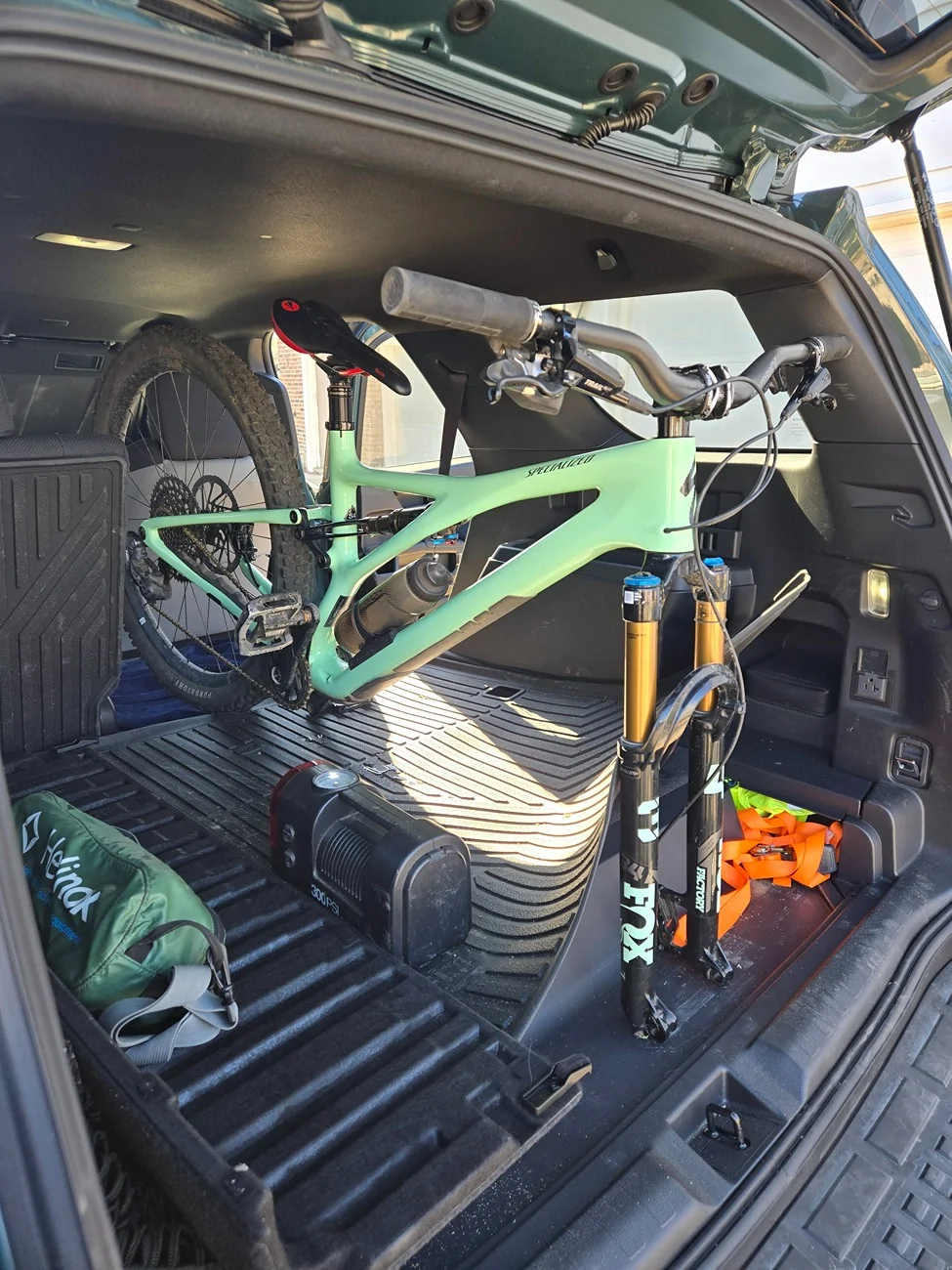

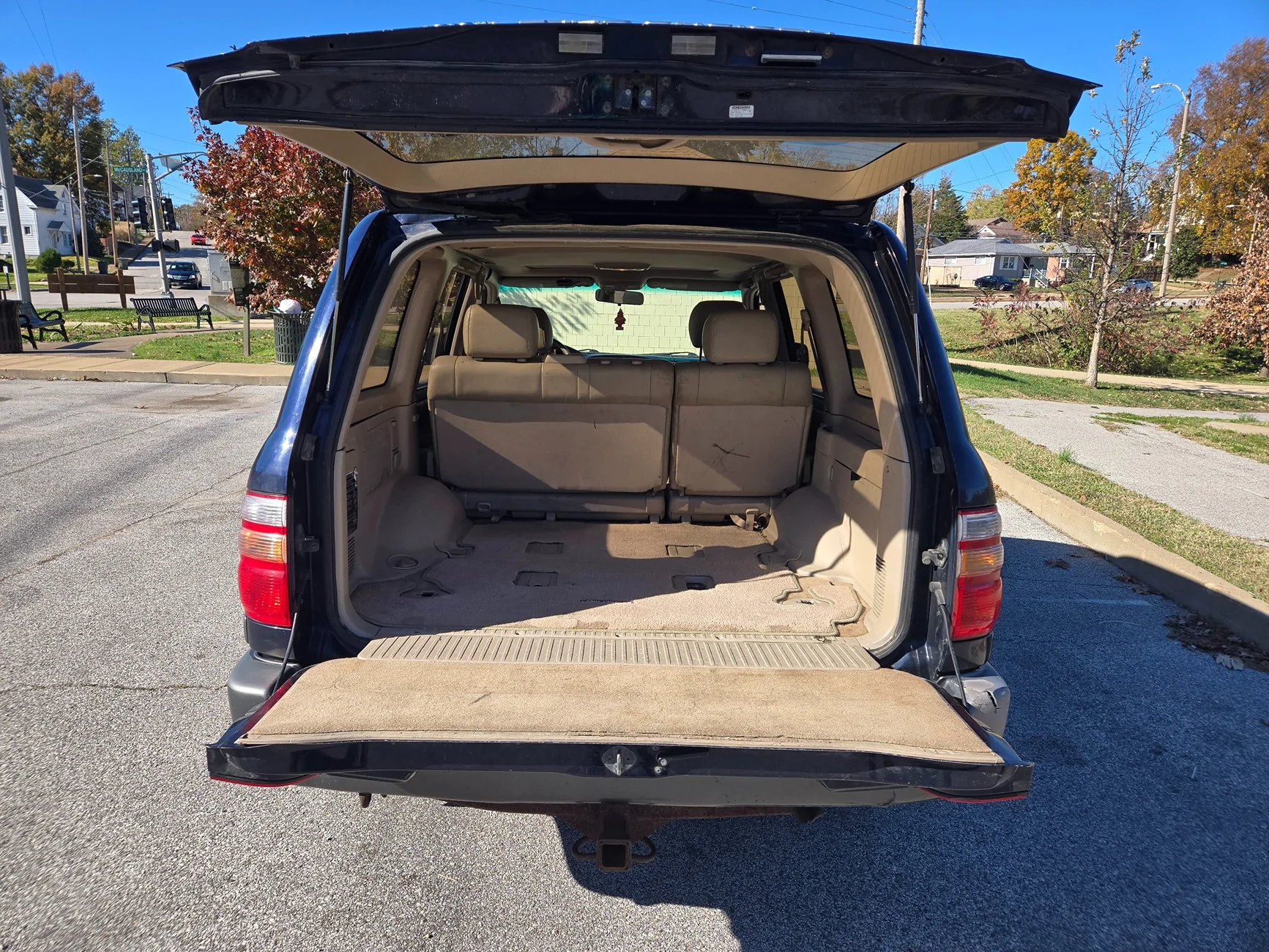

I had a 1999 100 series. all the cargo space... Here are a couple pics of bike. I have to tilt it over to get it through the opening but it actually fits best fork forward. Could probably fit 2 bikes if I removed other 2nd row seat.
