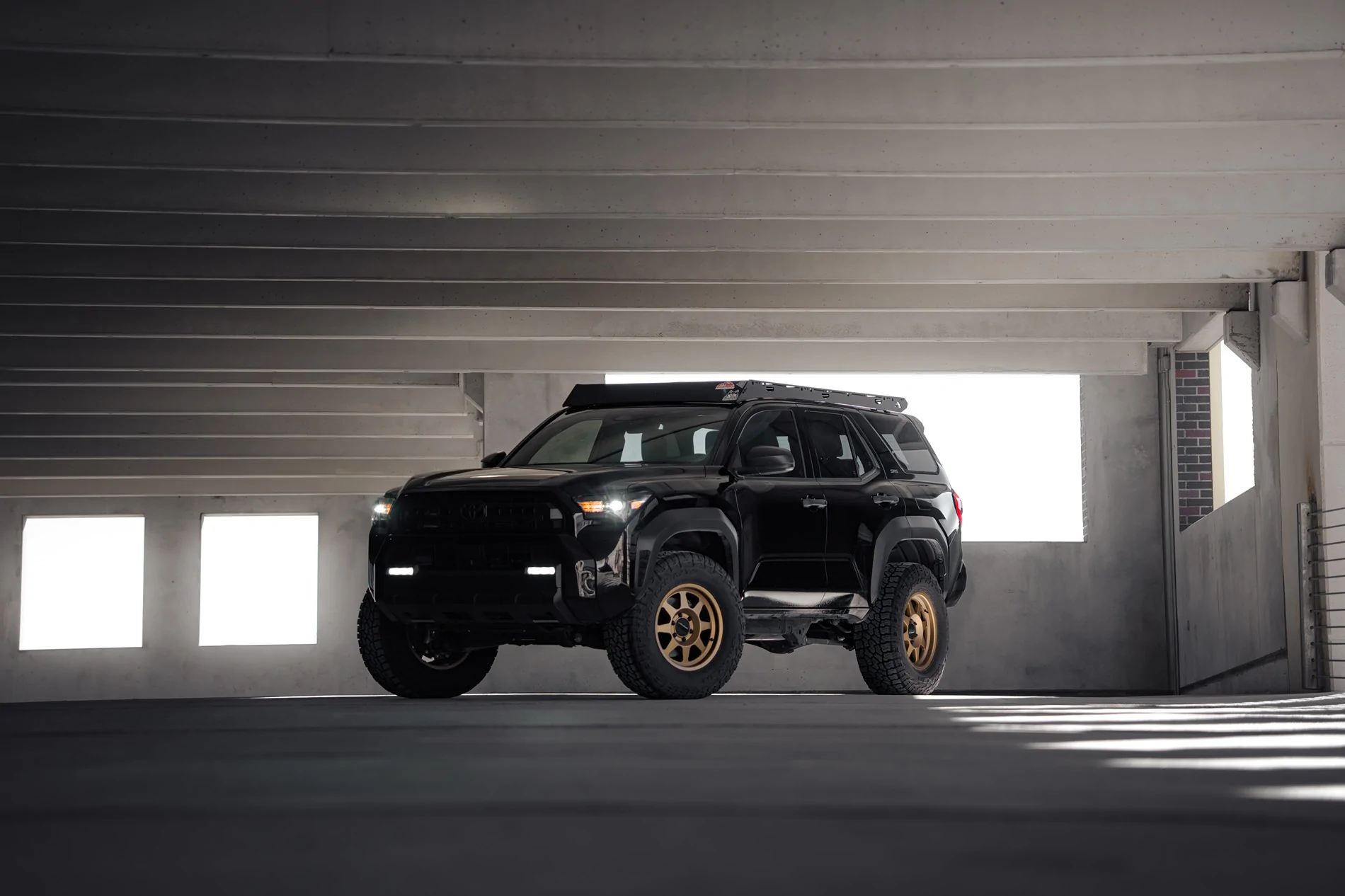

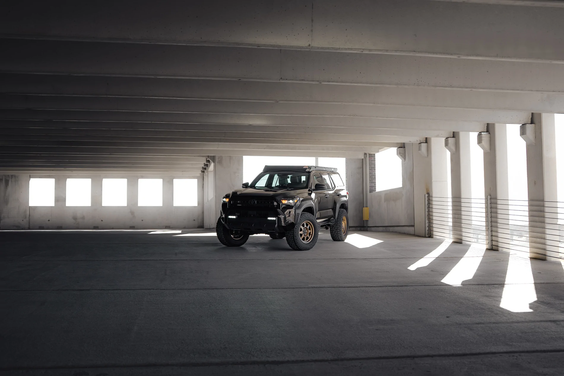

Awesome rig!
Tire size ?
How much lift ?
How does your ADO Fox Suspension compare to OEM ?

This is from a photo shoot we did for Fox. The wheels and tires aren't what I normally run, but they're Method wheels +18 offset with Falken Wildpeak 295/70r18. This setup rubbed on the mudflaps.
I normally run factory Toyota wheels with Kenda RT 33x10.5r17, but like the look of the Methods so much that I may change wheels out for them in the future.
The kit is 2" lift and rides far better than OEM. The OEM SR5 suspension was really, really not great.

Those wheels look awesome with black! (y)
With a 2" rear lift . . .
Were you able to achieve correct alignment with OEM UCA's ?
Did you adjust the rear Panhard (trac) bar ?

Correct alignment and no need to adjust the panhard
