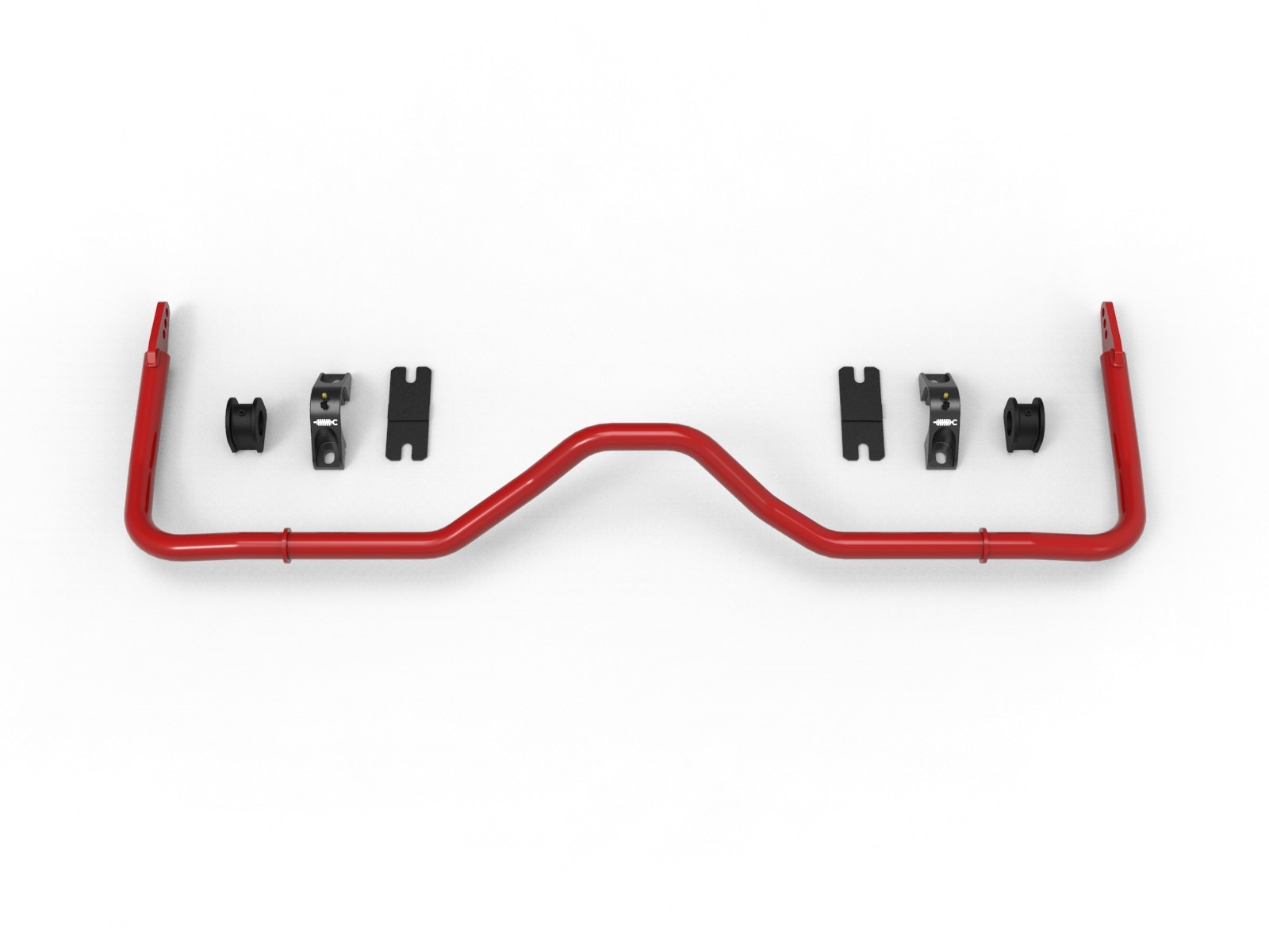

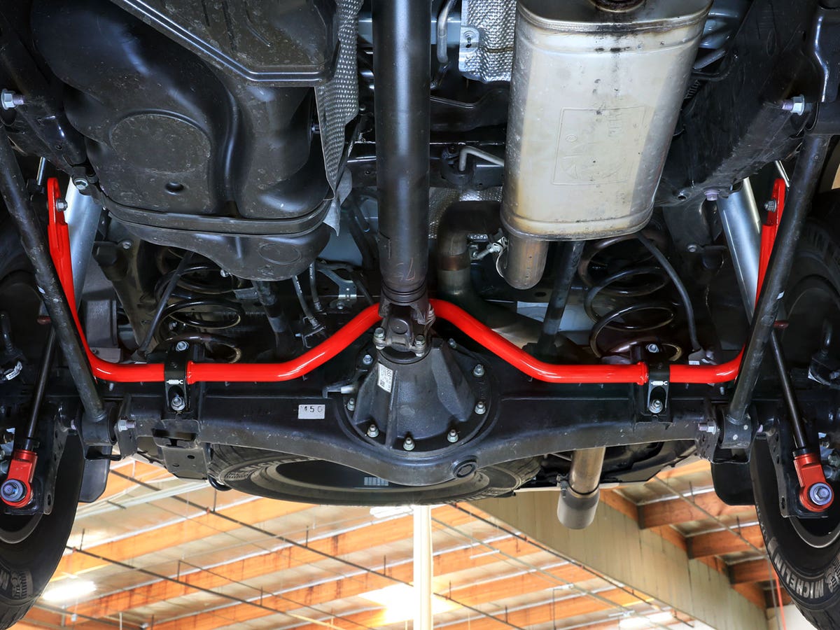

Seems like aFe has released a new rear sway bar for the 4Runner and Land Cruiser platforms. They're saying it gives a 370%+ increase in stiffness. Wondering how much difference it will make in daily driving and towing. Anyone plan on purchasing?
Priced at $525, and lets you choose between three different settings depending on how stiff you want it.

So, by way of update, I finally installed my rear roll bar this past weekend. For me, a huge improvement in handling...so much less understeer. My use case is not at all off roading, but daily and towing my racecar, so this makes complete sense for me and was so glad it became available. I know this kit doesn't make sense for most use cases of these trucks being taken off road.
I compared the two bars, factory and aFe. There's just so much of a difference. The bar I pulled off weighs 9lbs, the aFe 26lbs!...and brackets are double the weight at 2lbs as well. I feel like I am unsure what that flimsy OE thing was doing! And, the aFe has three adjustments; I am using the middle. I should also note that the softest setting is still much stiffer than the OE bar. The red accent in the lower wheel well is pretty nice too (but that's totally subjective, I know).
It is a quality piece, though too expensive IMO. It does what it is supposed to. I recommend it!

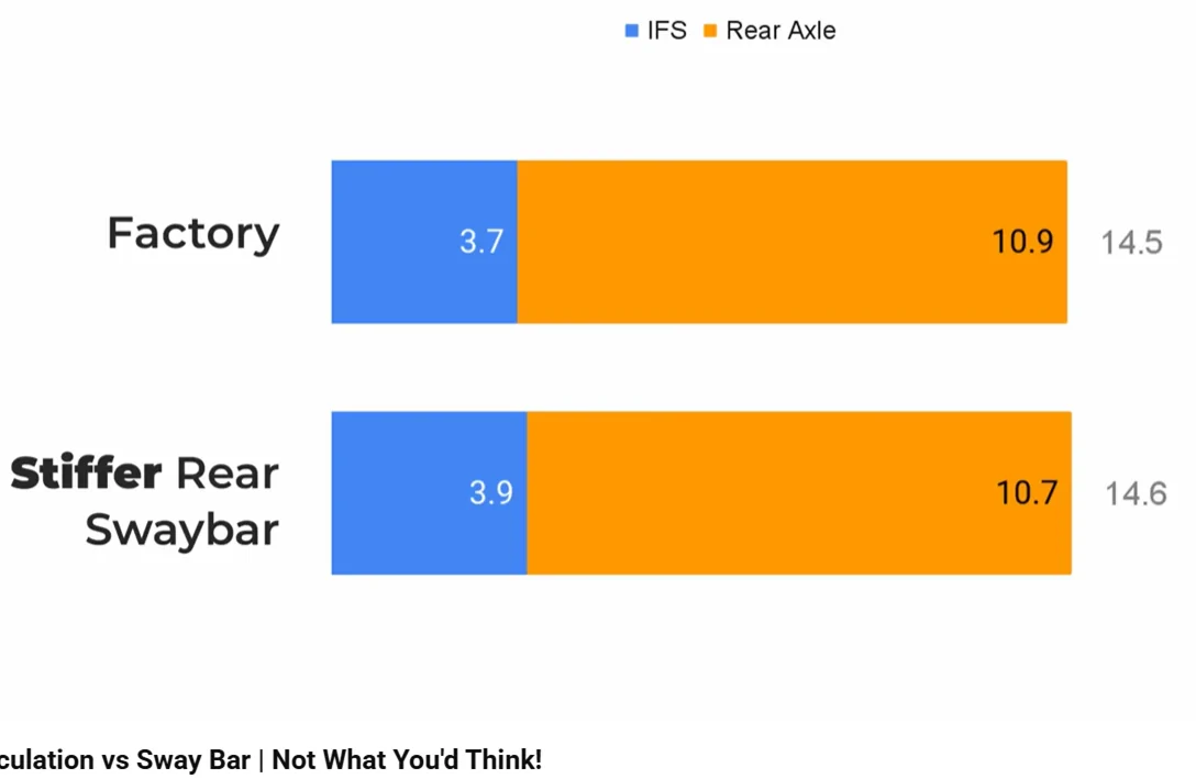

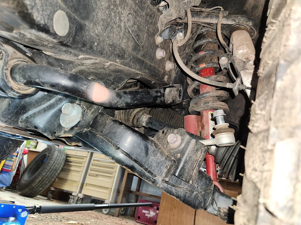

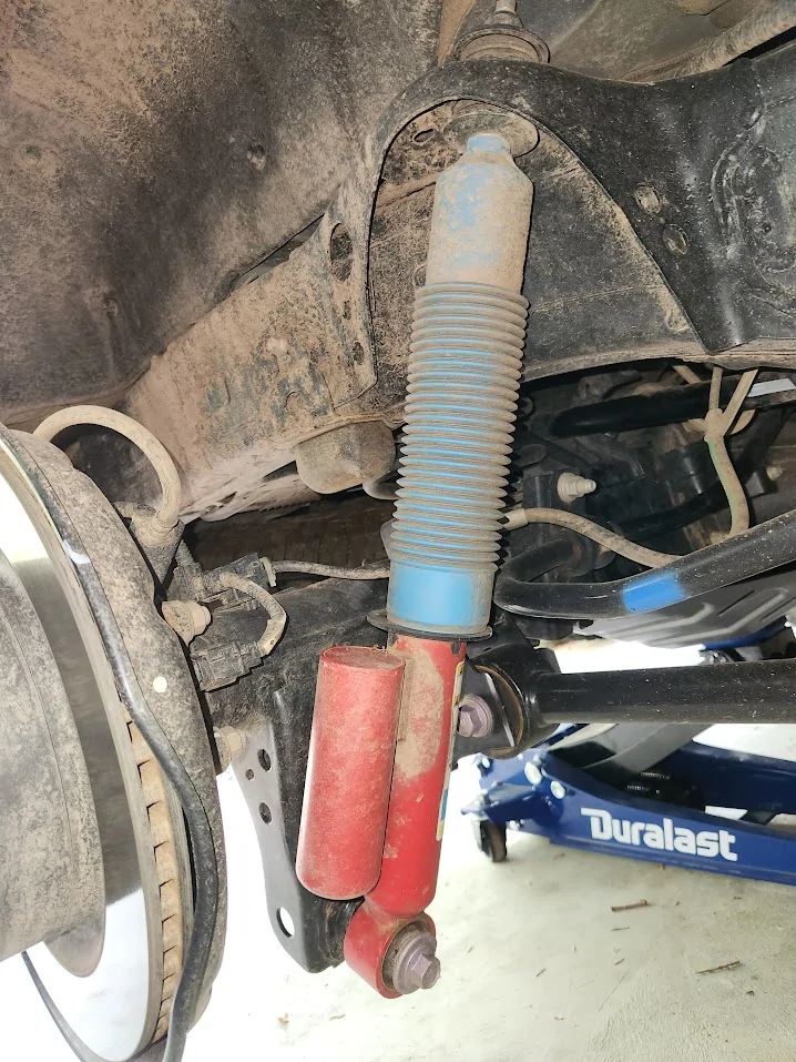

I will note that the rear sway bar on the TRD OR is puny compared to the front. The front is REALLY beefy: >>inch in diameter. The rear is not so much (<half diameter of front I believe). I think Tinkerer's adventure mentions that in this video Tinkerer's Adventure - Articulation vs. Sway Bar (but I am going by first hand examination (photos below). Video includes this graphic:
2025 2026 4runner 6th gen aFe CONTROL Rear Sway Bar released for 6th gen 4Runner Articulation vs Sway bar
So it seems a stiffer rear sway bar does not hinder articulation - in fact the opposite (a bit).
Front sway bar (disconnected) orange dot:

Rear sway bar (blue dot):
