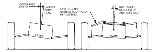

For an independent front suspension, you shouldn't consider removing the rear bar. You will lost road holding capabilities AND articulation
Ive seen that video but I am just talking about on road performance. I actually notice harshness on the road in broken uneven areas of pavement where the left and right wheels aren't moving together.
I have heard just removing the rear makes little difference to the handling of the car.

Pavement 'feel' was nominally changed. Hitting potholes or uneven pavement is little effect from the sway bars. Where you see the performance increase is in articulation and control arm movement at maximum and minimum shock lengths. Perfect example is; try jacking up one front wheel off the ground, then remove the sway bar end link on that side. (Depending upon the truck) the sway bar may be a limiter of travel that you could still get out of that wheel's suspension.
But there's always a trade off. In higher speed turning and maneuvering (with no front sway bar) you will 'feel' the body roll and the centrifugal forces exert much more on the truck (subtle feeling of it rolling over)
I'd never remove my front sway bar on a daily driver.
