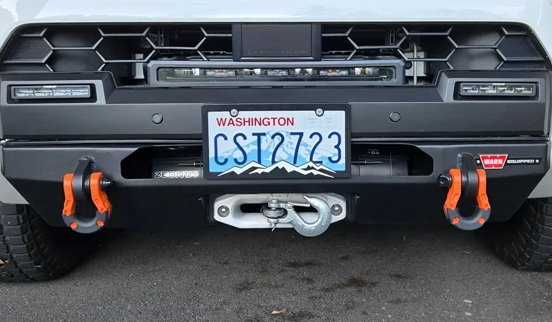

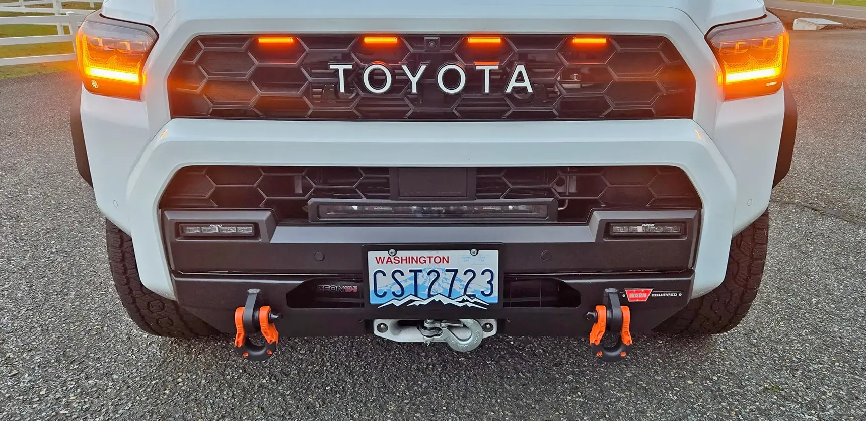

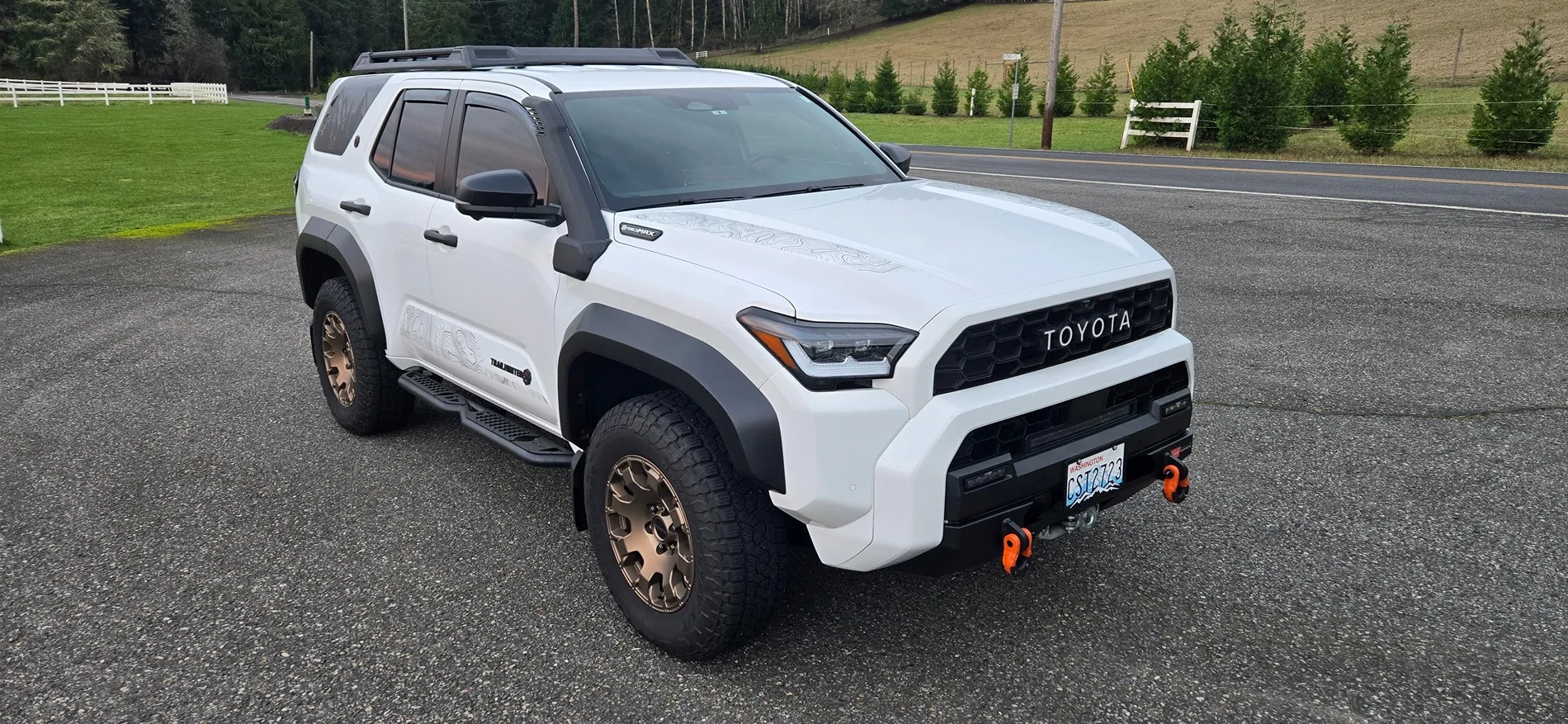

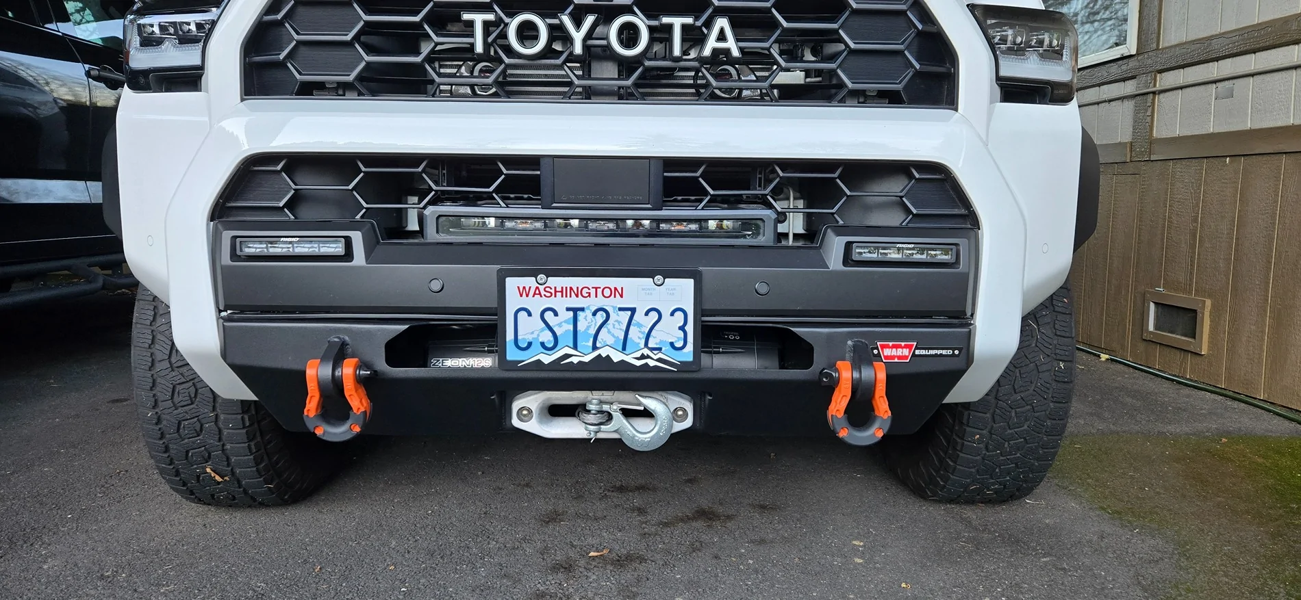

A huge shout out to the R&D crew at Warn Industries, they did a fantastic job on the new Semi-hidden winch mount for the new 25+ 4RUNNER!! It's a very clean look and the 12k Warn Winch is tucked away nicely! This kit is being released on Feb.2 to a shop near you!

Looks very good! I've got the Rago front bumper and it has the 20" light bar installed in it as well. There is a spot on the bottom of the Rago bumper to install a winch. My question how hard was it to access the clutch ontop of the winch? Did you have to squeeze your hands thru the small grill?

There is plenty of room thru the opening on each side of the license plate to access the winch. My stubby hands/fingers have no issues.. lol....

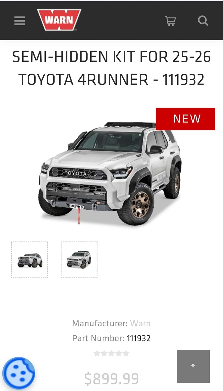

I have owned a few Warn winches and mounts. You stated this will be available Feb 2nd. Is this a Warn test bed and who performed the installation? What finish and materials? No information on their website yet. The best mount I have ever owned and still have is a Warn Transformer mount in stainless steel. Still no rust after 20 years.

Yes, this was Warn's "test" fitment and their R&D department did the install. It is all steal and is powder coated, very heavy duty! Warn definitely builds top notch products!!

This looks great! Are the front camera and radar still functional?

Yes they are, no issues what so ever...

By chance are there any weights of the bumper confirmed yet?
12k zeon i assume is what they installed?
This is the first winch / bumper set up i think k iv seen that works with a 12K winch without significant modifications to the truck or winch.

I don't have any confirmed weight yet, but will look into. Yes, it's a 12k Zeon synthetic winch. Fits nicely!!

I assume they had to run power leads from the battery in the rear hatch area? Can I get some pics of the underhood install?

Jon, yes they ran the cables to the main battery in the back. I'd be happy supply pictures, as requested when I return home.. Thanks..
