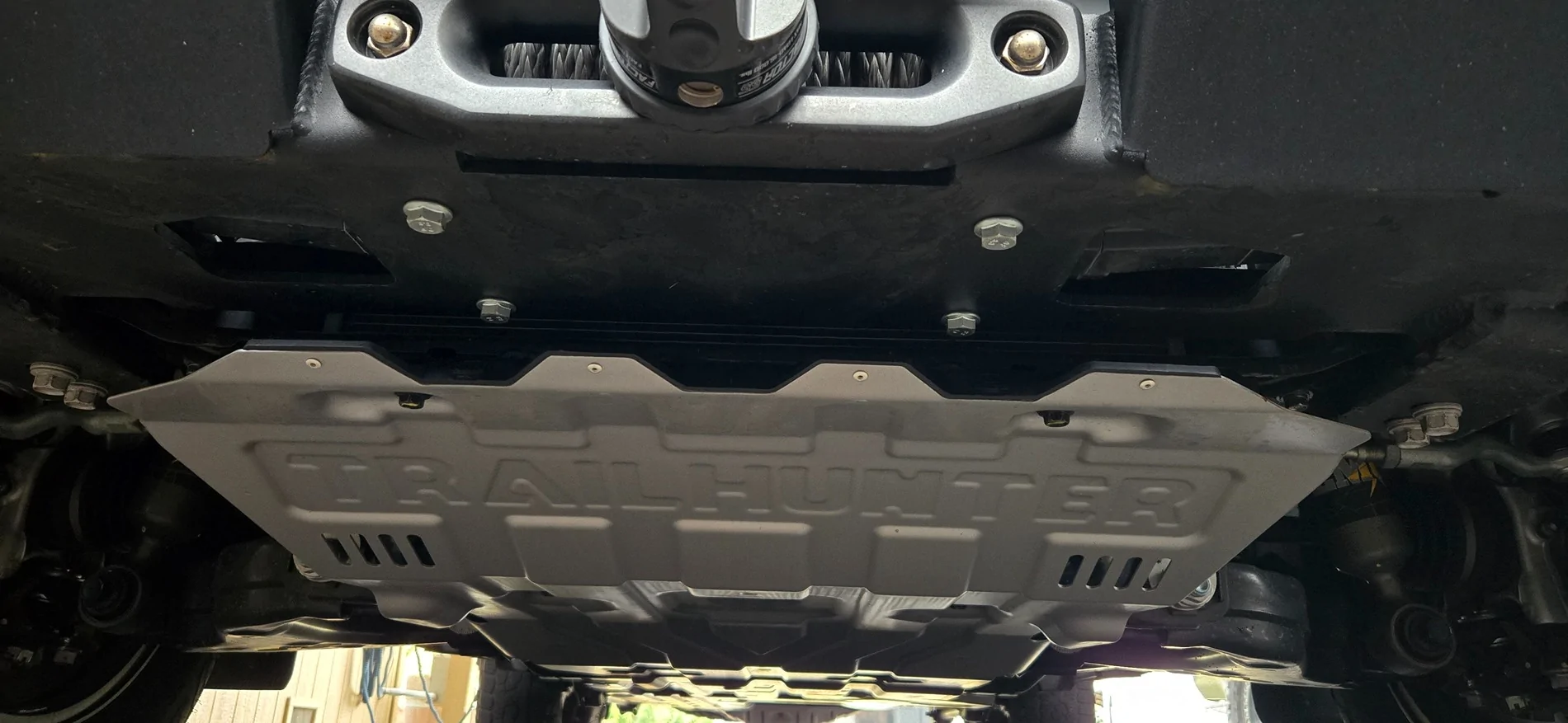

How did the mount work with the OEM skid plates or are you running another? I put the TRD aftermarket plate on mind and am wondering if that will work with the Warn mount.

I kept the OE skid plate and there was no issues with the installation...
I would presume the aftermarket one should work cause you are using the same mounting points..
Attached is a pic of my Trailhunter OE skid plate . Hope this helps..
